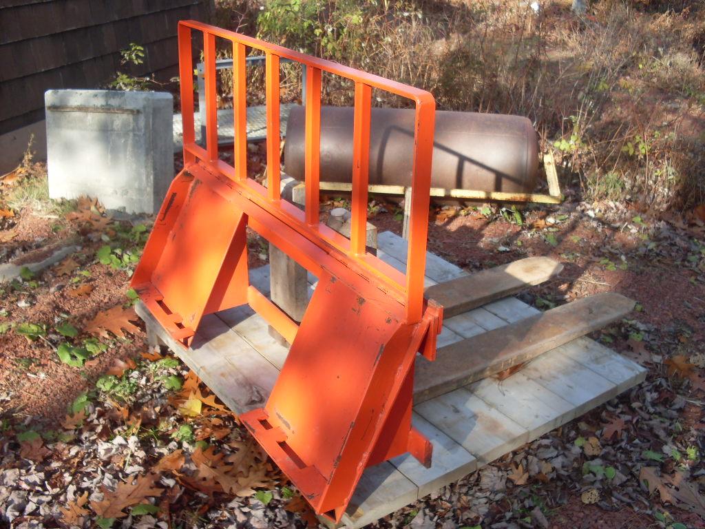

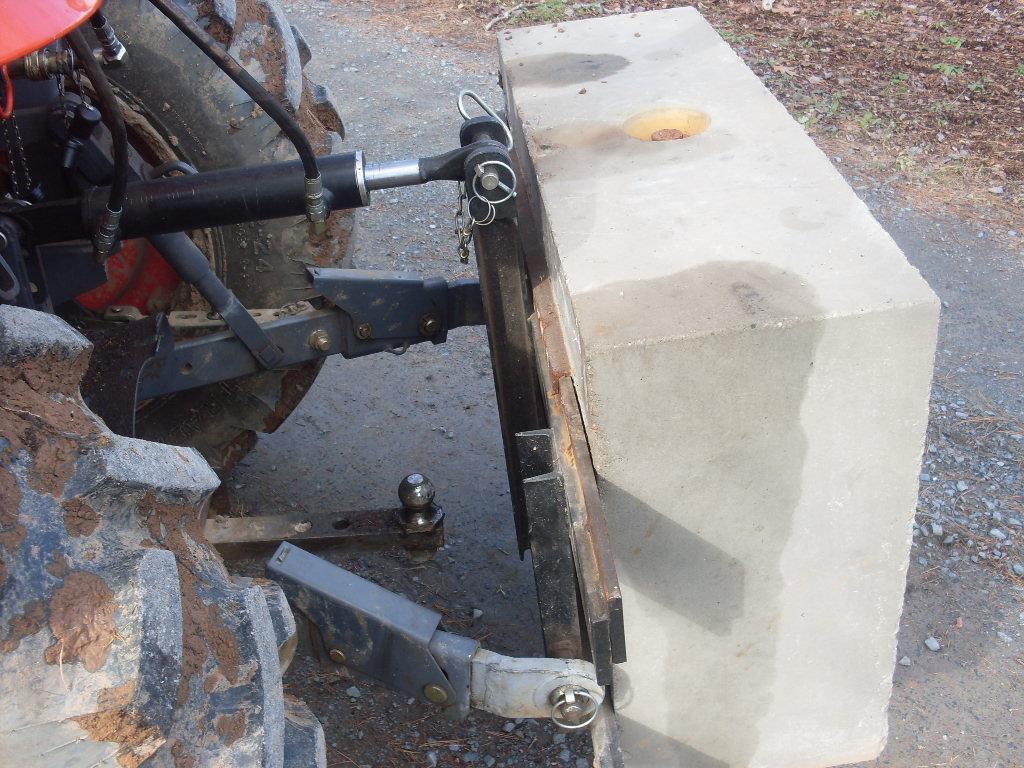

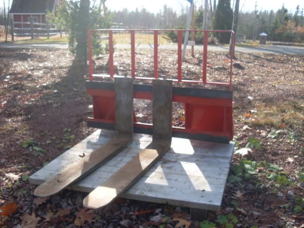

Here's some of my weight and forks. It can use the forks on the same frame front or back.
Steve

Did you pour the concrete around the mounting bolts on that one? Ken Sweet
Not sure what you mean Ken. The only thing poured into the concrete other than the lifting eye (center top) is a piece of 6" channel iron that protrudes out about 3/4". The lip on the frame work will except the forks or the weight. The weight weighs about 900lbs. I don't have any other pictures to show the weight off the frame. My wife has the camera at our grand daughters birthday party or I'd run out and get you a photo or two, maybe later if you still want to see them separated.

In the picture, Seems like I am seeing 2 protruding bolts from the metal running across the concrete block. I just assumed they were part of what held on that plate to the concrete block. Ken Sweet

Ken
Look close at the top rail . You can just see the edge of the channel hooked over the 3 point frame. Neat way of doing it. Sort of a custom QA.
