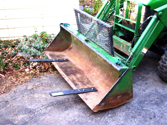

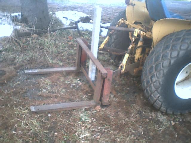

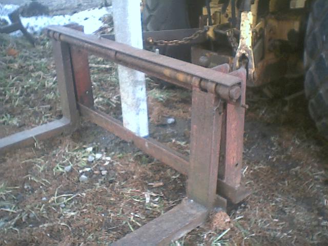

I made a cheap set of carry all type forks. They can mount onto my bucket or rear 3 pt.
For the bucket, they just sit in the bucket. The top has a set of tabs that fit just over the outside of my 2" center mount hitch that is welded to the bucket top. A large pin slides through to hold it.
Mine are 4" x 1-1/2" channel welded to 2-1/2" x 1-1/2" rectangle steel and some 1/4" flat steel for bracing. These forks will hold more than my bucket can lift.

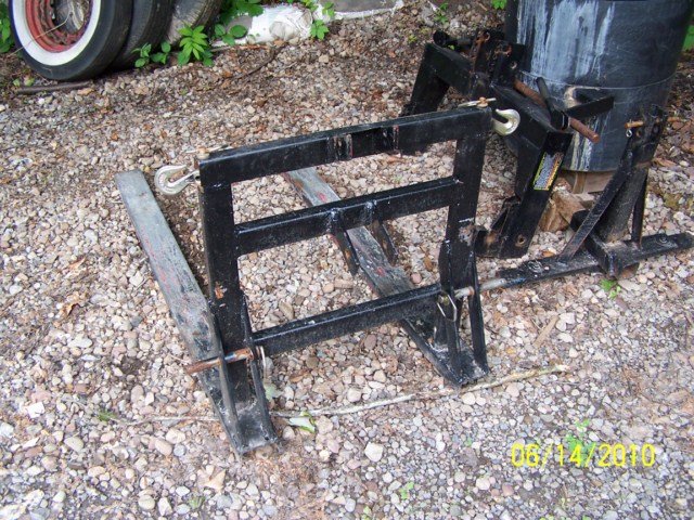

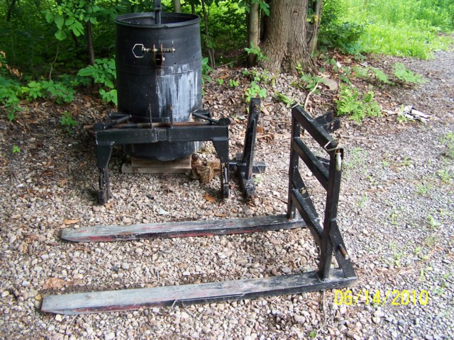

I have exactly what your talking about and it's factory made, on a light duty ARK loader that I adapted to my old Allis chalmers B. The forks look very similar to the ones George2615 built in the picture above. It just has angle irons on the back side of the frame that the lift arms and cylinders fit between, then you put the pins from the bucket in and your in business. It takes me longer getting on and off the tractor than it does to change bucket/forks, that's mostly because the forks and bucket are light enough to move into position by hand. I recently adapted the forks to use on the 3 pt hitch of my Cub Lo Boy, by bolting a channel iron in the center, to attach the top link. If interested I can post a photo

Some easily built forks.:D

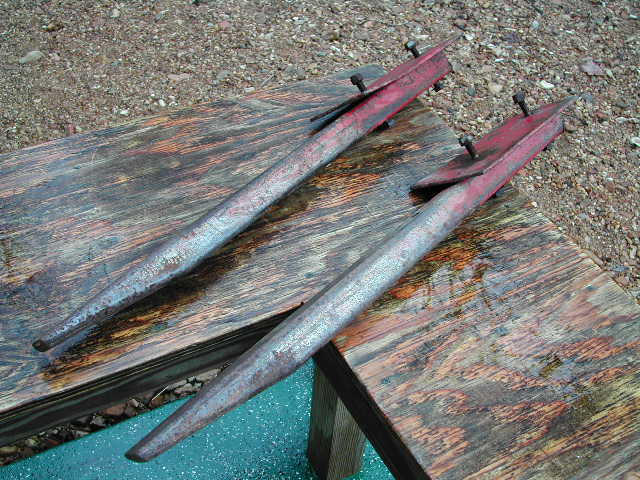

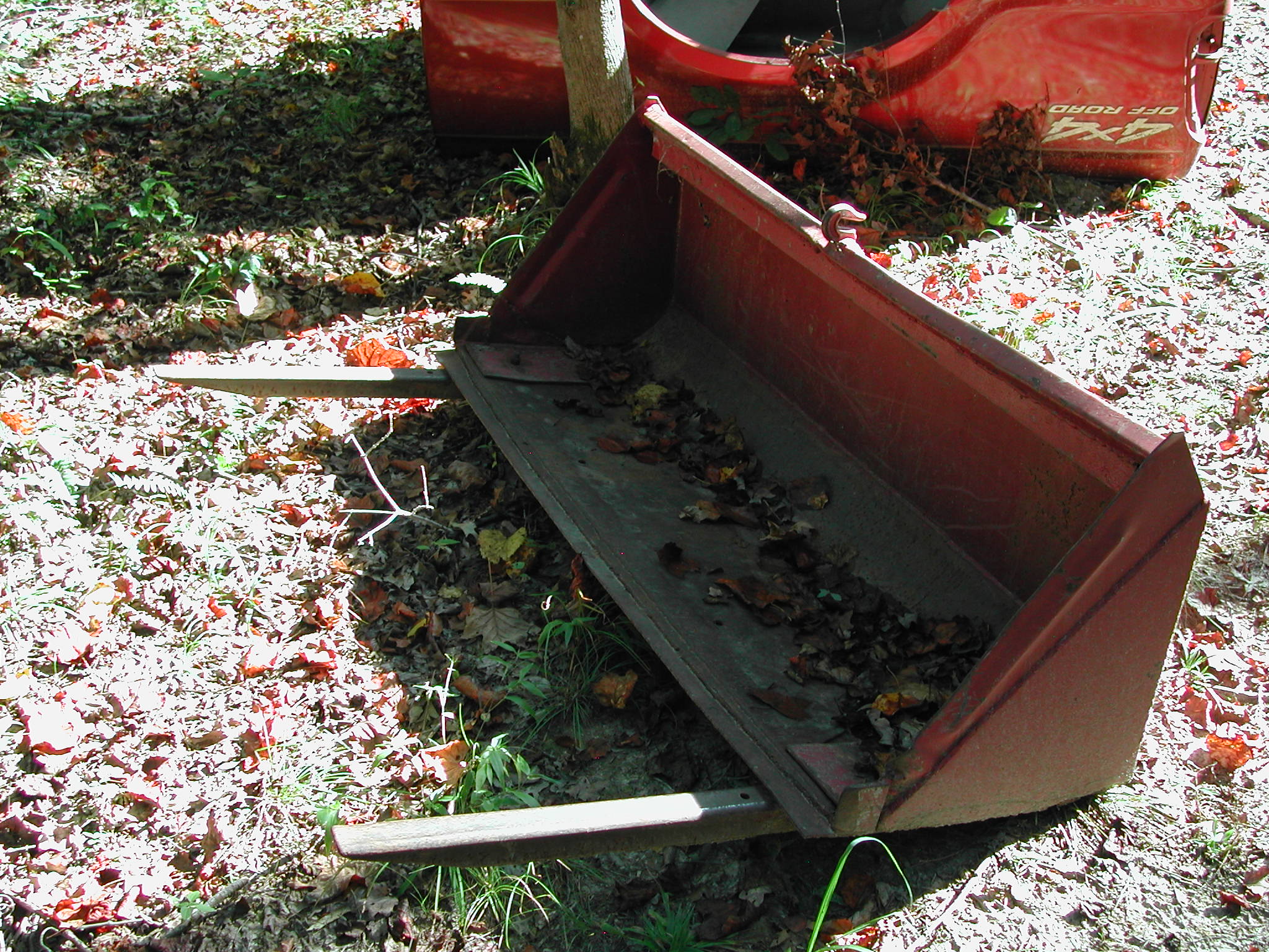

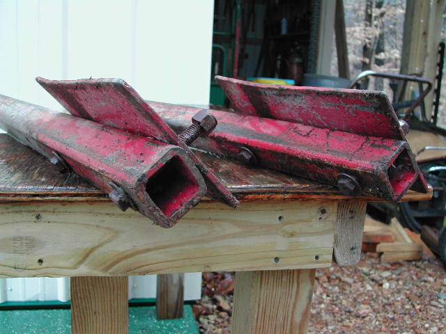

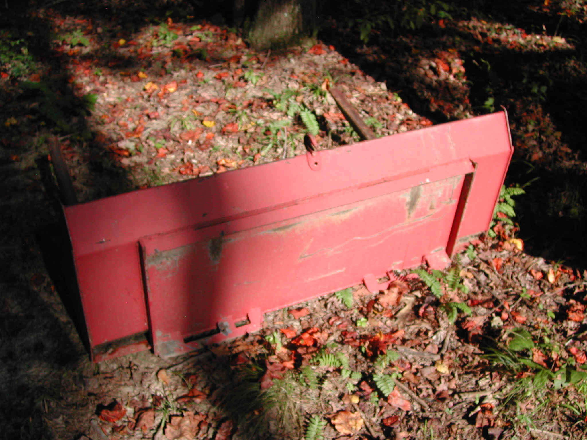

This was my original 5' pinned-on bucket that came with my tractor. I made a set of 4 of these forks and drilled the bucket to attach any or all of them. They have lifted unbelievably well for me, just have to get used to them. After I bought the QA adapter and new 6' bucket for my tractor 5 years ago I cut the ears off this bucket and welded the QA plate on back. Now I leave a set of forks mounted on it ready to use.
The forks are made from receiver tubing so they can cost you a little but they have never come close to bending and I've lifted the rear of the tractor off the ground with them many, many times. I simply cut the ends tapered and welded flat steel and then dressed it all up with a grinder. What's nice too is that you can use the forks with taper up or down and you can mount the forks under the bucket or inside it, whatever works for you. The flat plates I use for back-up in the bucket are just plain 3/16 flat steel. The bolts are 3/4" with nyloc nuts so they don't vibrate loose. It takes a couple minutes to install a pair with a ratchet & wrench but is simple and now that I don't use that bucket for anything else it's ready whenever. I've used all 4 at once to pick up loose debris for loading. Most things I do just take the two forks mounted in the outboard holes. On some smaller pallets I have to use the inner holes in the bucket. I also have 2 sets of holes in the forks themselves to shorten or lengthen them when mounting.

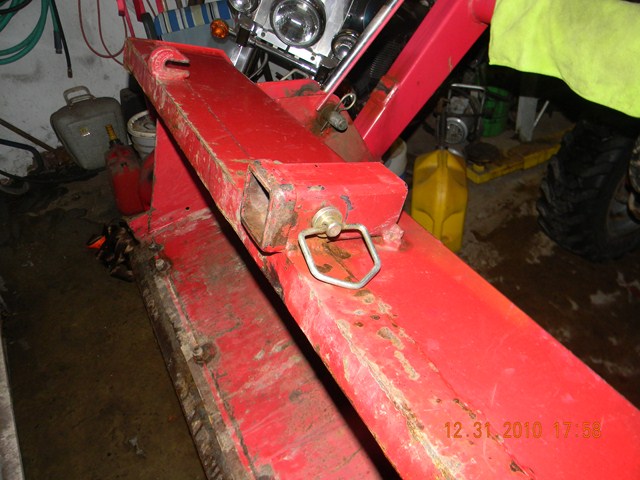

Moving palletized firewood is exactly what mine is used for and you can't get much more uneven than my place, which drops 3-400 ft in my 25 acres. My name Smiley, is taken from our old business name, Smiley mountain Cycle Sales as I live on Smiley hill and it got it's name for a reason.
I just wrap the loads with a cardboard washing machine box and binder strap and take it easy. No problem.
Here's some pics of mine.
