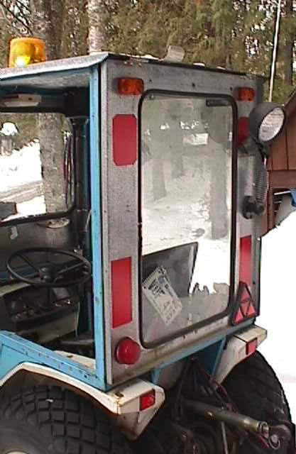

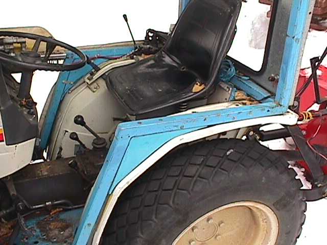

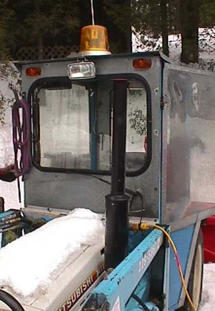

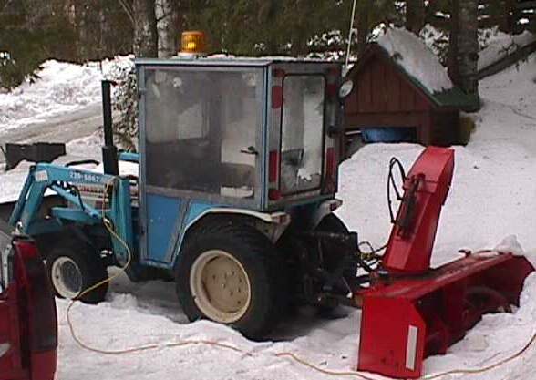

I made a cab for my MT180-D about 9-10 years back.
I made a pair of frames using 1.5" x 1.5" sq tubing and then welded cross bars to form the width of the cab.
I then had sheared some 16g. galvanized stock to form the roof and had flanged formed to create gutters on both sides and made the top 6" longer than the frame to create 'eaves' front and back.
For the front and back I again hat sheet stock cut and formed.
The top and ends were simply attached to the tubing frame with self tapping metal screws.
Foe front and back windshields I went to scrap yard and purchased (real cheap) school bus windows c/w the rubber seals and simply traced out the glass and cut out the hole to accept the windows and seals.
This was accomplished with a jigsaw and fine tooth metal blade.
For my heater I got from the same scrap yard an 'under the seat' school bus heater core (about 6" x 6" x 2" thick) and converted the blower over to a computer 12 volt 'muffin fan'.
This I did as the origional fan moter was fairly large and inefficient as well drew high amps vs the puter fan is extreemly efficient and uses a mere 1 amp or less.
The side pannels are merely thick clear plastic as used for awnings and attached with 1/2 dowels and metal screws.
Works great, minimal cost to build and hot enough to blow snow in coldest days with minimal outerwear.
Trial and error proved that the heater, blowing downwards, and located high over the hydraulic controls was the best location, keeps feet warm, not to hot in face and can be deflected towards front w/s.
Also the floor area was the hardest to seal off due to hoses, pedals etc etc hence the place that needed it the most and since heat rises there is plenty for the balance of the cab.
Actually after about 10 mins I either remouve my jacket or shut off the fan.

/ Anyone built a tractor cab? #17
ADDENDUM:
The school bus heater is available new and is made by CARTER and should be in the local autoparts CARTER catalog.
I have since seen it listd.
Also you will note that on my ceiling I sandwiched a quilted insulation material before screwing on the roof.
This I did to prevent condensation dripping down and it proved to also dampen any drumming noises as well as contribute overall to a quieter cab.
Only problem is that the snow/ice does not melt off easily and needs to be chipped/hacked away.
I used galvanized metal plate for long term maintainance reasons and certainly not for beauty.
But hey, it works!
