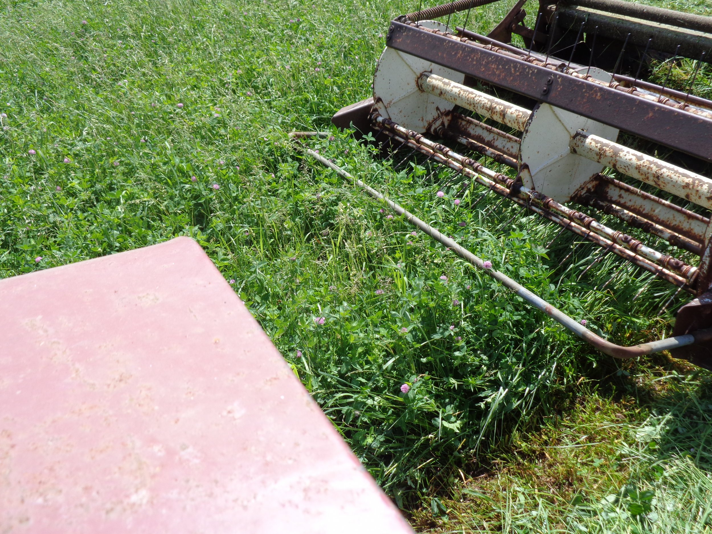

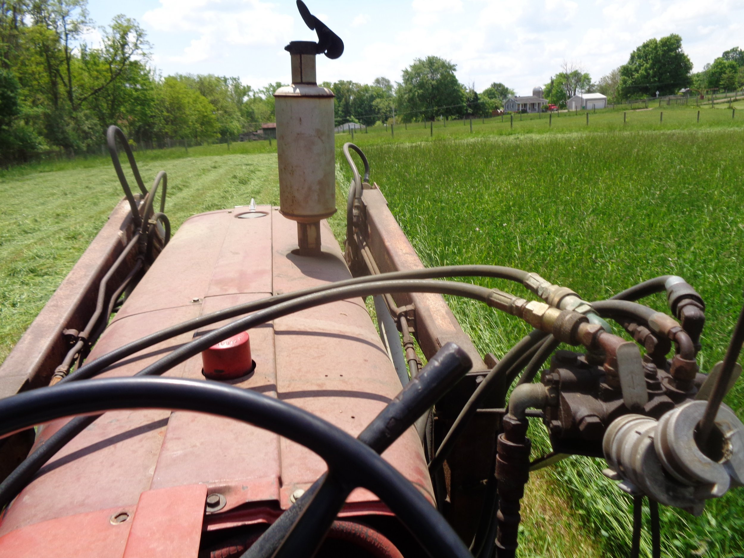

I'll pull a soil sample this Fall, then another next Fall, and see if there is a difference. I did reseed some thin spots last Fall with Fescue, and it too will not see full production until later this year, or next, although it was growing well, just hadn't reached its full potential. However, what I did frost seed a year ago Feb. 14th, is doing better than expected. As luck would have it, I caught the Fescue just headed out, Timothy in boot, and red clover just starting to bloom. The picture below doesn't show justice to the heavier part of the Fescue in the field. The best part, I gathered up some that had was drooped out of the baler when dumping a round bale. I gave it to the horses, and they licked up every bit of it. The second picture is of first cutting last year, cut May 30, that was frost seeded Feb. 14th. I was really pleased with that also. Although the Fescue was coming on, the difference between last year, and this year was outstanding. The intent was to sow it thick enough to choke out the existing Rye Grass, and was evident this year that it was successful. The Rye Grass makes more bulk, but the horses don't eat first cutting all that well.

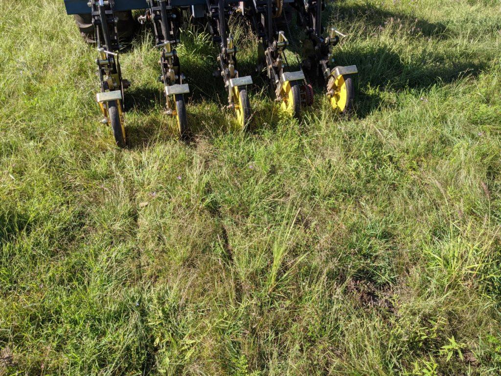

I put together a set of 3 JD71 planters on a double tool bar, 3 pt hitch with coulters. I can no till into standing rye/wheat or the mowed thick thatch with no problem. I plant food plots and plant rye, wheat, soybeans, sunflowers, lablab, iron clay peas, and egyptian wheat just by changing seed plates. It does a good job, however it is slow planting 3 rows but with a longer toolbar I could add more planters.

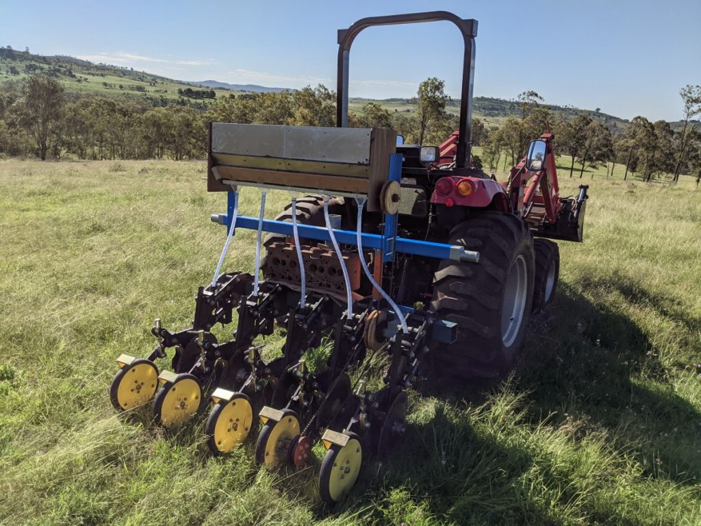

I built my own no-till drill, for a fraction of the price of buying new. OK, I cheated as I bought some ex-demo double disc openers. But put the rest together myself.
Have finished sowing this years winter crop mix now. Generally working well, though have have been several fiddly things to fix and improve.
I've bought an arduinio, and plan to convert the seeder from chain drive metering system to servo motor drive controlled by the arduino (and linked to tractor speed). Perhaps screw extruder metering too, instead of roller, but will see on that one as the rollers generally work well (for a specific set of seed anyway, and if application rate not too low).
More photos and details in my blog: No Till Seeder | Farming Adventures
