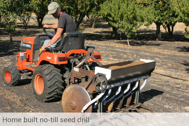

I've got an old disc harrow, a welder, and scrap steel, plus enough southern ingenuity to try to scrap together a small drill for cover crops at my place. Seems most used drills are expensive or very old, and I'm wondering if anyone has built one that worked pretty well? Pic for attention.

This isn't actually mine, I just screenshoted it of the internet. I'm hoping others might have converted some for theirs. I'm considering using a small cultivator for mine, setting up the box on top and add wheels and a pully and belt for the seeder, but I'm not sure what would work best for The actual mechanism that picks up and drops the seed.

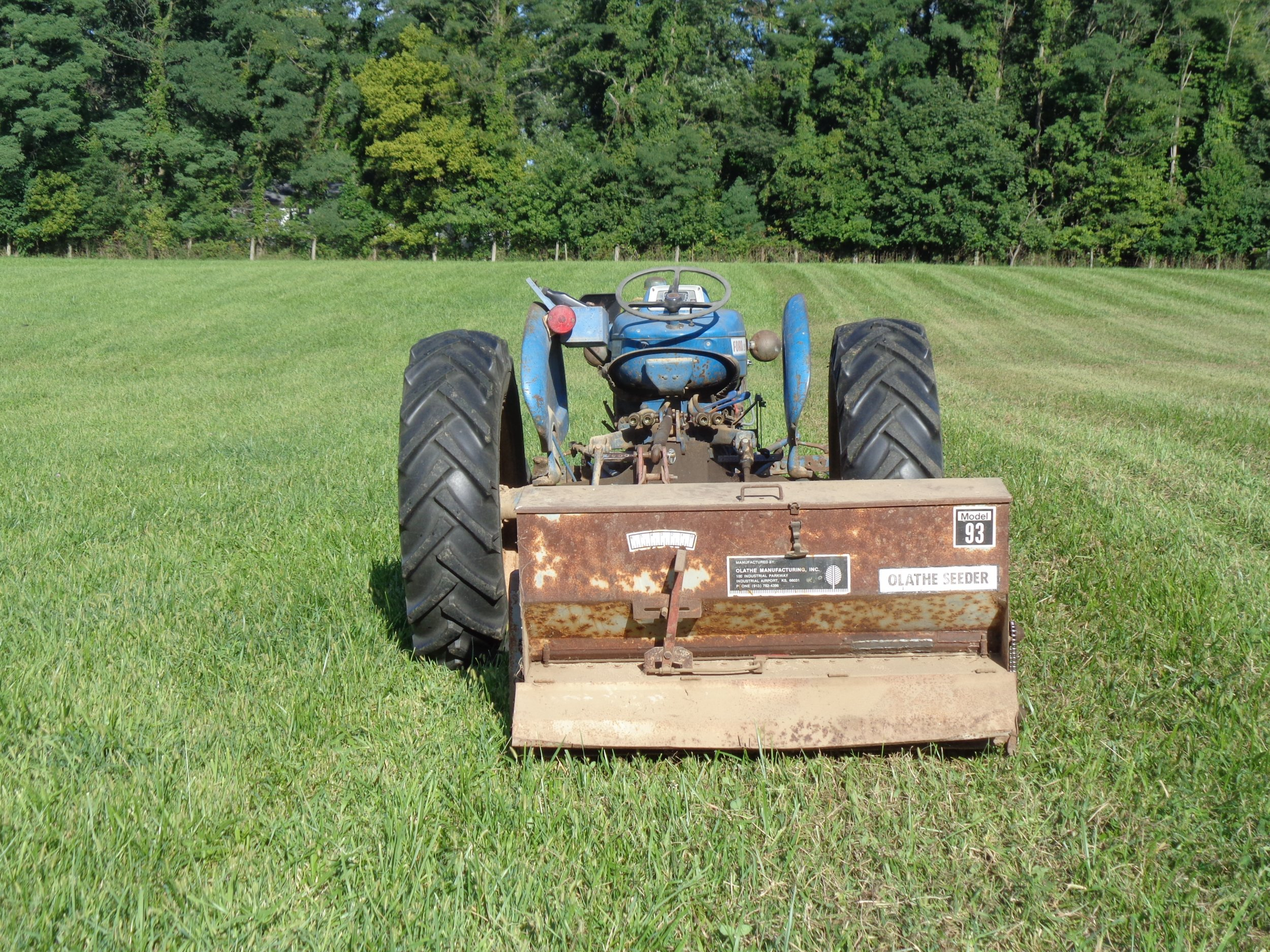

For over seeding/inter-seeding in established pastures, I use 2 methods. I bought a small 4' slit seeder that was used by a local high school to over seed their football field When they went to Astro-Turf, they had no use for it. Got it at a surplus sale for $100, it's not pretty, but works great for sowing grasses, clover, timothy, etc. Although it's only 4' wide, suggested planting speed is around 6 mph. It has a PTO driven cutter that makes approx. 1/4" slits through sod, a ground driven seed box with drop tubes, and curved disks to cover it up. I usually do a Fall planting with it here in Ohio, to get crops started before winter.
I have a 3rd option I can use here, but probably not suitable in southern states. Frost seeding works well here in late winter/very early Spring. Simply broadcast seed, especially clovers when in the early Spring the ground honeycombs during freeze/thaw cycles. You're basically mimicking Mother Nature, dropping seeds on the surface, and the honeycombing of the dirt lets the seed in holes, then covers when it thaws. Works great if you have the weather to do it.
If you're determined to go the drill method, and are planting finer seeds, then a slit seeder would work well for you. But, I don't believe the slots in the seeder will let larger seeds like oats or cereal rye, and definitely any larger seeds through. Mine is a Toro, and used mainly for golf courses, and athletic fields, or doing lawns. And, you don't have to wait until the wind lays to sow, like with broadcast seeding.

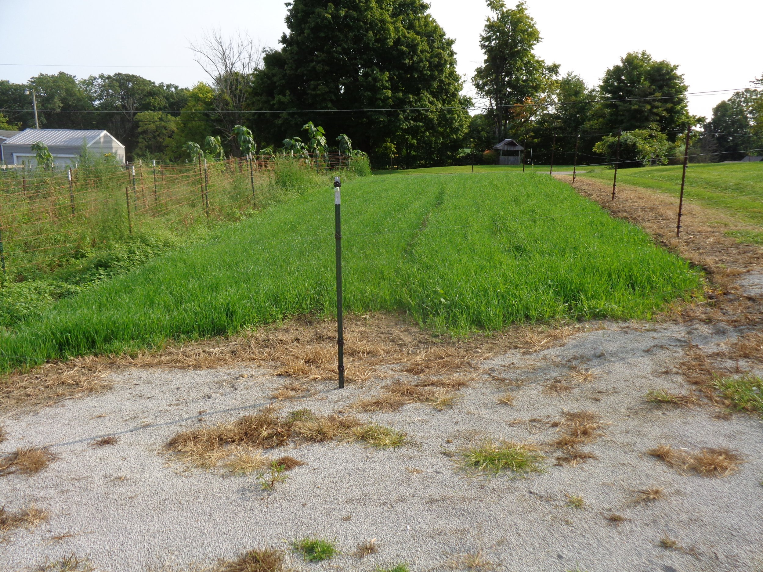

Below is prepping to sow oats, and the stand I got. Using the EZ Spreader for frost seeding, and the Toro slit seeder I used, to inter-seed into my hayfield last Sept.
