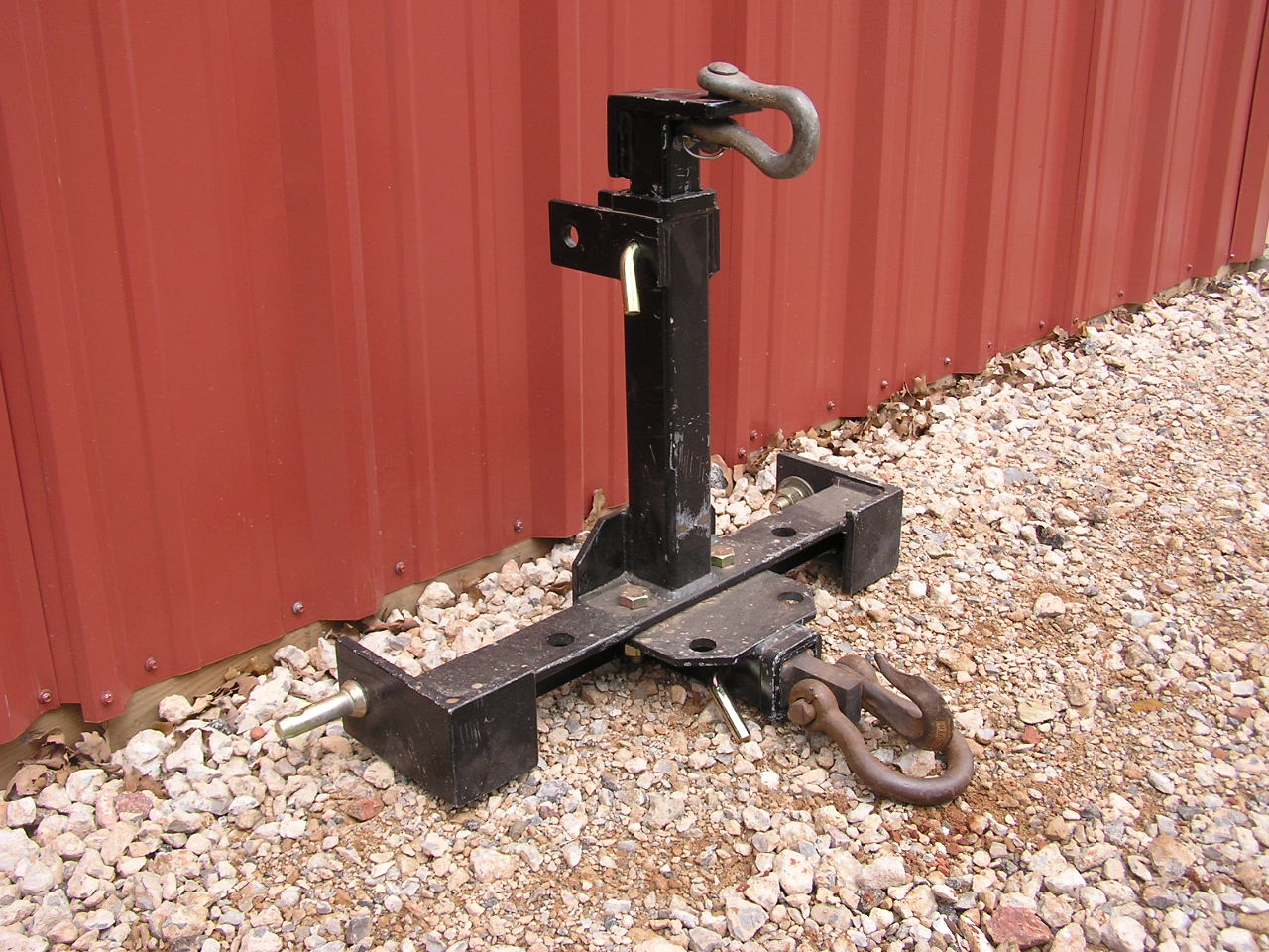

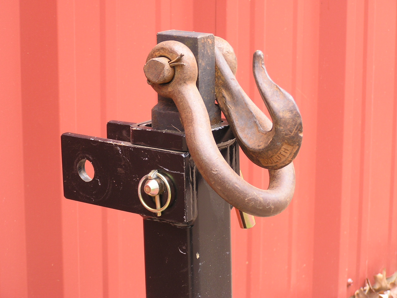

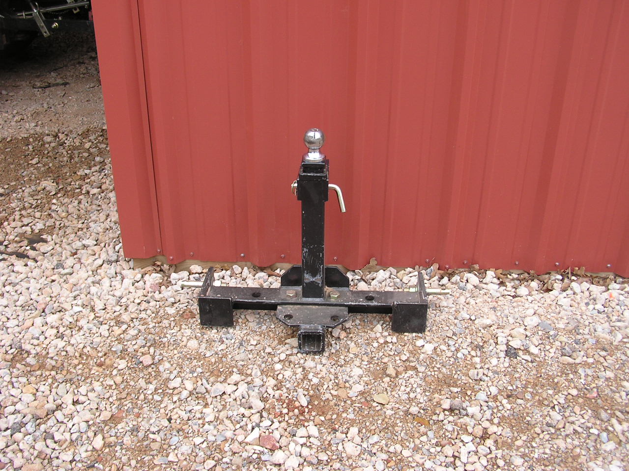

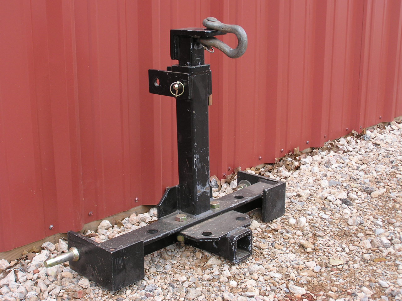

Does Harbor Freight sell this 3 point hitch attachment shown in the photo?
Omni mfg, does: TRANSFORMER Quick Hitch Compatible Platform - OMNI Mfg LLC
I have their Transformer, it is heavy duty and versatile . :thumbsup:
