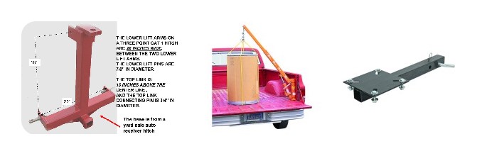

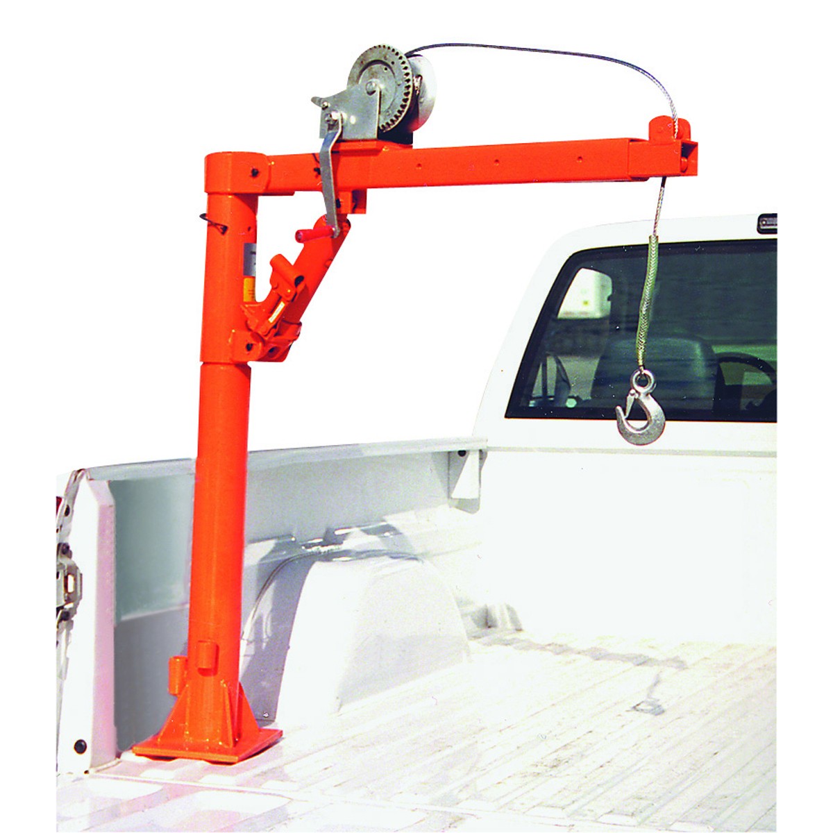

Get one of these. Add a bottom crossbar and top link attachment points to hook it to your tractor hitch.
Pickup Truck Crane W/ Cable Winch
Bruce
   / Anyone Build a Simple 3 Pt Hitch Crane? #9

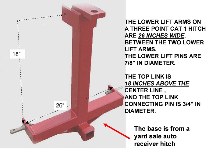

also harbor freight has a "vise" mount on a 3" tube along with this make a good hefty hitch receiver
   / Anyone Build a Simple 3 Pt Hitch Crane? #10
Be careful when you swing it outboard. As the load transitions from between the lift arms to outside of them, it will pull up on the far arm and any pin clearance or swing of the arms which lets the load tilt further will suddenly happen. This even happens with a normal boom pole on a slope.
