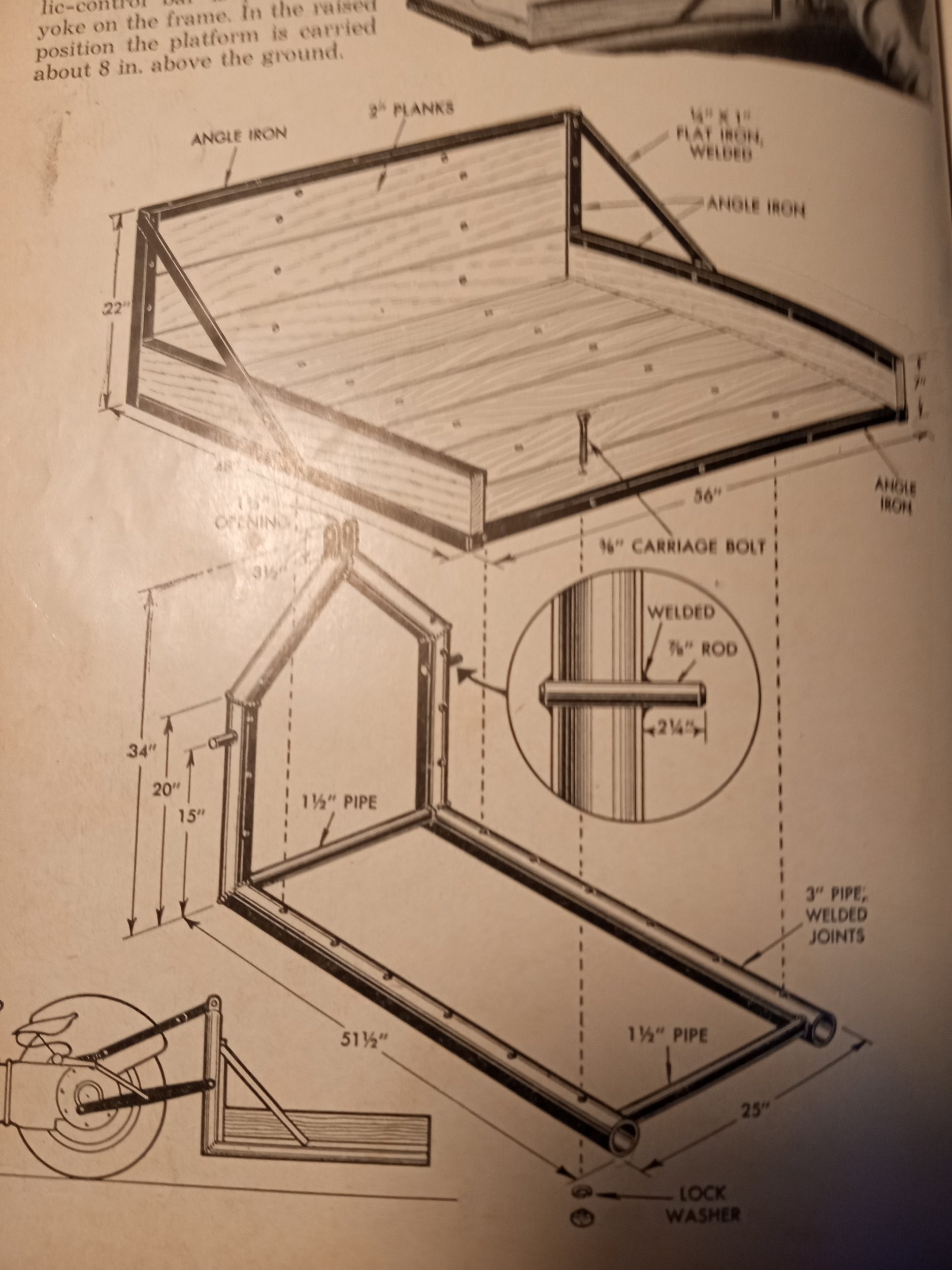

/ Anyone build a carryall frame? #3
I can‘t locate a used carryall frame within 200 mile of me. Plus none of the implement dealers have anything new in stock. Has anyone built their own frame? This may give me a good excuse to buy that welder I’ve always wanted. If so, share some photos or advice. Thanks in advance.
You mean like this one

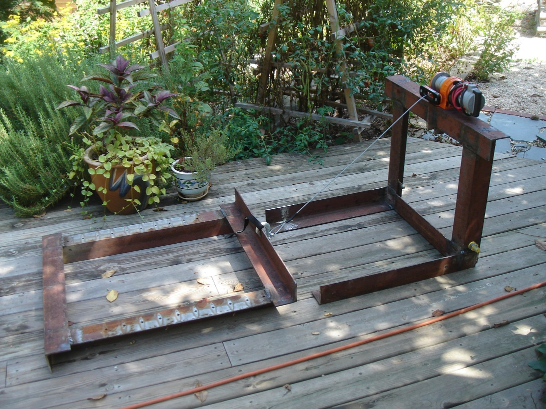

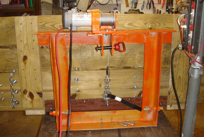

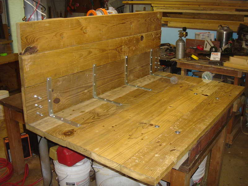

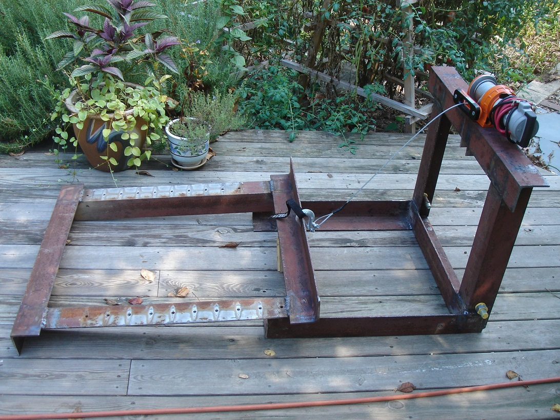

Buy the welder... I built this a very long time ago. It was to be a dumping carry-all. But also, carry my tools and be able to easily drop it off. Never really used the winch. The frame it self also carried a 55 gallon drum that got strapped into the frame. I could pick up the drum that rested on some 6x6's. Frame also, was part of my spray rig, tank fit between the rails, as did the spray boom (just clamped it in place). Fun project...

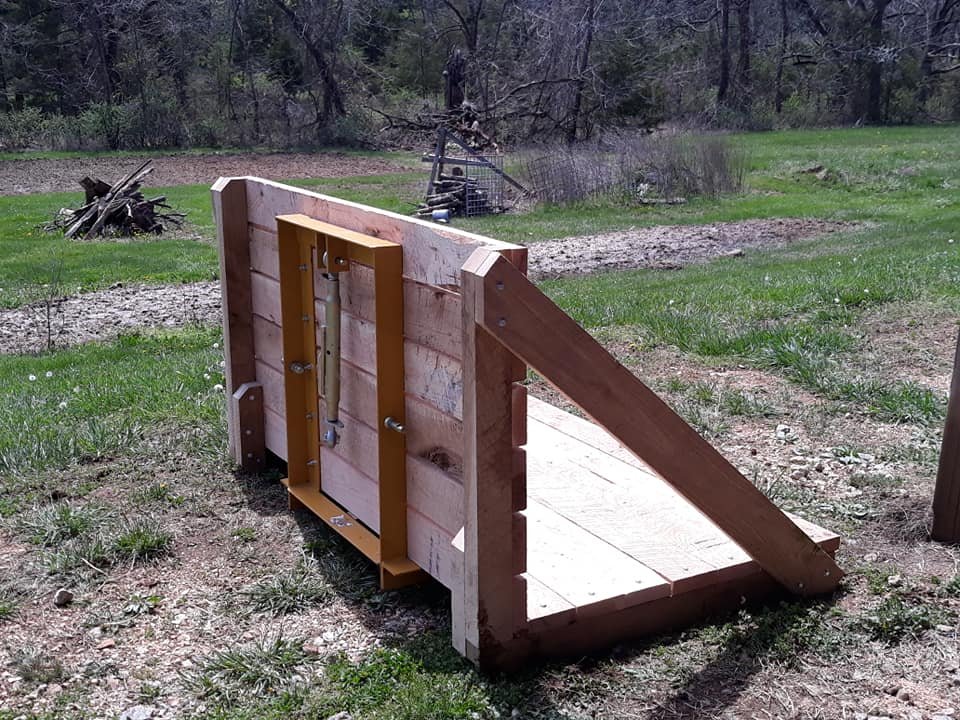

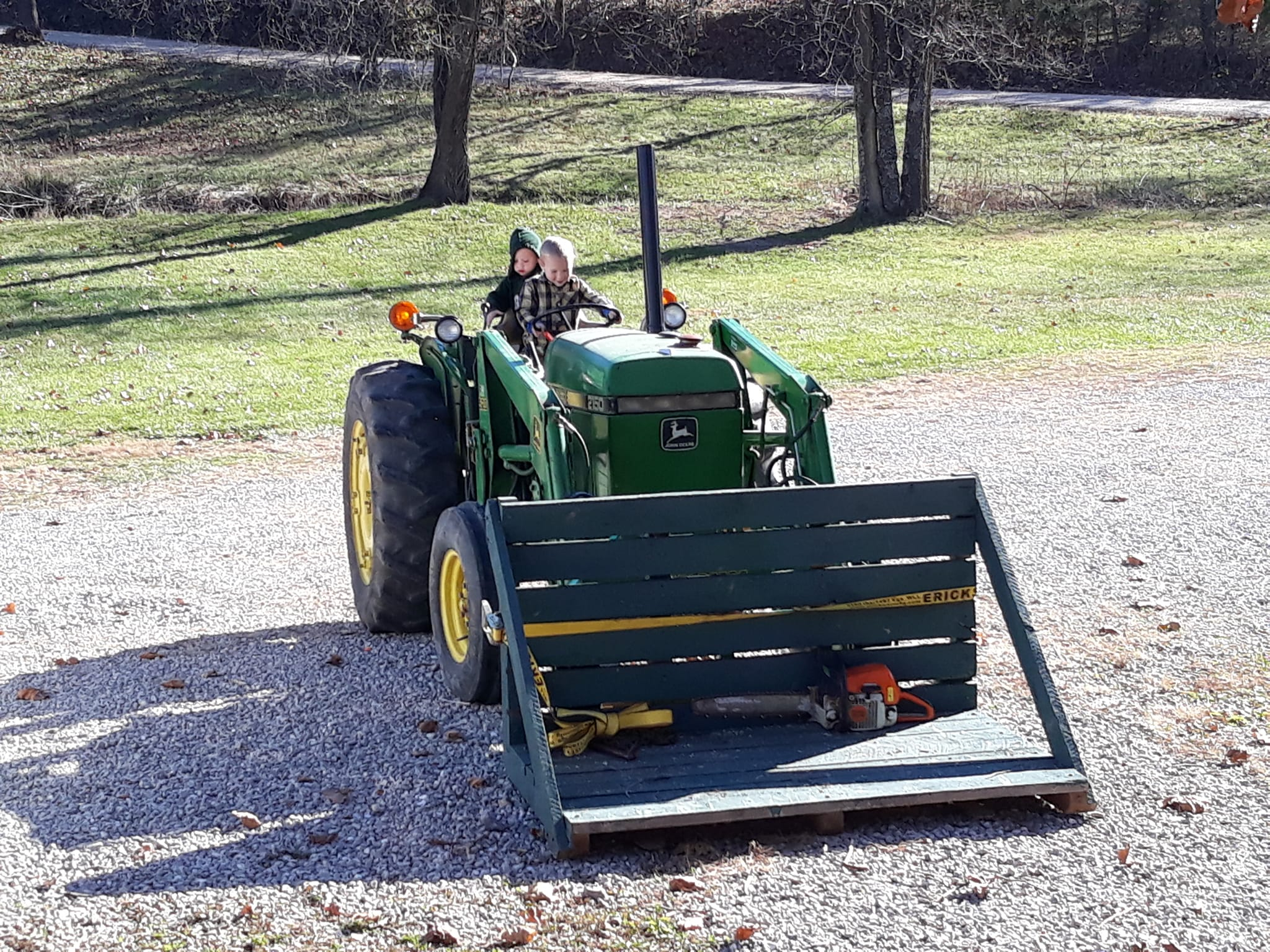

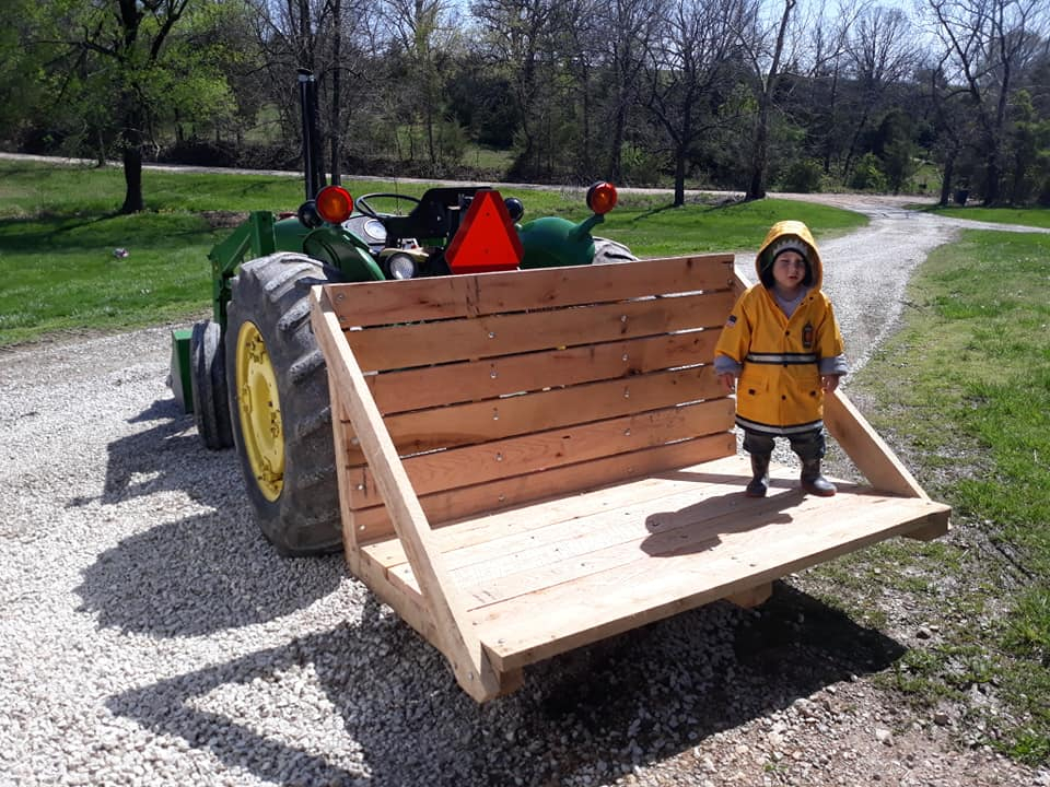

I used the TSC carryall frame, and use it on three-point, or as an elevated platform on the pallet forks with the front end loader.

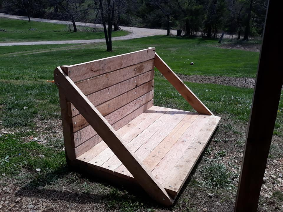

Where are you located? I built one a few years ago and that's about the last time it was on my tractor. Its 2x3x3/16 steel tube with locust boards and SS hardware.

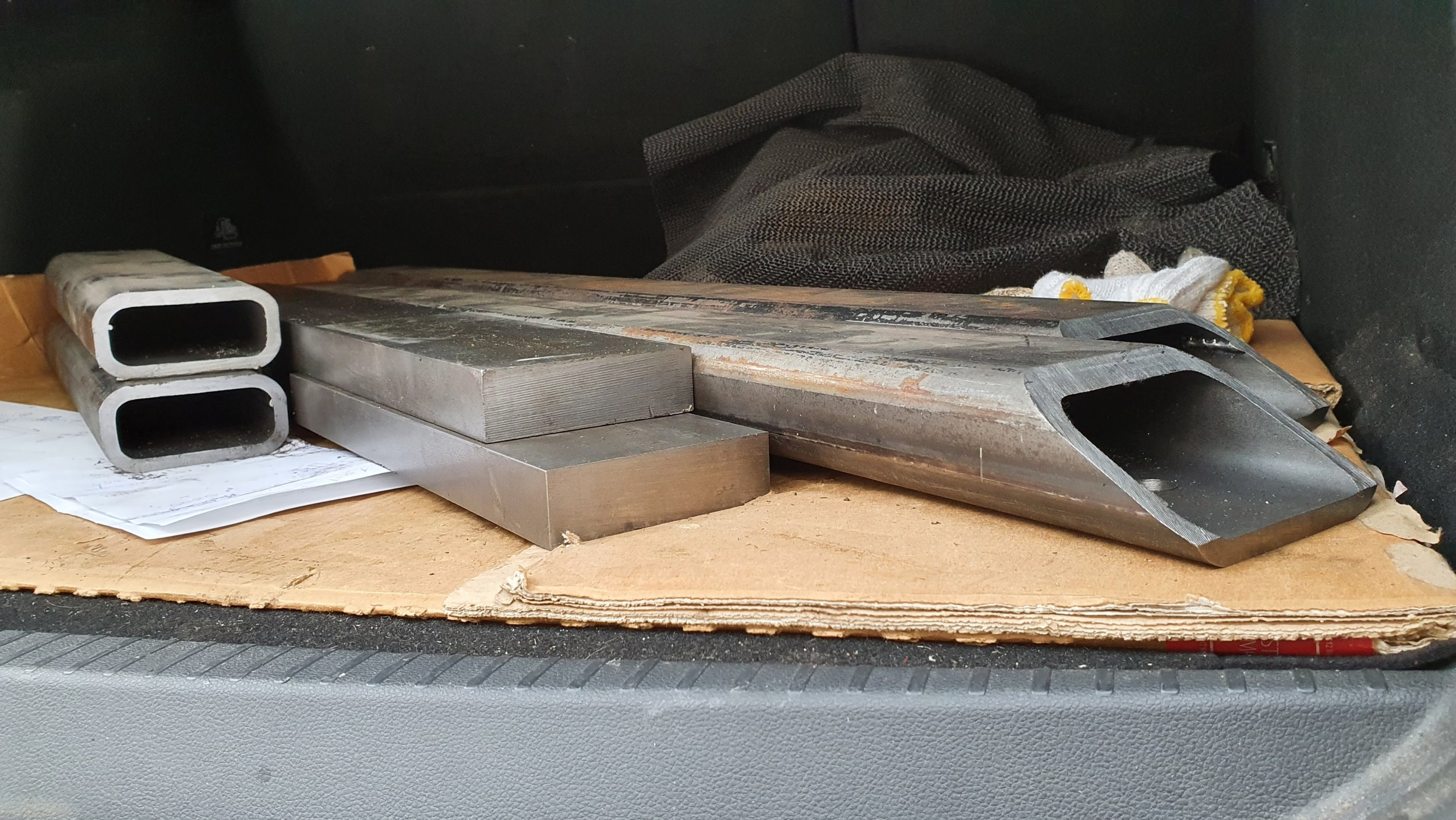

The mech-shop manager called me today and informed that they had already cut the profiles for me that I would use in my new pallet forks project. It will be assigned for a small GB-15 tractor (CAT1), but will also have to fit a large one (CAT2). Although I have a forklift stem adapted to a 3 pt hitch for large loads, life has shown that it is convenient to transport small loads on a pallet with the pallet forks only. I'm gonna make new forks of a steel profile with rounded corners of 100x50x10 mm, which will be suitable for both tractors. The only question is the design of those forks. You want an adjustable width, but these are heavier. Not very good for small tractor. The light forks are dangerous for a large tractor, 'cause they can break.
Crossway ...
I'm on the same boat.

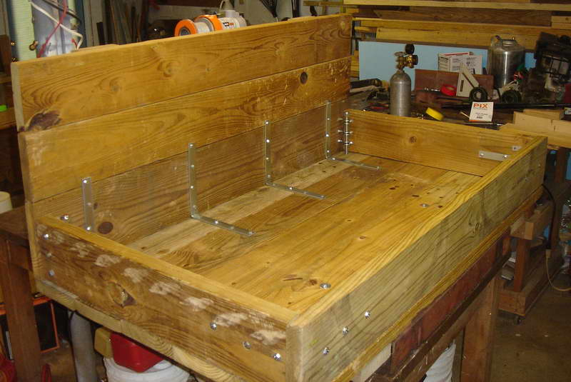

I bought the TSC one and started with an old pallet placed on the bottom and built around it.

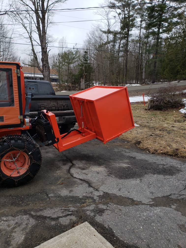

Built this one years ago out of scrap. A frame for snowplow, some sweet steel from the dump, a receiver hitch I kept from a traded vehicle, 3/4 marine plywood from a dock. Had to buy hinges and hasps though. Built it for my first Kubota, three tractors ago. Didn't use it since I got my RTV so I loaned it to a friend, now it's on his second Kubota !
