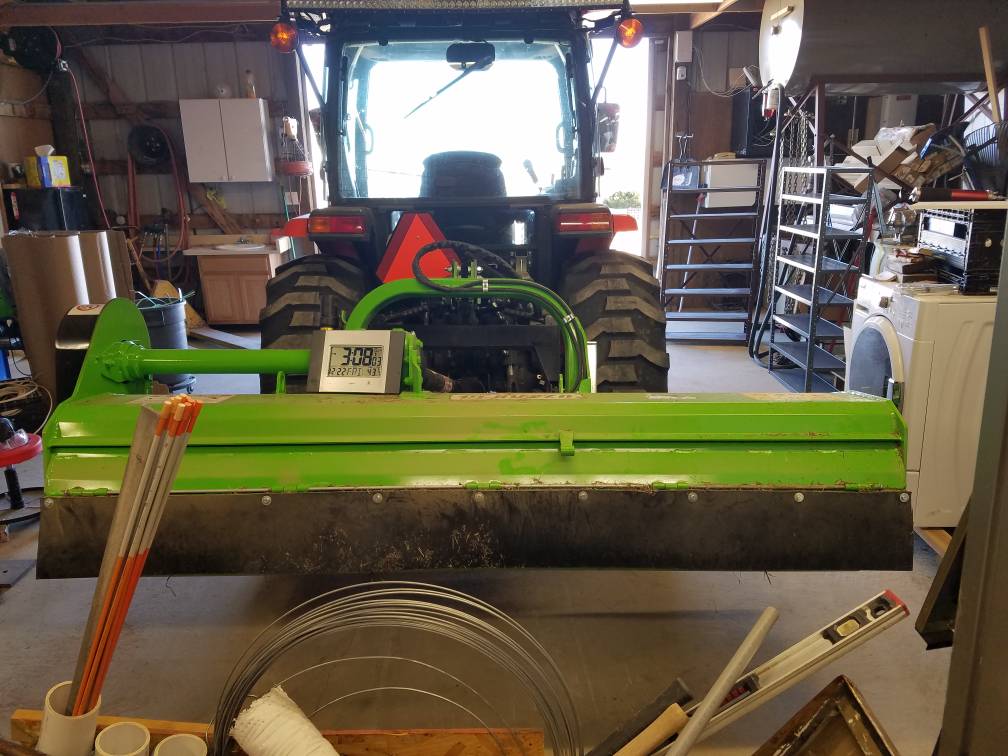

If that’s the case I’ve been running mine for many years now way over rating :) I’ve. It had any issues with mine , and I run a 1600 lbs cutter all the time with it.
/ Anyone break a Harbor Freight Quick Hitch? #3
1,600 lbs on the HF Cat I hitch?! Country, I think you probably hold the record for product testing. :eek:
/ Anyone break a Harbor Freight Quick Hitch? #4
I think Fallon has used his with a 1700 flail mower, with no issues.
/ Anyone break a Harbor Freight Quick Hitch? #5
Not even with all 1,700lbs offset way to one side & snagging on 2" thick scrub oak.
