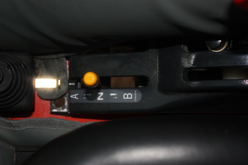

I have on the right hand side of my seat a small lever that moves fore and aft. It has the letters 'A' (in the forward position) 'N' (in the mid position) and 'D' (in the rear position). This lever is right beside the lever for the 3pt hitch. The question is, what does this thing do?
/ Anybody with a CK27HST #2
Either draft control or auxiliary hydraulics. Picture would help.

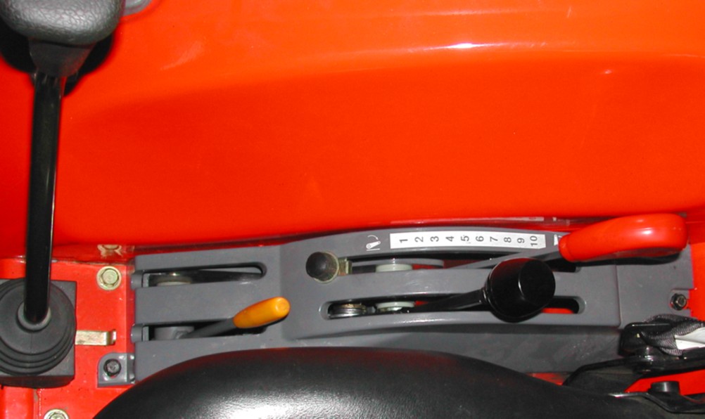

/ Anybody with a CK27HST #4
Here is a photo of my right-side control lever area. The orange handle is 3pt position control, the
yellow handle in an OEM single detented remote (option), the empty slot is for the 2nd OEM
remote (option), and finally the black handle is in the draft control slot. That black handle
is my engine speed control, however. That's custom.
The service manual refers to the draft control option, but I have not heard of any CKs being
sold in N America with that option.
Did your tractor somehow get the DC option?

no draft control on a CK. It's for a rear hydraulic remote, or a backhoe (or sorta both). Positions change flow of hydraulics. Should return to neutral when released. May lock in one or both positions. Be careful with it engaged in and left in either position. Deadheading the hydraulics will destroy your hydraulic pump. If you don't use the rear remote, put a loop back hose between the ports to prevent deadheading.
/ Anybody with a CK27HST #6
If you look just below the toolbox on the right hand side above the 3 point hitch, there should be 2 hydraulic connectors. (rear remotes)
The switch (the yellow one in your pic) controls the pressure and return to these connections. Used, as others have mentioned, to provide hydraulics to a rear implement, such as backhoe, woodsplitter or even turn a shute on a snowblower. when in "A" position, fliud flows one way, when in "B" flows the other way. Should keep it in "N" when not using it. (currently in "B" in your pic)
/ Anybody with a CK27HST #7
I have a backhoe with my CK35. I use this lever and go from A to N, depending on if my backhoe is on. One runs the backhoe and the other the 3pt hitch (only one at a time). So every time I put on or take off the backhoe I switch from A to N. As mentioned make sure you do not deadhead your hydraulics.

I'm not sure if you're still looking for the answer, from this post is seems like you are. The previous posters are 100% correct. There is no draft control on a CK series tractor. The A-N-B is for the single set of remotes that you paid extra for, if you knew it or not. The CK doesn't come with remotes, it's dealer installed. Kioti offers a kit for the second set as well, when it is installed, you have a second lever labelled C-N-D. My second set also had a float position, but they both have a detent position, but you don't need to worry about that if you have a loop installed.

So what does the 'A' and the 'B' do? The 'N' I am going to assume is neutral.
/ Anybody with a CK27HST #12
The "A" position, lets fluid out the top jack and returns on the lower jack. "B" reverses it. So if you have an implement attached, such as a rotary chute on a snowblower, "A" turns the chute left and "B" turns it right.

The a/n/b switch is strictly used to control the rear remote operation. the big red knob controls the 3pt hitch. If you add a second rear remote, you will get another switch, but it will have c/n/d on it to differentiate it from the other. ab controls one set and cd controls the other.
The loader is controlled by the remotes located on the right hand side of the loader frame in front of you.
