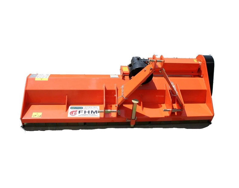

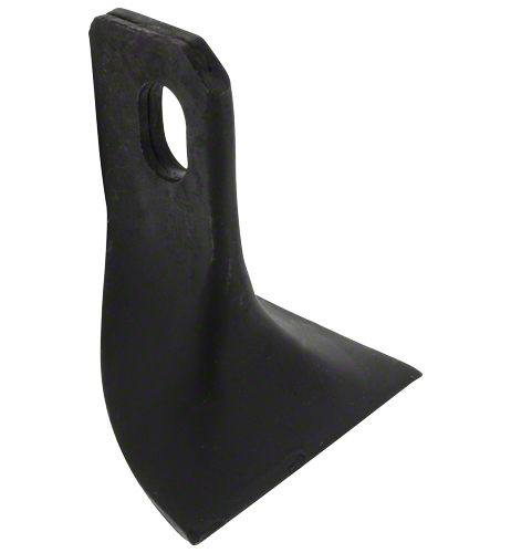

I'll add to the discussion that I have the std duty FH-EF175. Mainly wanted a backup for my 54" mower if it dies and to trim back pastures after grazing and couple fields that get bush hogged 3 times a year. I'll have to say initially I wasn't impressed with mowing quality with the Y knives. I even removed them all, put razor edges same as my mower deck blades and still would leave 18-24" weeds behind (not a lot, just a few stragglers). The 3 point angle has to be adjusted out to keep from bending the taller stuff over too much as this is a reverse rotation cutter.
My best move to improve the cut was to remove all the knives and replaced them with scoop blades (attached). I don't get into anything really brushy and have also 'de-rocked' all the areas I mow. Had to grease everything straight off the pallet and fill with oil. If overfull, will burp some just like the Caroni's do.
My only gripe would be that the included PTO shaft doesn't offer much adjustment in length on my NX-almost too short. I ordered the PTO extender alot of guys use with their quick hitches so I could tip the front back even more. Either way, I can say I don't think I would be any more impressed if I would have spent 2 to 3x more money for it on another brand.
If you get one be sure to register on their website within 30 days for the full 2yr warranty. Did I mention it comes in orange or red?
