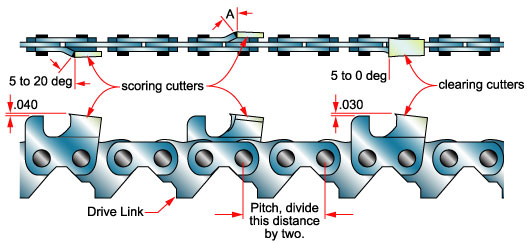

I finally figured out that we're talking about two different ways of grinding off half of the horozonal cutting edges. You meant that the horozinal edges were ground to half of their origonal width. On my chain, the horizonal part of the tooth was ground completely off on every other tooth on each side. Maybe that wouldn't total up to half of the teeth but, I thought it would. The way your chain is configured really is an interesting concept. I'd never thought about doing it that way.
I think that is very close to the chain I have, though they leave a little (and I mean little) of the flat part of the cutter there. The idea is to make the kerf with two outside cuts using the skinny cutters, and then the third "wide" one comes through and simply clears out the middle as a chip.

Here's a diagram of that "Granberg" rip chain from their website:

S219,
You're right. I forgot about the tiny bit of the horizonal left on the chain.

Cool Diagram !! That is interesting :) Thxs
