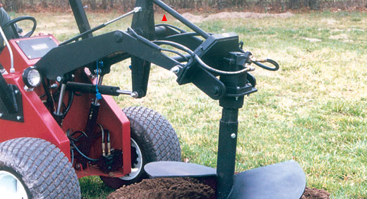

The roll over connecting bar on my 1334 has several holes to adapt to different attachments. More or less tilt.
You can build a new bar with say four holes for a better fit. One hole on each end and two more toward the end.

I replaced mine with an adjustable top link. But that does not change the range of motion - just the start and stopping angles.
Ken
