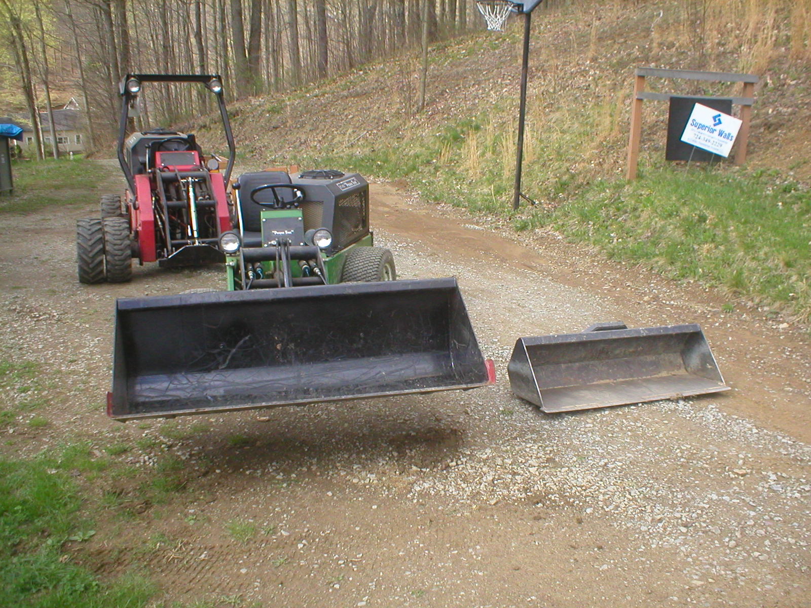

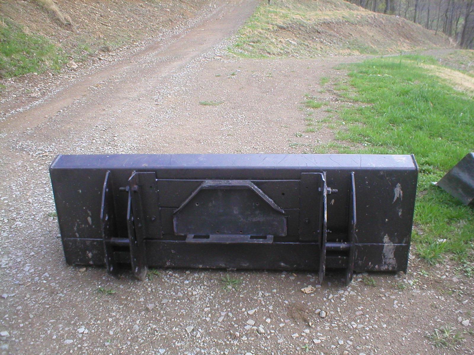

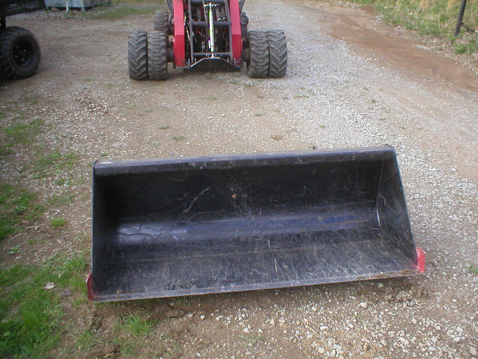

2013-04-19 22.34.25.jpg2013-04-19 22.34.50.jpg2013-04-19 22.37.29.jpgI wanted a bucket for my 1845 and was going to purchase one from Power Trac but like you said the cost of shipping was high, so I looked around on ebay and craigs list and local farm equipment dealers and I found this 5 foot bucket that fit my needs. I managed to get it for $250from a dealer in Marion Center as they had some that had been in their yard for several years and they wanted to get rid of them. It was a bit rusty but solid. I then made a modification to it so I could use a quick attach plate I had for my 422 , so now I can use it on either my 422 or my 1845. Check with your local dealers for buckets .

Nice job and good buy. Looks like that one should fit the bill.
