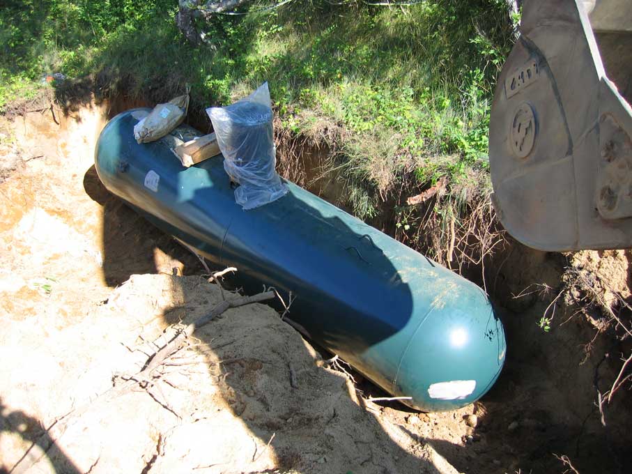

Looks like a torpedo left over from the war that someone painted blue. I would fill it now because once it starts to get cold, they put butane in with the propane to help it flow in the cold weather. I have never had a problem with the straight propane here, and I don't like the butane addition because it makes your propane appliances soot up. This was what I had experienced in the old cottage that had a propane heater. Once they put the butane into the mix, I would have problems and have to keep cleaning the pilot and thermocouple. Once they switched back to pure propane, no more problems. Also the kitchen stove would leave black soot on the bottom of the posts.
