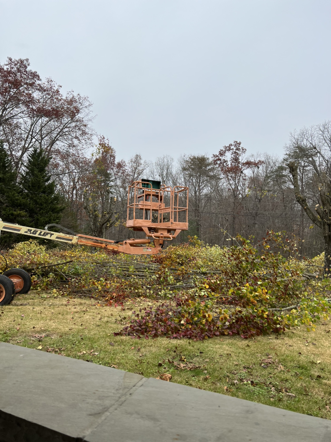

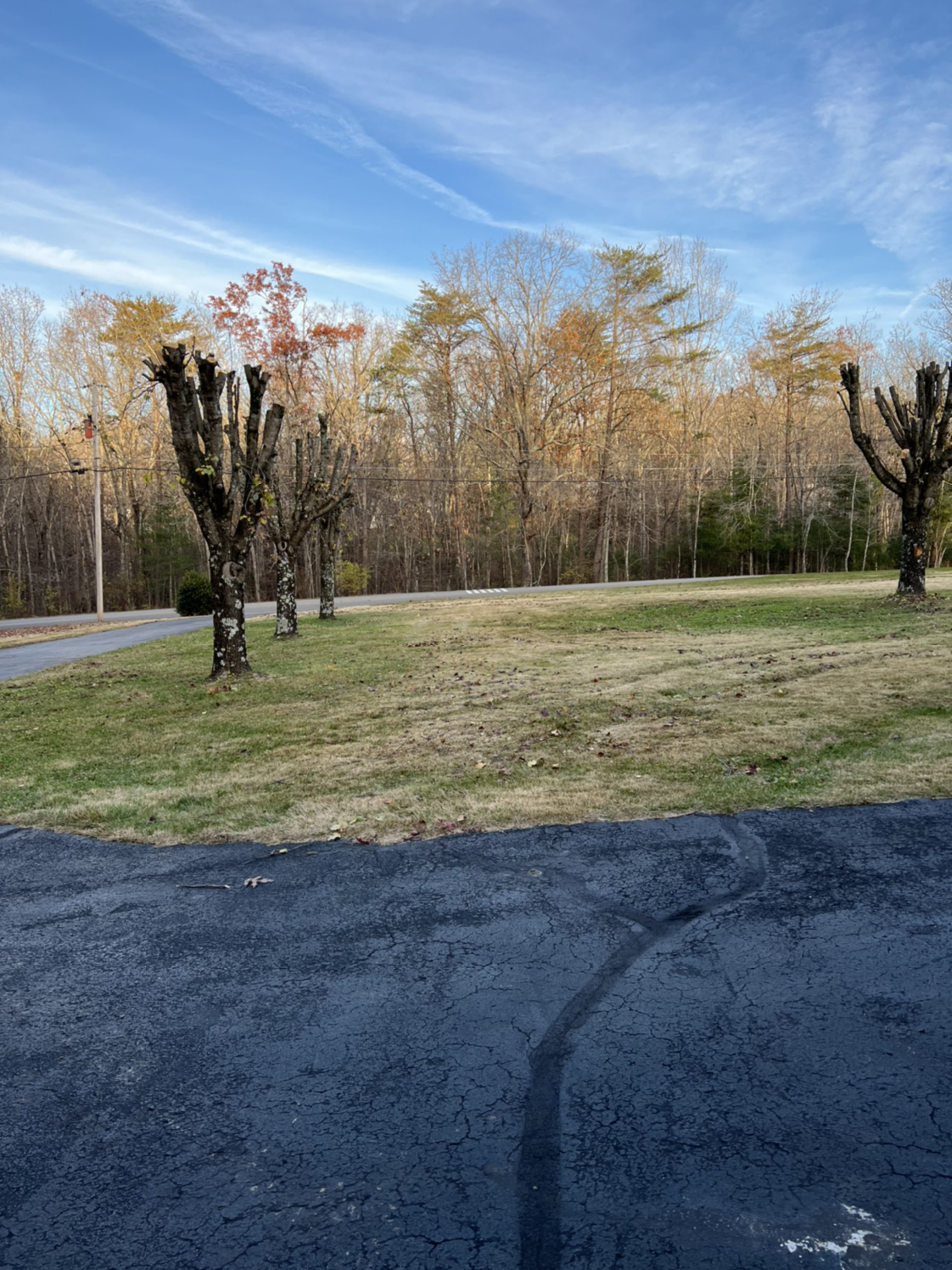

The mini isn’t bad on the grass if you know what you’re doing. I cleared all of this brush off the yard with my mini. As soft as it was my 420 would have been far worse. And that one set of ruts was from the lift not my mini. A skid steer on the other hand is brutal on grass and there’s no way around it.
