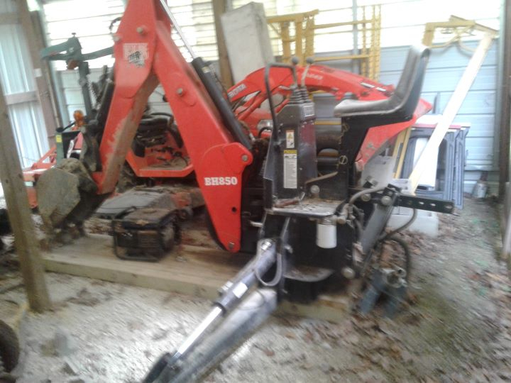

Modern day tractors are two light duty, needing additional iron (sub frames) to handle backhoe. tractors in the 50's - 70's didn't have sub frame hoes. I have a ford4000 with extendable lift arms for my 1200# backhoe. Somtimes you can connect it in 15 min. next time almost an hour. Several tube videos showing minix can work faster than a hoe.
Bush Hog made this one about 12 years ago.
I think ours is a 962H. It beats the heck out of a shovel.
