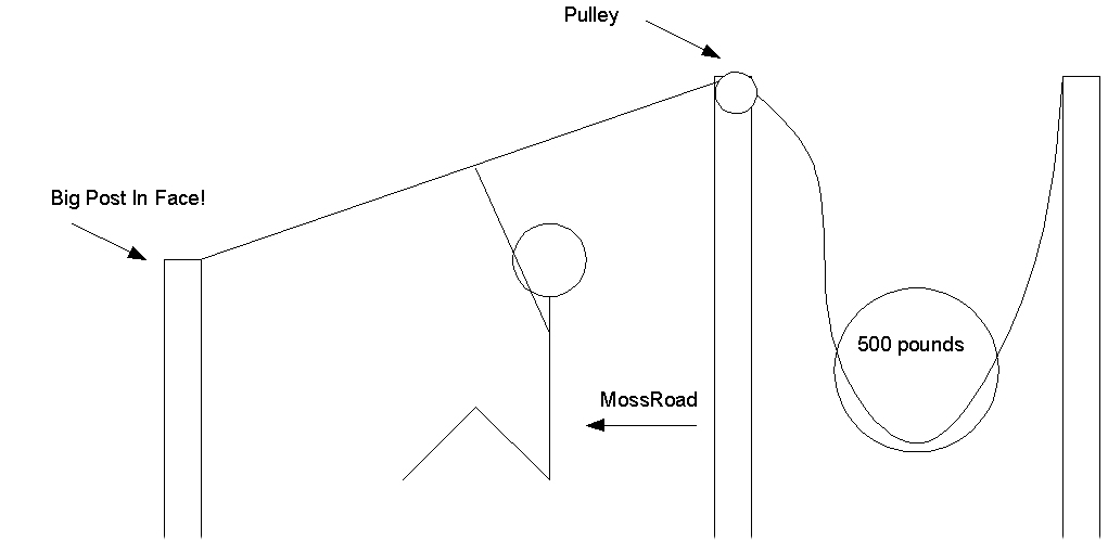

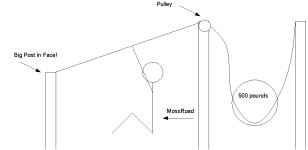

/ Anybody here built a zip line? #24
I think he's saying if you put a cable between two post and pull it tight, then measure the tension on the cable. If it gets cold, the cable contracts, putting more tension on, as it tries to pull the posts together. Conversely, if it gets hot, the cable expands and the tension on each end diminishes.
Can you see that in a long cable run, that could cause the cable to sag in the middle quite a bit in hot weather and pull very tight in cold weather.
Now put a 500 lb trolley on that cable. In the winter, the trolley may get you over most objects very fine. In the summer, it may dip too low to get you over those objects. Lets hope the zip line doesn't run over a cactus patch! :)
By putting some weight on the cable past one end point, you can keep the cable at the same elevation all year.
At same elevation and under same tension!
Pullies will actually multiply forces as in a come along or as on a winch using a pully.
One pulley does nothing but 2 doubles 3 tripples the forces or tension.
No pulley, ie fixed attachement at both ends could actually pull the anchorage out of the ground given the proper temp swings or at worse place so much tension on the cable as to even snap it, never mind the fact that at the center of the cable on a hot day you might just clear the ground and in the coldest you would be as high as your ancorage points.
A good sound tree as one anchorage would take care of tension problems as a tree is flexible and would act as a big spring or bungee.

/ Anybody here built a zip line? #26
the tension in the string (cable) is always the same. i dont care HOW many pullies you put on the end. its still only (say) 500 lbs hanging off the end of the cable.
When done properly the end of the zip line cable is not the same as the cable holding the 500lb weight. The line with the weight, goes from the weight, to a pulley on a block, and back to an anchor, back to the pulley, back to the anchor, back to the pulley, etc. The zip line is connected to the block .

Above info well presented,
but may I add:
Seasonal temperature changes will add stress (tension) as metal shrinks with cold!
For that reason ski tows always used weights at one end to keep tension constant.
I believe the safe way would be dead weight via pullies hung at one end.
With pullies you can 1/2 or 1/4 the needed weight.
Even bridges have expansion joints!
(not calculated) but even a 45 gal drum filled with concrete might be all you need (with pullies as multipliers)
