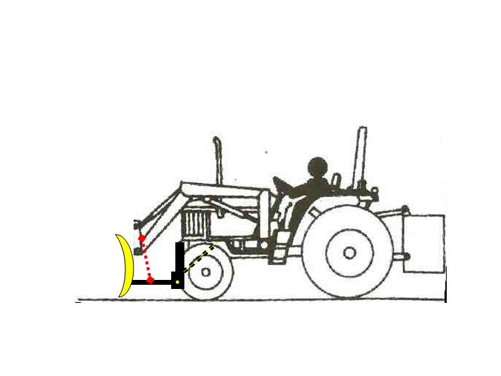

I have a 2006 JD 990. This is the design I have been thinking about building. Just a basic set-up but will be easy to use. Make a quick attach bracket to mount to bottom off grill guard with brackets going back to frame holes already threaded. I am going to leave loader attachment on and attach a shackle for chain to lift plow. Since I am not sure how effective or how often I will need to use it, so for know I will not hook up any hydraulic lines to shift the plow left or right, just a pin. If I find, I use it a lot I will hook them up.
That's an interesting concept for sure! Please let us know how it works out:D
   / Anybody have a loader mounted front blade? #18
Another good and simple idea, you could easily control the angle cylinders with the curl and dump circuit.
Necessity is the mother of all invention!
