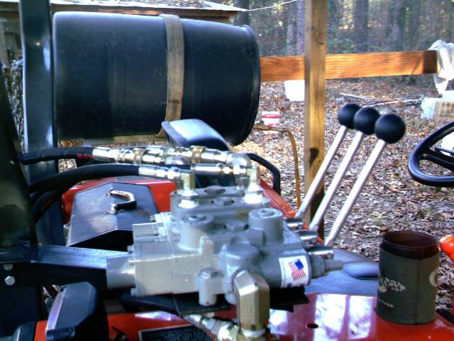

hey,
I do have a 2004 L3400 with a 3 spool prince remote valve. If you order the valve from northern tools it does come with plain instructions. I do not have any good pictures right now, I am offshore, but when i get home I'll try to look how i did mine.
I do know i come out of the power beyond, it has a green piece of tape on the hose under your right foot. I will try to get you some pictures.

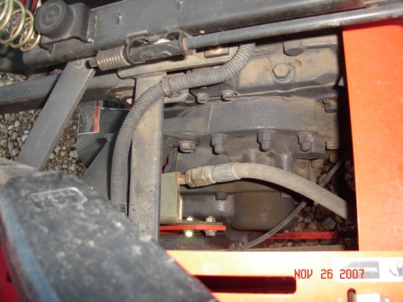

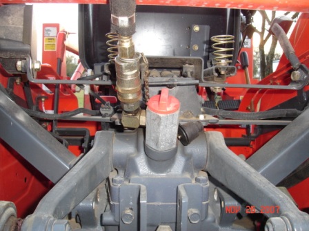

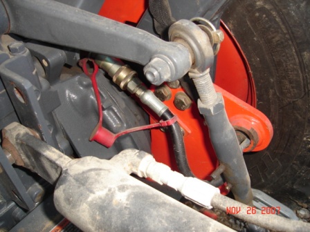

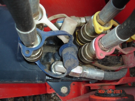

Canoetrpr; I do have what you are looking for but I am at work so I will get ya some pictures tomorrow morning.
   / Anybody have a L2800/L3400 with remotes AND a BH? #4

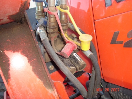

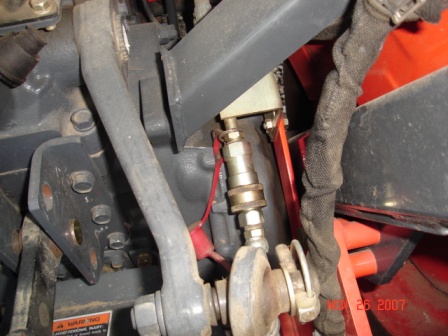

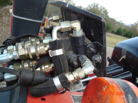

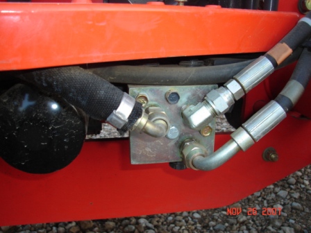

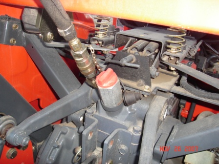

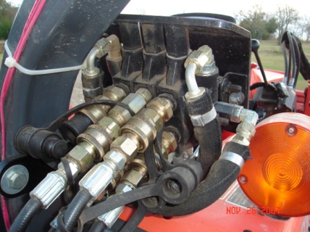

Canoetrpr; Here is what I got.
The first and second one is of the loader block the line with the 90deg fitting on the bottom of the picture is the one you want (pressure).
3. Is where it ends on top of the rear diff.
4. Shows the QD for using the BH. Note if you only had a BH and no rear remotes this is the only QD you would have in the rear and that line would return to the hyd block under your R/H step.
5. Is just another angle.
6. Is where the female part of the QD goes to on the remotes (it is labeled "in")
7. Is the other side of remotes, the bottom line is the return to the hyd block, the top goes to the fill port on the top of the diff.
8. Is just another view.
9. Is the hyd block, the aft line is the return line from the R/H lower of the remotes.
10. Is the return to resivour/bypass line which come from the top of the R/H side of remote.
11. Is just another view.
That is it in a nutshell, it all sounds complicated and all that good stuff but when ya look at it....it really ain't all that bad.

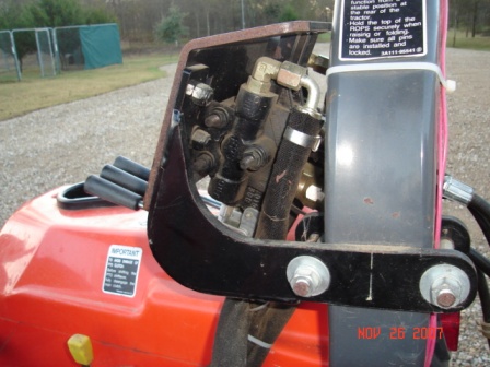

Pics of the Kubota BL7303 valve and L7314 hose kit mounted on a customer's L3400.

Todd:
Thanks for the pictures.
I noticed in the third picture that the existing PB hose from the loader was joined to a host (presumably provided in the kit).
I was planning on just replacing this hose but if I can get away with just unioning it then it would save me some dough.
I imagine that a new hose would be better but a union works.
