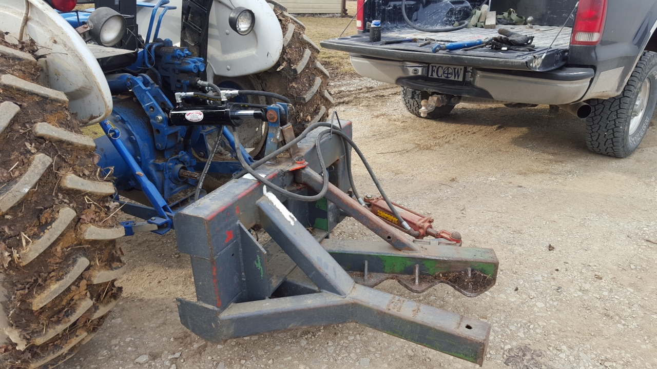

I was thinking of my trailer mover... yes, can be done with a competent welder and some thought.
   / Anybody ever see a 3pt attachment that did the following.... #3

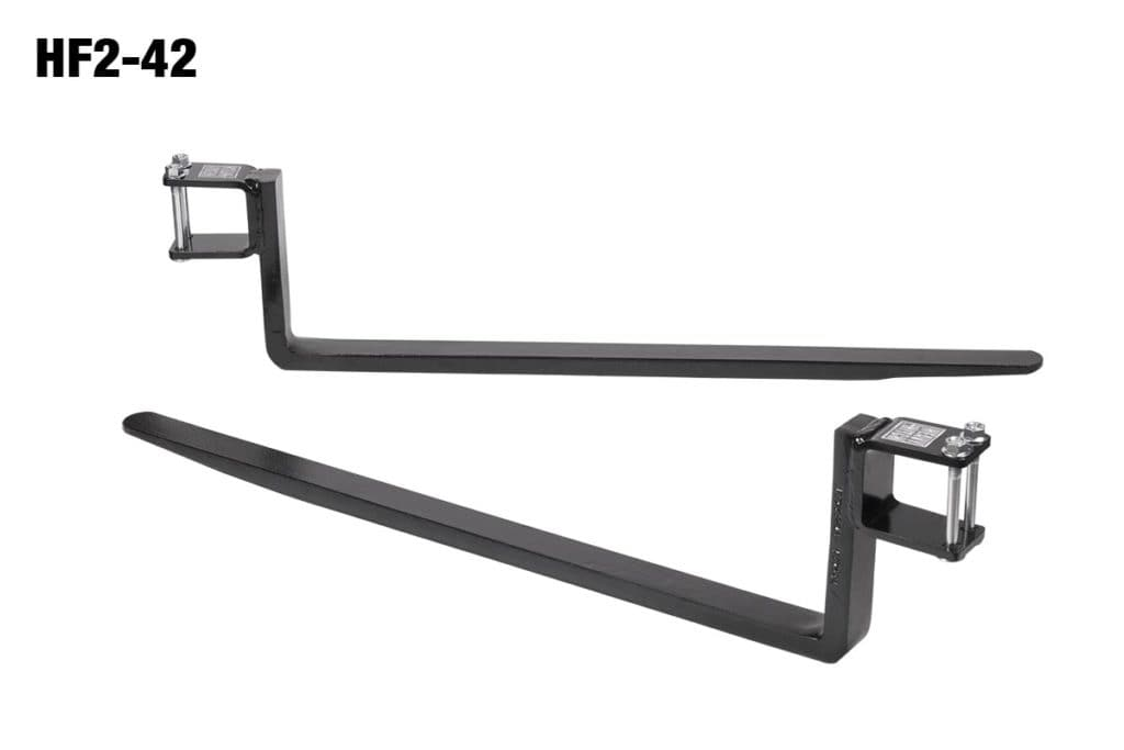

Leave off the upper spear. Use the lower ones as forks. Like this one,
from here: 3 Point Trailer Mover - Bale Spear Questions / Suggestions
Or start with a trailer mover and add forks like these:
I've also seen a trailer mover with two additional receivers added on at the ends to make 2x2 square slip-in forks

I watched that video and the idea intrigued me...but then researched the product and found the heaviest model only has a capacity of 1,700lbs. I need something that will lift my 2,500lb counterweight.

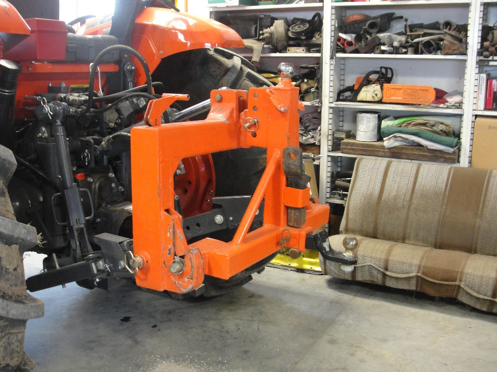

Be careful on pin weight.
I have a Carbon 35 bumper pull toy hauler. 1,500lbs tongue weight with the toy in, 1,700 empty.
My L4060hstc will lift 1,700 on the loader barely, if you get the load very tight or under the SSQA. Lifting the tongue with my quick hitch & trailer mover creaks a lot.
The toy hauler pulls poorly & I should have gotten a 5th wheel. Most 5th wheels have 2-3k lbs of pin weight. An unloaded gooseneck is likely to weigh a fair bit less than a 5th wheel though.
Just be sure your machine can lift the appropriate weights. A quick hitch, teailer Moorer & 2" reciever move the weight back probably a foot or more. That drastically decreases your capacity.
Tractors are designed to tow from the drawbar not the 3pt. Especially with a gooseneck the hitch point is above the axle. If the trailer hangs, the tractor can easily drive out from under the hitch & roll. Towing with the 3pt isn't approved by the safety police. I have no problems shuffling trailers around the yard slowly with my 3pt. But wouldn't tow at any real speed, across rough ground or on a road unless I hitched to the drawbar. Just understand the risks & physics.

I brainstormed this idea several years ago and gave up.
My idea was to modify my QH to accept SSQA attachments. Couldn't figure out how to do that without losing the QH capability that I use a LOT. I made a hitch adapter that can go on 3pt and/or my QH. But I still don't have fork capability.
I've got a set of SSQA forks. But couldn't figure out how to adapt them to fit my QH without losing the SSQA ability. 🥴
I built a SSQA tree puller. Then added 3pt capability to it. But it also won't fit my QH.
