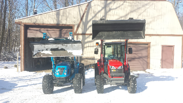

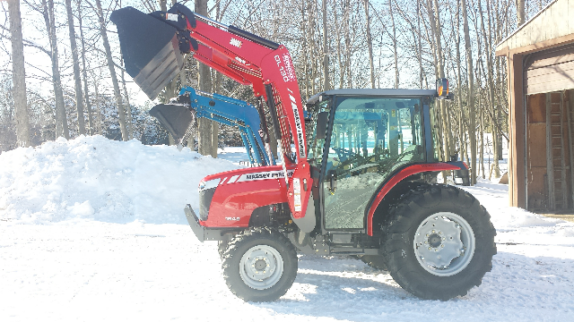

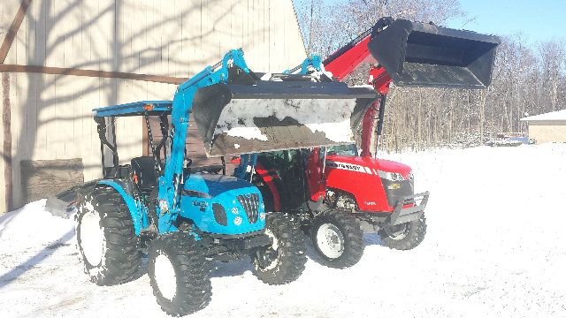

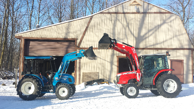

Here's a good example of the differences in loader characteristics of the 4047 & Massey 1648, direct "competitors" for nearly each stat except lift height. The two places I see the LS' loader could use improvement in getting higher, would be a longer lift cylinder (to get more vertical), and some changes to the SSQA mounting points ... they seem to stay "above" the bucket more than the others I've seen during dump:
Wow that really is a difference in height between the 2 / 3 of them. You really don't realize the difference totally by looking at the specs but when side by side it is really noticeable. But then like also said previously every tractor has the advantages and disadvantages I guess your comparison shown one. But I still wouldn't kick an LS out of bed (so to speak) for the difference.
   / Any XR 3037C or XR4040C owners here? #30
Yeah, LS really needs to step up with the loader on this model. They have the LOWEST numbers in the segment for lift height & dump clearance. Guesseral, I actually believe that YOUR loader is much better than the LS ones. I was looking at specs the other day, and it compares very favorably with the other tractors in this size (for lift height & clearance) even though the max lift weight is still right around the same as the LS loader. Too bad LS didn't use the loader that Montana puts on.
