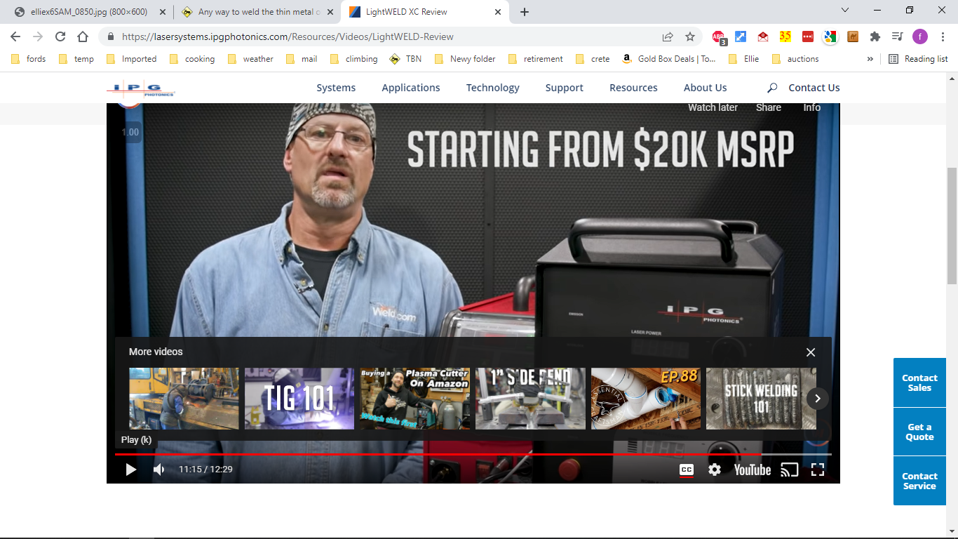

Have you looked into the new laser welders? They are supposed to do a good job on thin metals. Here is the link:
Starting from $20K MSRP.
