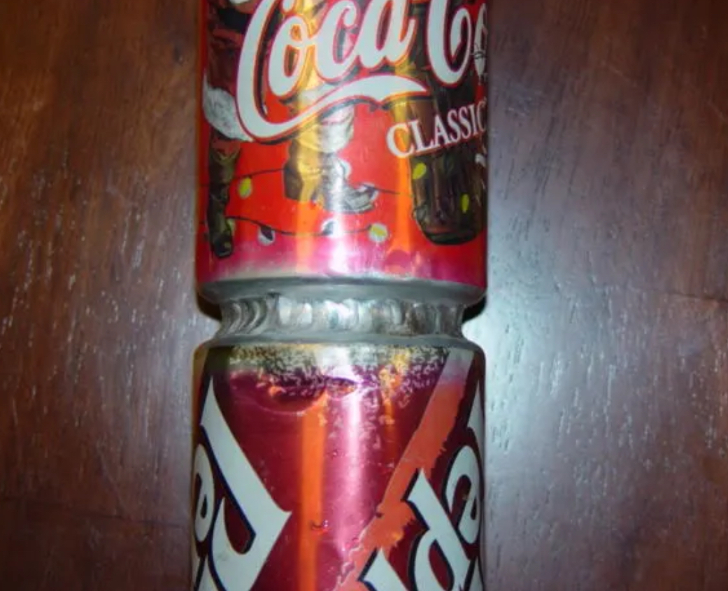

I typically weld exotic metals with TIG, mostly stainless. My pulsed MIG and the my SMAW (I own a Lincoln Ranger gas driven unit for in the truck are relegated entirely for ferrous welding) (not CI of course), that is 100% gas with the appropriate filler rod). TIG is inherently slow but produces x ray quality welds so long as it's done properly with correct fit up and the asthetics of the weld bead are also much better.
All processes produce xray quality welds, including stick. It's no harder or easier than any other process. It takes skill and understanding of what is going on to do it with any process.
