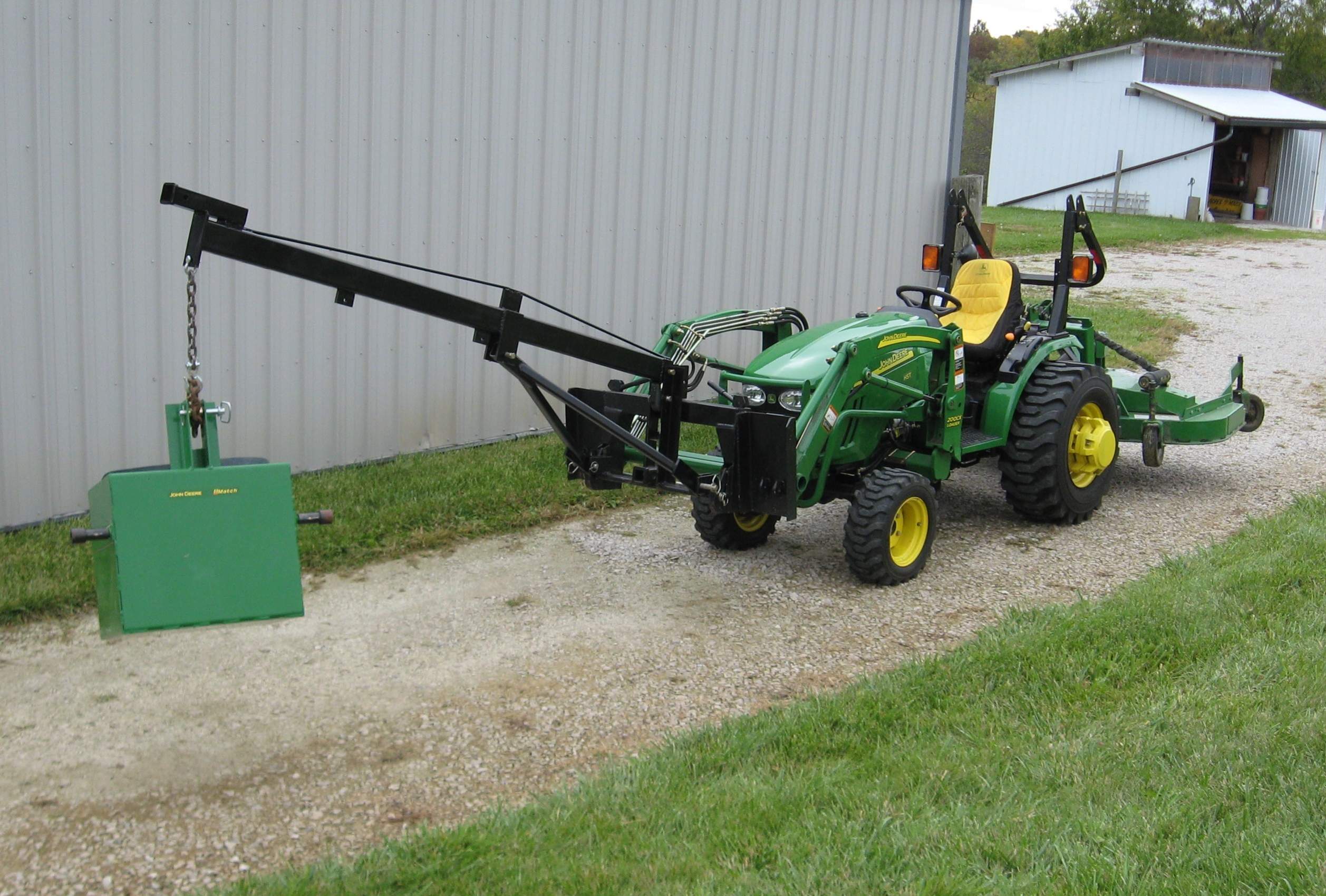

The geometry of the proposed lift makes a lot of difference with the front loader too. Mine won't lift the 430 lb weight box on the end of my 8 foot boom pole when it is straight out and halfway up, but will do it if I lower it almost to the ground and angle the boom pole upward.
To answer the original post question, I think the main use for the boom pole is to lift things when you need to keep them farther away from the tractor, like lifting a rear blade into a trailer or something. If you can lift it farther out, it keeps it from smashing the front of your tractor.

I'm forever finding things that weigh one or two hundred pounds that need to be placed beyond the reach of my FEL. I have a boom pole that replaces the forks on my FEL, gives me another 4-6' of reach..

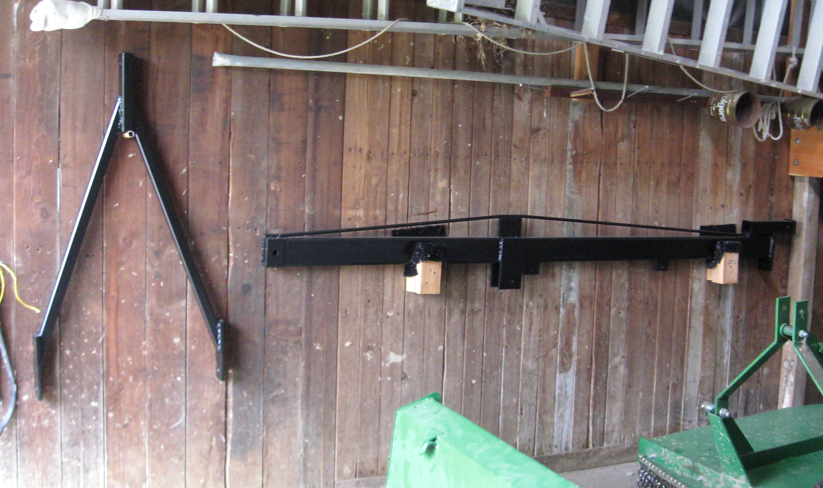

Thanks for the compliment. One of the main things I like about the design I used is that it breaks down and doesn't take any room to store.
The worst thing about it is that it's kind of heavy (not the boom itself, but when you add up all the pieces - it's probably close to 200 lbs) so it cuts down on the lifting capacity.
I'm really liking the one you have and have been thinking that some kind of extendable boom might be the best way to go in most cases because you don't really need the long one all the time and you can't lift that much weight way out there anyway.
