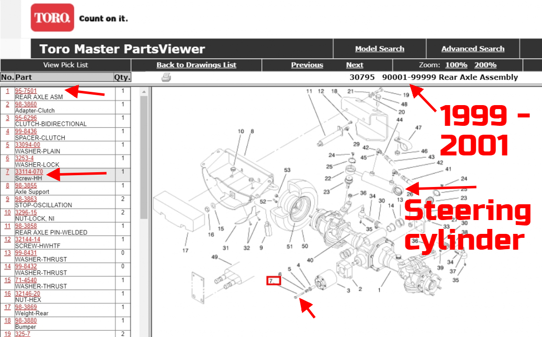

Is the steering cylinder behind the axle like this?
The 1998 drawing is for the one-way clutch, (Edit: Not true, it is the Bi-Directional clutch.) here is the # 30 you mentioned.
Right click and open in a new tab to see it bigger:
If the steering cylinder is at the back, you need 1999 through 2001, with the bolt:

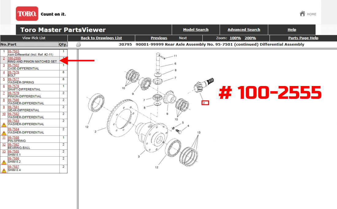

Part number 100-2555 for the matched gear set:

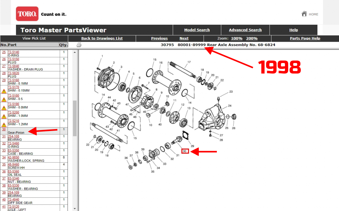

The 1998 drawing is for the one-way clutch, here is the # 30 you mentioned.
You need 1999 through 2001, with the bolt:

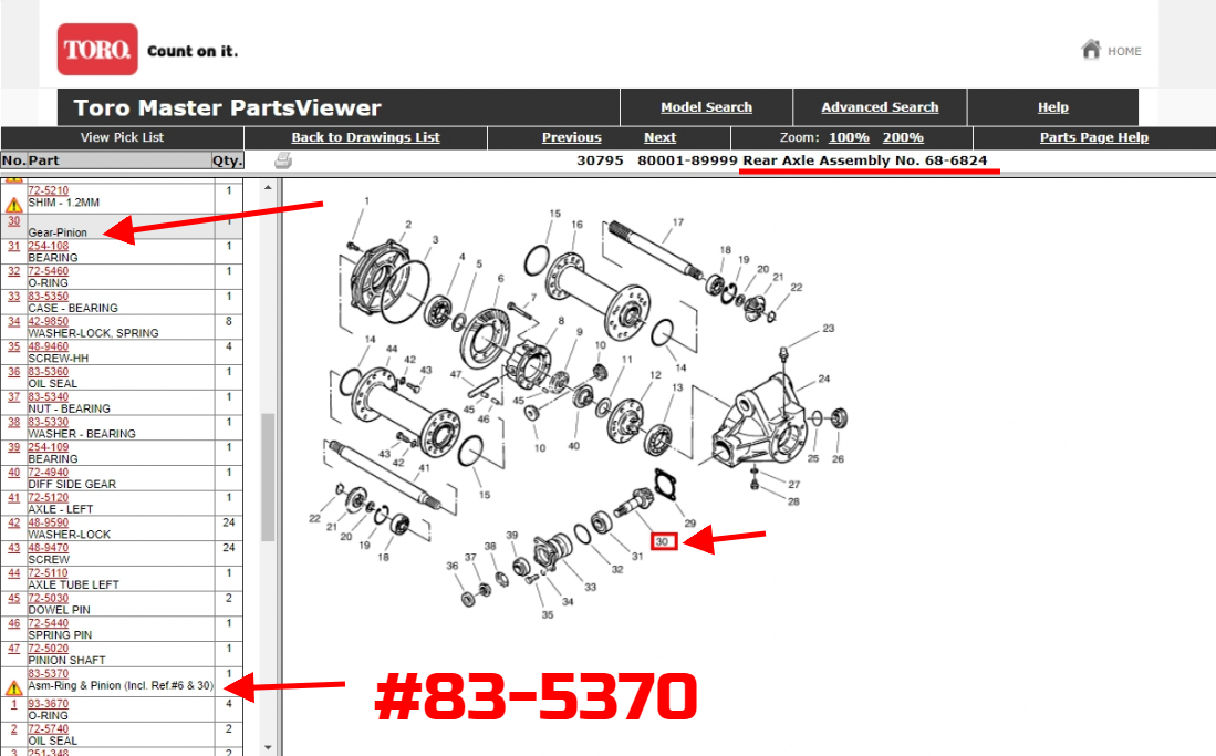

Did some more research. If the steering cylinder is on the side, further down the 1998 list it shows # 83-5370 for the gears:

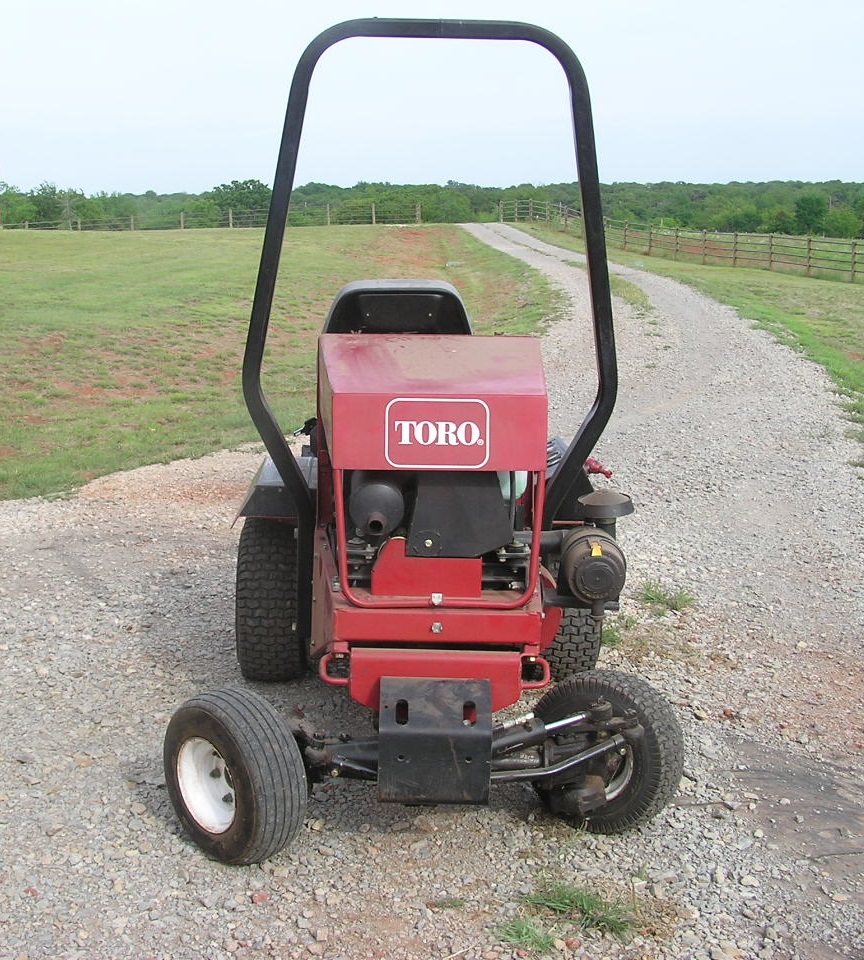

The older one-way clutch was clamped to a longer pinion shaft:
Sorry for the blurry picture of my 1996 325D:

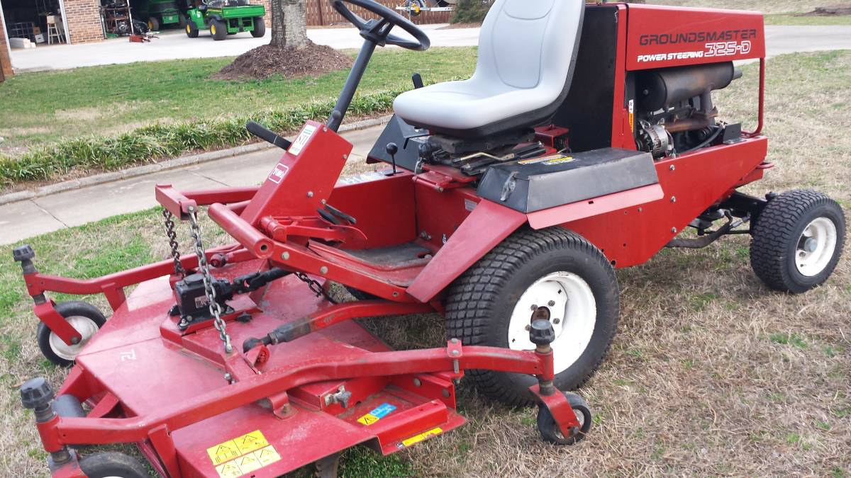

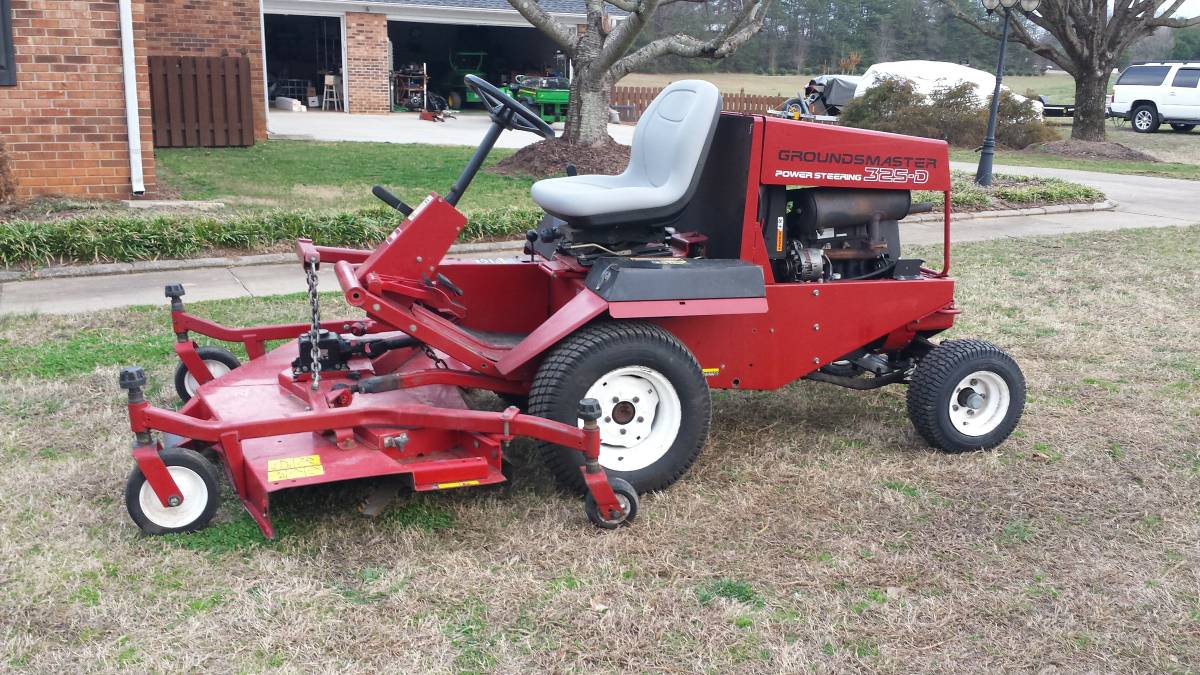

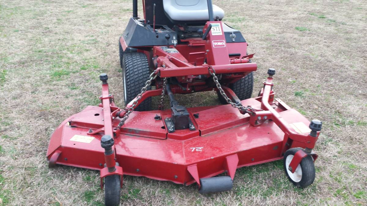

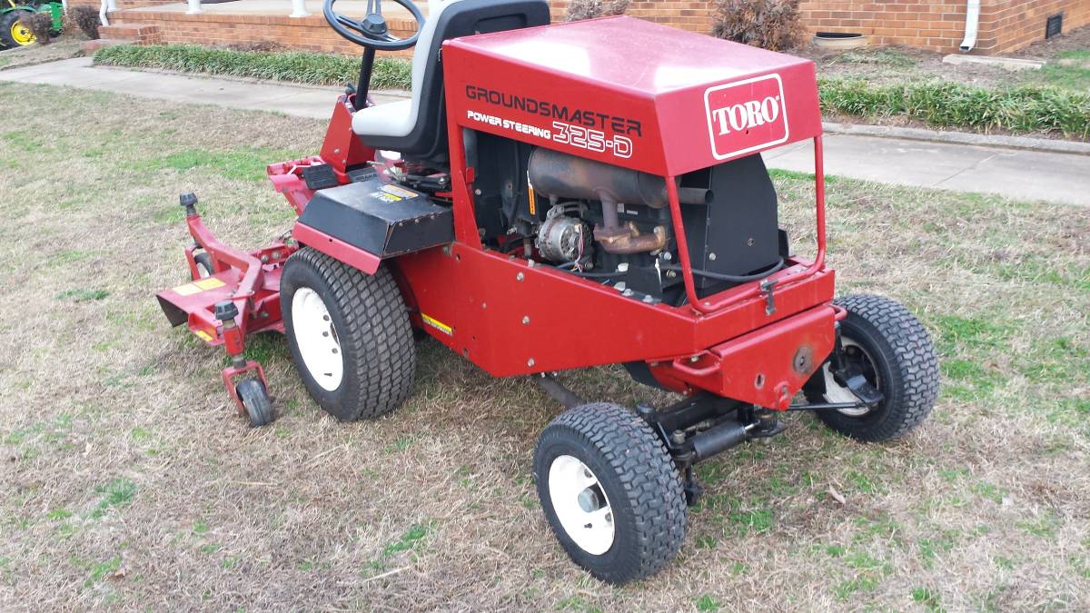

Just saw this thread...
I'm traveling 85 miles tomorrow to look at a 325D...
I hope to bring it home...
Here are the pics...
Owner states 455 hours and A+++ shape...
Any input would be appreciated...

If it's a bargain, nab it. These Toro's seem to be pretty well made. For us they are also very comfortable to run. I had a Kubota GF1800 and nobody liked running it. I wish I had it back now because I need something with a narrower deck. But it was not near as comfortable to run.
What year is it?
Find all the grease zerks and grease it religiously.
Honestly, after getting into the 325D that I am working on, it would not be my first choice.
Way to many important grease zerks. I do not like the way the glow plug indicator works. I like a glow plug controller that turns on a and shuts off automatically. I don't know if that's available on Toros.
But for a low hour machine at a decent price I would be all over it.
what kind of price are you looking at?
I run bio or a lubricity additive on all of my diesels

455 hours. I can get it for 3k. Not a smoking deal but OK.
