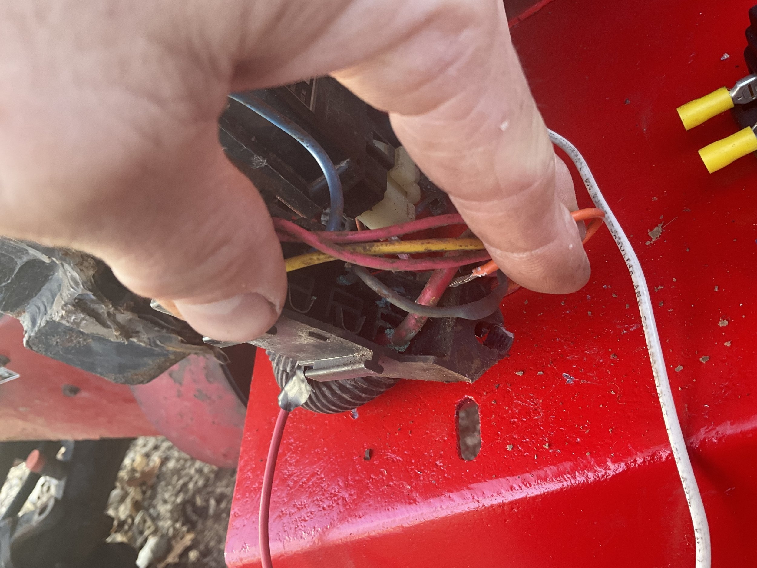

you should be able to run power to the starter solinoid and the motor should crank, if similar to the one I have the fuel shutoff is normally open so it will run, when you turn the key off the fuel shutorr engages for a short duration to shut motor down at which time it releases.
   / any toro groundsmaster fans on here? #1,012
I had a similar issue on my 220D.
I don't know if you know or not, but the glow plugs also come on with the key in the start position.
There should be no problem using a momentary switch to engage the starter solenoid
   / any toro groundsmaster fans on here? #1,013
A new trigger wire and momentary switch did the trick. I really wanted to tie it into the key switch but I couldn’t make that happen. It took 5-6 cranking sessions of about 10 seconds each. I saw smoke at the first try so I was confident I wouldn’t have to bleed the fuel system. It starts easily now. Thanks for the suggestions.

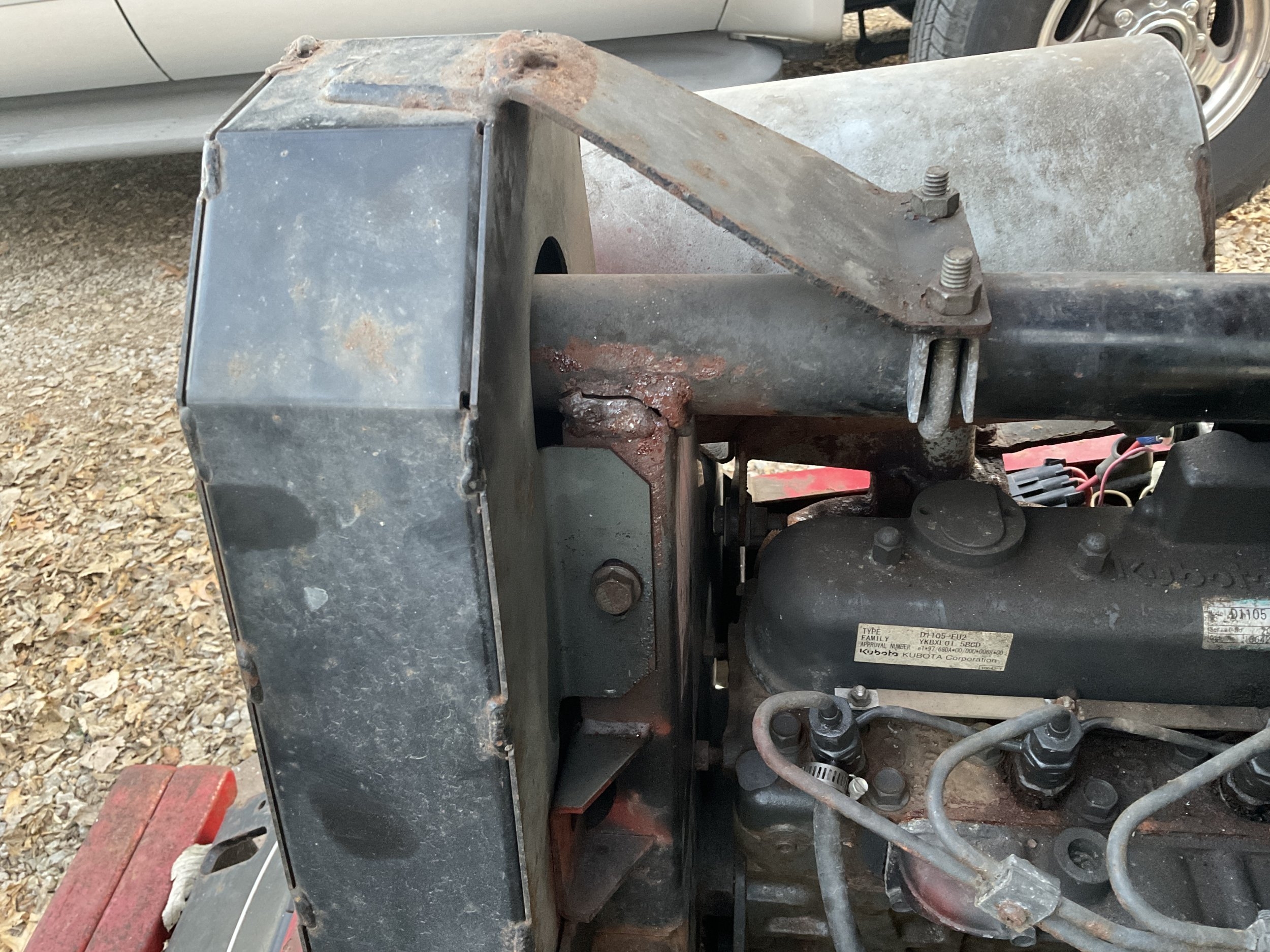

I do have a cracked weld here. Has anyone else had that spot break? It rattles bad that’s on my to do list asap. It looks to have been welded/repaired there before. I’ve had bad welds before maybe that’s all it is.
   / any toro groundsmaster fans on here? #1,014
yes just grind it out and reweld easy job cover the motor best you can from any spatter

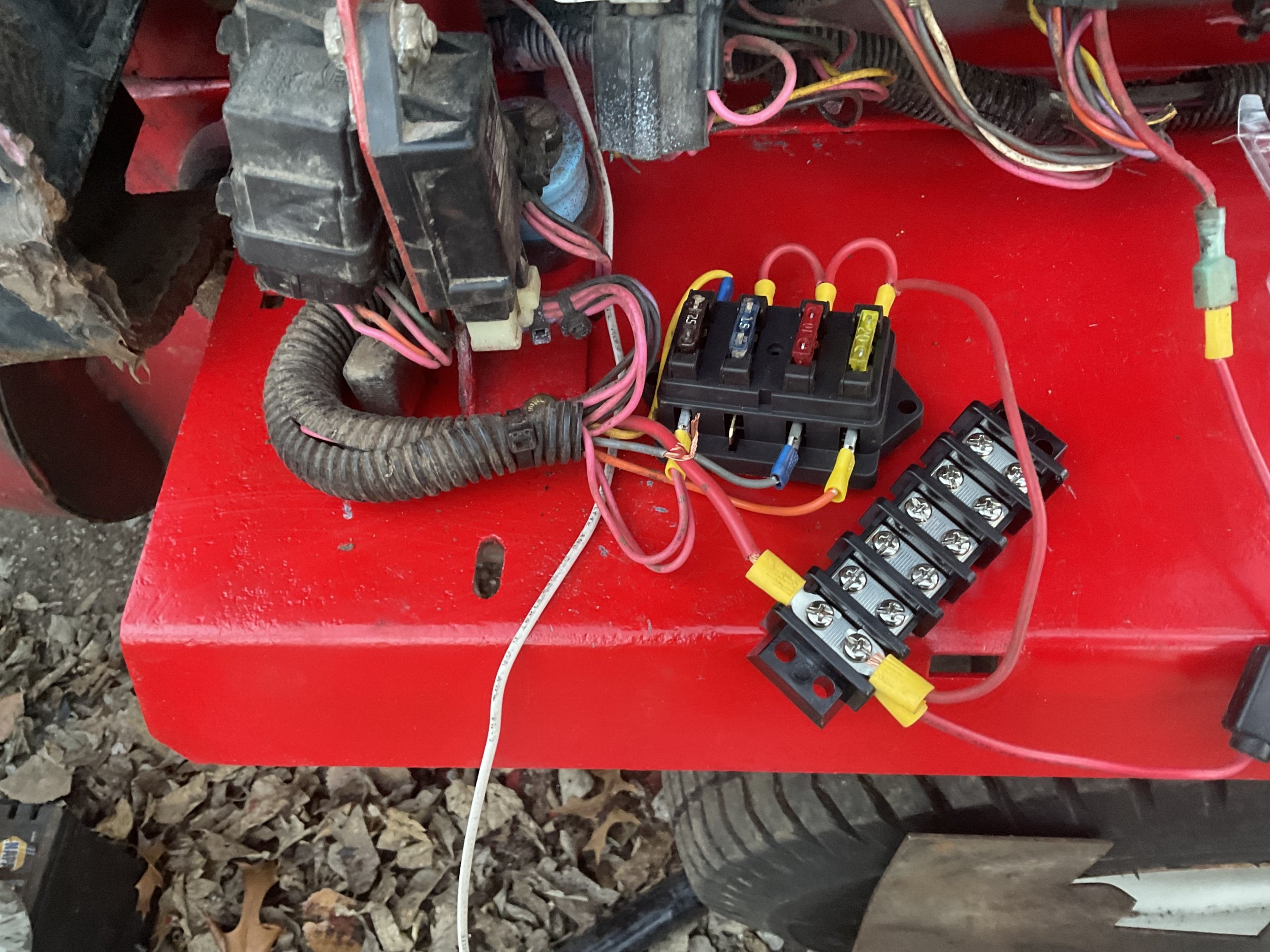

Some progress.
I ran the trigger wire. Welded the spot. It would start consistently. I was confident about the wiring now. I cleaned and painted the plate under the control panel and replaced the fuse block. This area was nasty from being a mice cocoon. After that my fuel pump was mia, no 12v at the plug.
So this is my question. I had a few no starts, or start and die immediately. I do now have the fuel pump working but it still starts and dies fast. Do I need to bleed air from the fuel system? Should I be treating this like it ran out of fuel?

The fuse block was nasty even after cleaning it. Wires corroded and falling out.
   / any toro groundsmaster fans on here? #1,017
my machine has a fuel shutoff solinoid that is normally open, when you start machine fuel will flow when you shut down the solinoid is activated for a short time to kill the motor, after that delay it releases,
a bad starter switch can cause the fuel solinoid to activate when the keyswitch is released fron start to run, check if the solinoid is closing when it dies

Some progress.
thanks again for the help
All diesel engines should have the air bled out of the fuel systems.
Air is hard on injection pumps and injectors
