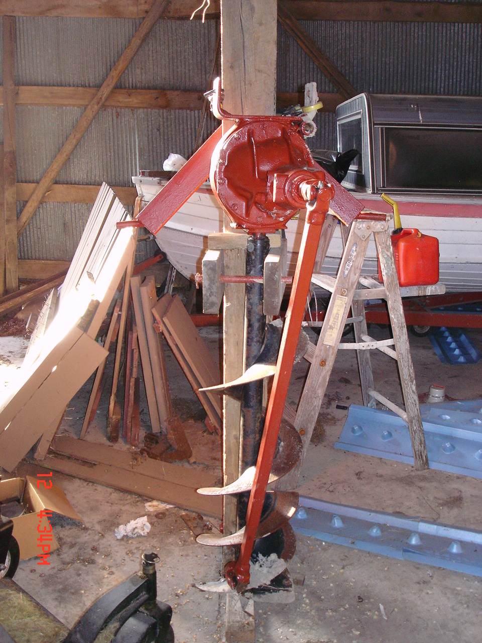

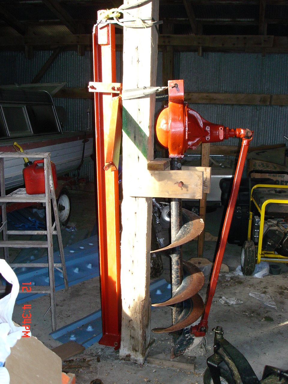

I too struggle with the heavier implements outside. But the one that USED to be the hardest is now the easiest - my post-hole digger. It hangs by a chain from the ceiling and is easy to swing around now. All I have to do is get close and hookup is minutes.
   / Any tips for 1 man implement hook-up? #23
I agree. My PHD was a real hand full. This is my solution. I store it standing against a post. The pin that attaches it to the lift arm serves as a safety just in case the nylon strap rots or breaks. I just mount the lift arm on the tractor, back up to the PHD, pull the pin out of the wood bracket and slide it into place. :cool:

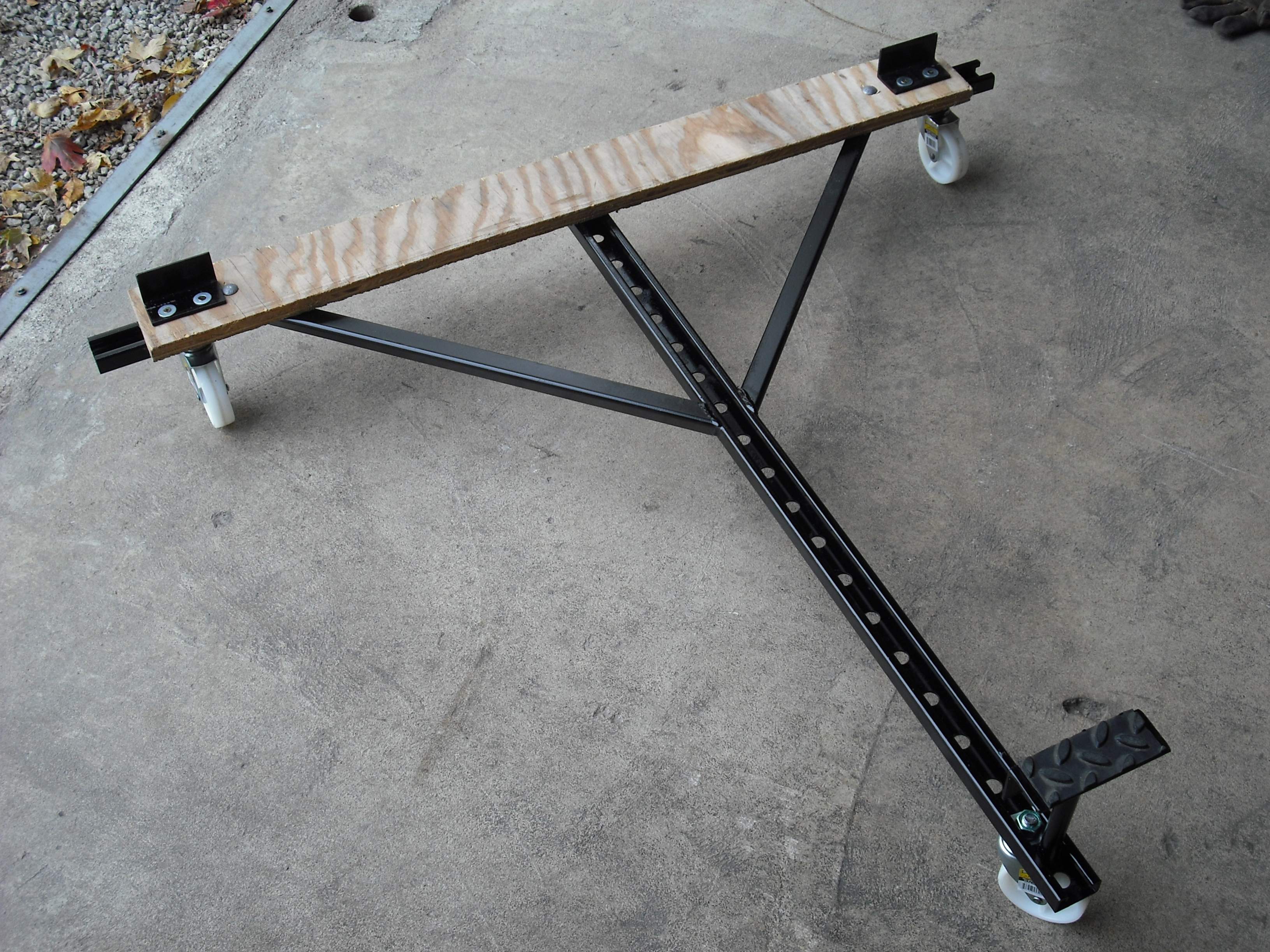

I will give my nod to the HF quick hitch. I bought one on sale for like $50 and its been great.
Another thing to do is if you have a concrete area to store them on is make dollys for everything. We make them out of cheap caster wheels and 2x4's. For example for a 5' Bush Hog get 2 8' 2x4's and 4 casters. Cut the 2x4's the same width as the implement plus a few inches. So in this case maybe 66". Now attach the remainder of the 2x4 to make a rectangle then put on the casters. You will end up with a rectangle 66"x30". Set the Bush Hog on it when down and detach then push it off to the side of the barn until the next time to use. I have made many of them and they usually run about $12 each with some HF $2.50 casters and some lumber and screws I have laying around my shop.
Only picture I have is the one I made for my snow plow. I made it out of steel but gives you a idea. This one cost me under $8 because I had everything but the casters laying around.
