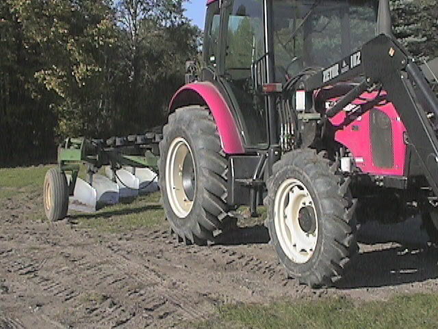

I'm thinking about buying a used utility tractor (2wd), that could pull a 4 bottom plow. Looking at anything in the mid 80's to low 1990's. Could care less about color or brand, just so it has a reputation for reliability and low maintenance. I've looked at the International 1086's and 1066's but they are a bit bigger than what I need.

I have a 4x18 on land JD 3600 plow. Pull it with a 55hp pto Zetor MFWD. Managed to knock a moldboard loose last Saturday. Could probably go with a larger plow or smaller Zetor to prevent damage.:D Dirt cheap, simple & tuff as an anvil.

Thanks Barry for the picture and response. I don't see many Zetors for sale in this area.
