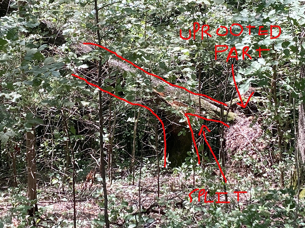

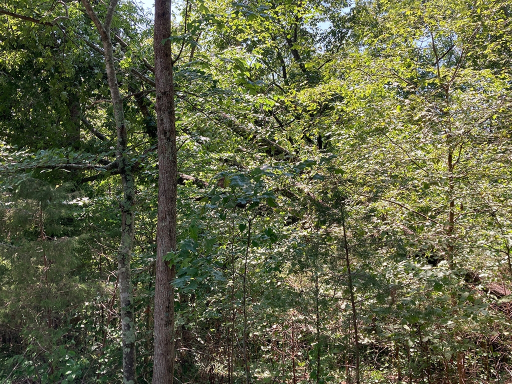

Had some bad storms the past couple of days with strong winds. Thought we did okay with just a few small trees damaged (top broke off a small tulip poplar, a small oak got uprooted). But found this guy today right at the edge of our woods.
Not 100% sure on type of tree (elm?), but it's not anything I've encountered before -- it's 2/3 of the way over, with a break in the trunk -- 1/3 of it uprooted, the other 2/3 is still in the ground. The canopy is hung up on other trees - not sure if that hurts or helps.
I'm thinking to cut off the uprooted part first, but beyond that, not sure where to go. It's a large tree - maybe 18-24" dbh, so a lot of weight/energy to worry about, and not sure I can get over top of it to make a cut above the split.
It's close enough to the edge of the woods I can clear a path to get the tractor to it, but I can only see that helping skid it out once down.
Thoughts/suggestions? I do have a big enough saw for the job (Stihl 462)

Be VERY careful, what I call a hanger and the trunk is under extreme compression. If that was on my land, I'd call a professional arborist and let him deal with it. That tree is just waiting to hurt you or possibly kill you if you lack the necessary skill to remove it. Don't believe your Kubota could handle it anyway. Lot of suspended weight there.

Gotta agree with 5030. It's doable but very dangerous to a rookie ( like me). Could maybe try pulling it off the tree? That's usually what I try to do

Yep, I've been staring at the photos this afternoon imaging all the ways the tree will try to kill me.
I'm sure there's something I'm not seeing, but I can't quite work out how it will go wrong if I start cutting through the part under tension on the split side of the trunk. Would the base of the trunk kick out? Given how far over it is, and hung up, that seems unlikely. What other devious ideas does this tree have???

There is a lot of tension in that split part considering the weight of all the top that is now leveraged between the top hung in the trees and the root ball holding the other end. That's pretty dangerous in itself. The split trunk could splinter in different directions. The root ball might shift once the tension on it changes. Lot of variables to predict.
Having the top hung in the top of other trees makes it that much more dangerous. If the split part somehow becomes free of the root ball, it is difficult to say where the hung up top is going to land, possibly bringing down other branches from other trees, too.
It all looks big enough that you probably don't need to be standing anywhere nearby when any of this lets loose. Nor would I try pulling it with a 20' chain.

Widow maker. Any way to get to the trees that are holding it up? Clear a path and try to get rope on the far end and pull it down with tractor? Neighbor has acres of woods with oak trees 1/2 down like this. Many up rooted 1/2 over on surrounding trees. All I see is many years of free firewood LOL. But I want to be around to enjoy the heat. Becarfeul

Depending on what species it is, it could 'barber pole', split up the trunk as you cut into it. Why take the chance, have someone else (arborist) cut it. Then you can buck it up on the ground and remove the canopy from the other tree if, it don't come out when the trunk is cut.
A couple hundred bucks is a helluva lot cheaper than you getting hurt or killed in my book. I quit cutting storm damages wood in our woodlot a long time ago. In my case because I sharpen chipper knives and grind saw chains for local arborists, all I have to do is call one and they come out and put them on the ground and I buck them and limb them and then the limbs go in my ever present burn pile.

It appears to mostly be a smaller tree holding it up at the moment, but no safe way to get in to cut it down (I'd be right under the hung up tree). I'm sure I can get a rope on it, but doubt I'd be able to get any movement with the tractor. Probably the safest thing to try though, so will see if I can have a go at it.

Absolutely agree. But also looking to learn and get better with a saw. This may not be the learning opportunity to pursue, but still curious to hear what folks see, what to look out for, etc.
