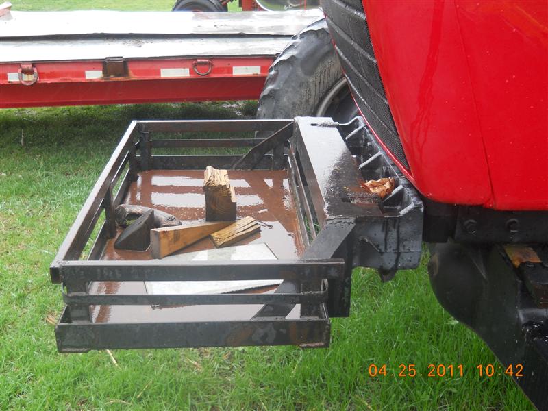

Has anyone built a stone box, sometimes called a rock box? Now I don't mean the big box for a counterweight on the 3-pt hitch, I mean a smaller box that bolts to either the front of the tractor or to the side to pick up the occasional rock from field work such as harrowing. Most boxes are small, maybe 16" wide by 18" to 24" long, are shallow and only meant to hold maybe 25 lbs of rock. You dump them at the end of the row.
Problem is I have weights on the front of the tractor, so I don't think I can bolt there and these smaller tractors don't offer a lot of other locations. Anyone else with any ideas or built one? I put them on my foot platform now and that's a bad idea. I'd like to make one for a Kubota MX5100 or similar.
Here are a couple of internet examples. Any help appreciated.

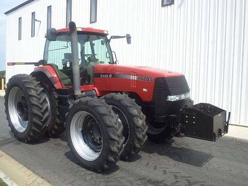

I'd like to see how the latch system forks on that CaseIH Magnum (bottom photo). I've seen those rock boxes for years, but I've never seen a good pic that shows how the latch works.
   / Any stone ( rock) boxes out there?
Here you go....they are commercially made and bring your wallet.
Weight Boxes and Brackets

I built one this last spring, I took off my weights, really did not need them on the front IMO,
I took 4 inch channel iron, and bolted on the side, and then extend it up about 20 inches in front of the tractor, welded two more sections of channel to form a front and back of the box on the front, there were two bolt holes one could fasten on the front and I used them as well, on the bottom I made a hinges plate with a latch that would (similar to a lot of swinging gates on stock trailers, so if there is a lot of weight there is little resistance on the latch, any way it will dump out the bottom, so one does not have to unload it,
the box is about 20 inches square, and 4" deep,
I run up to the rock pile and get out and trip open the bottom and back off and empty the box, and lift up the bottom and latch it, and off I go, do not have any pictures of it that I know of, may be able to get one over the week end here,
