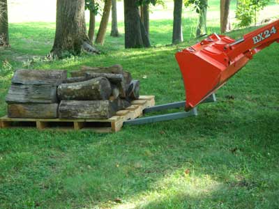

The B7610 FEL has a lift capacity of about 700 lbs. I'm wanting to get a Piranha for it AND pallet forks. Bxpanded doesn't sell forks to fit for the B7610. I kind of like the concept of the "hanging" pallet forks.
Is there another mfg that makes that that type of fork?

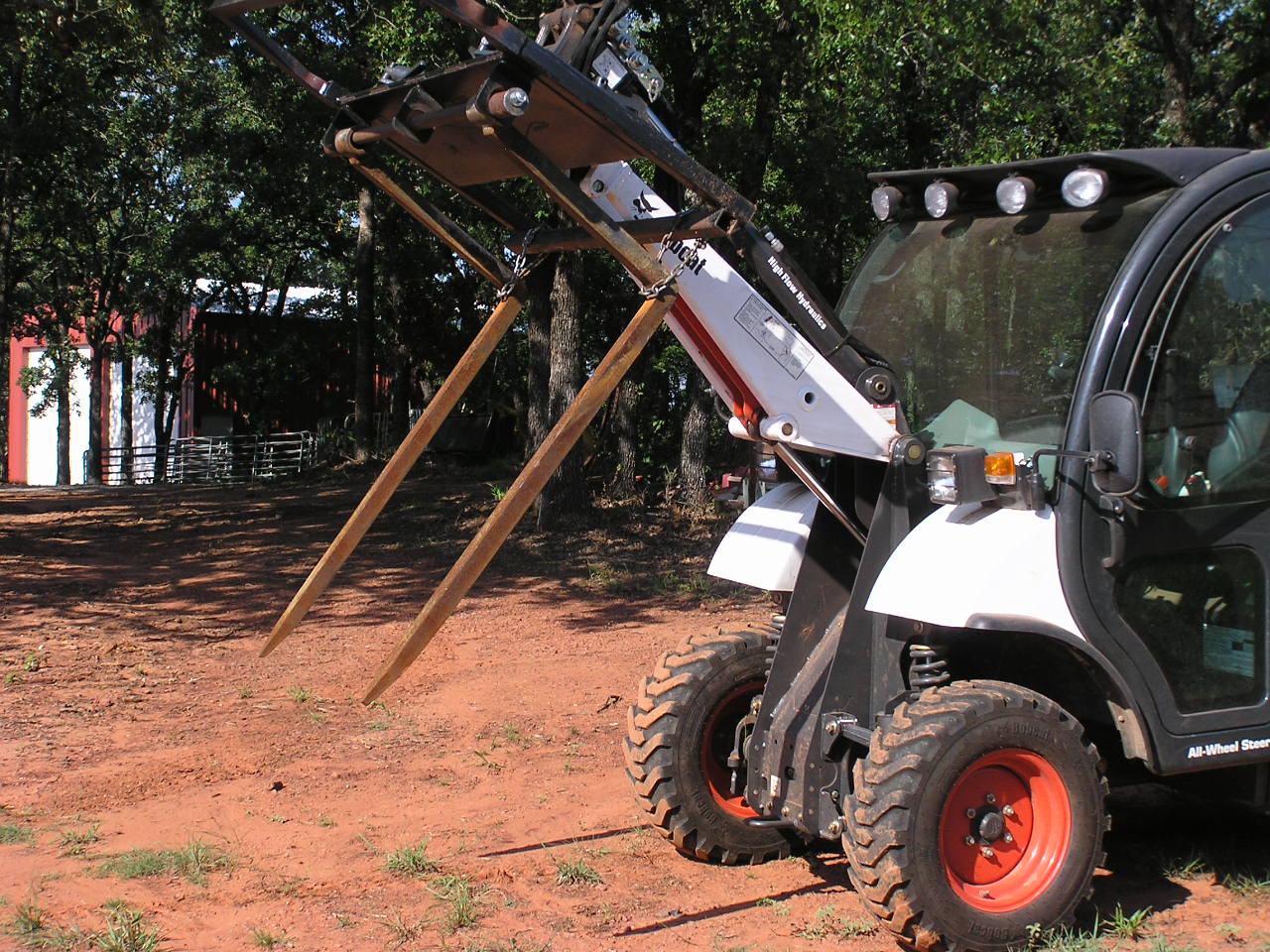

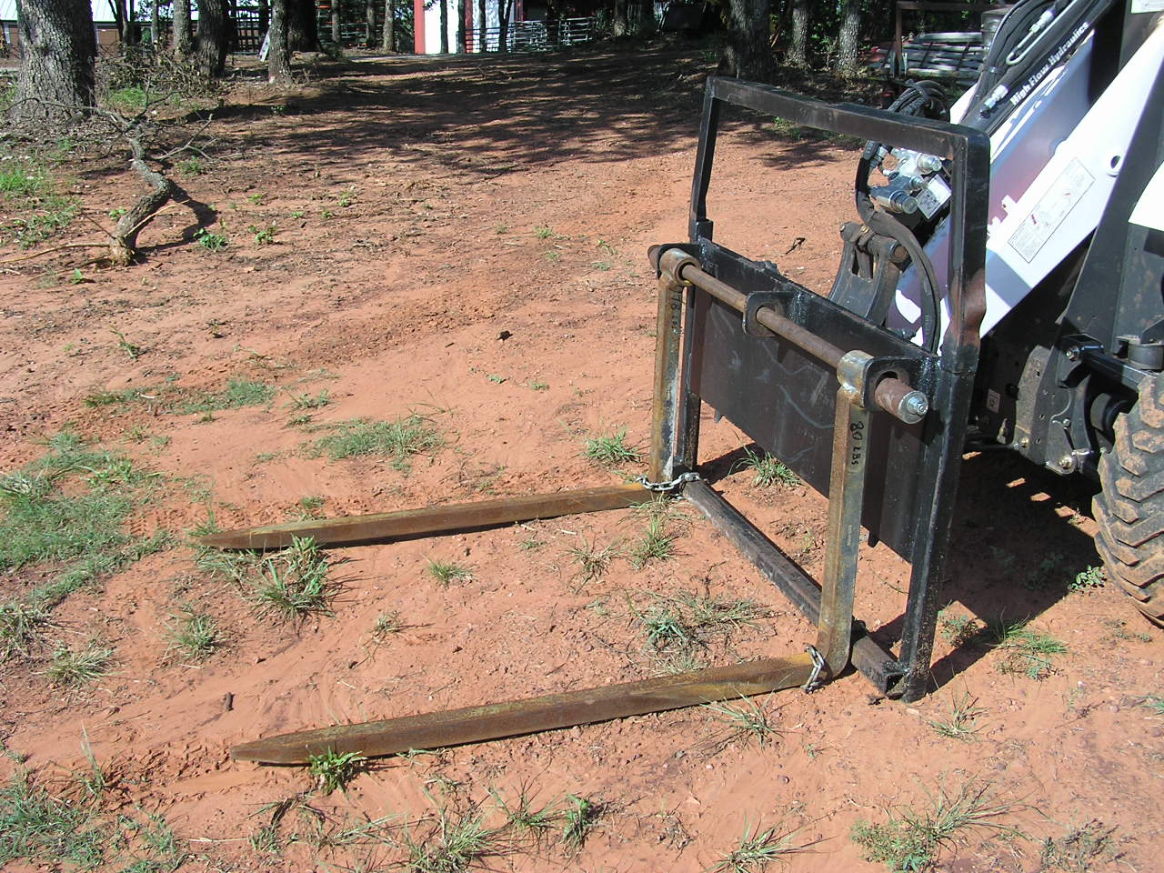

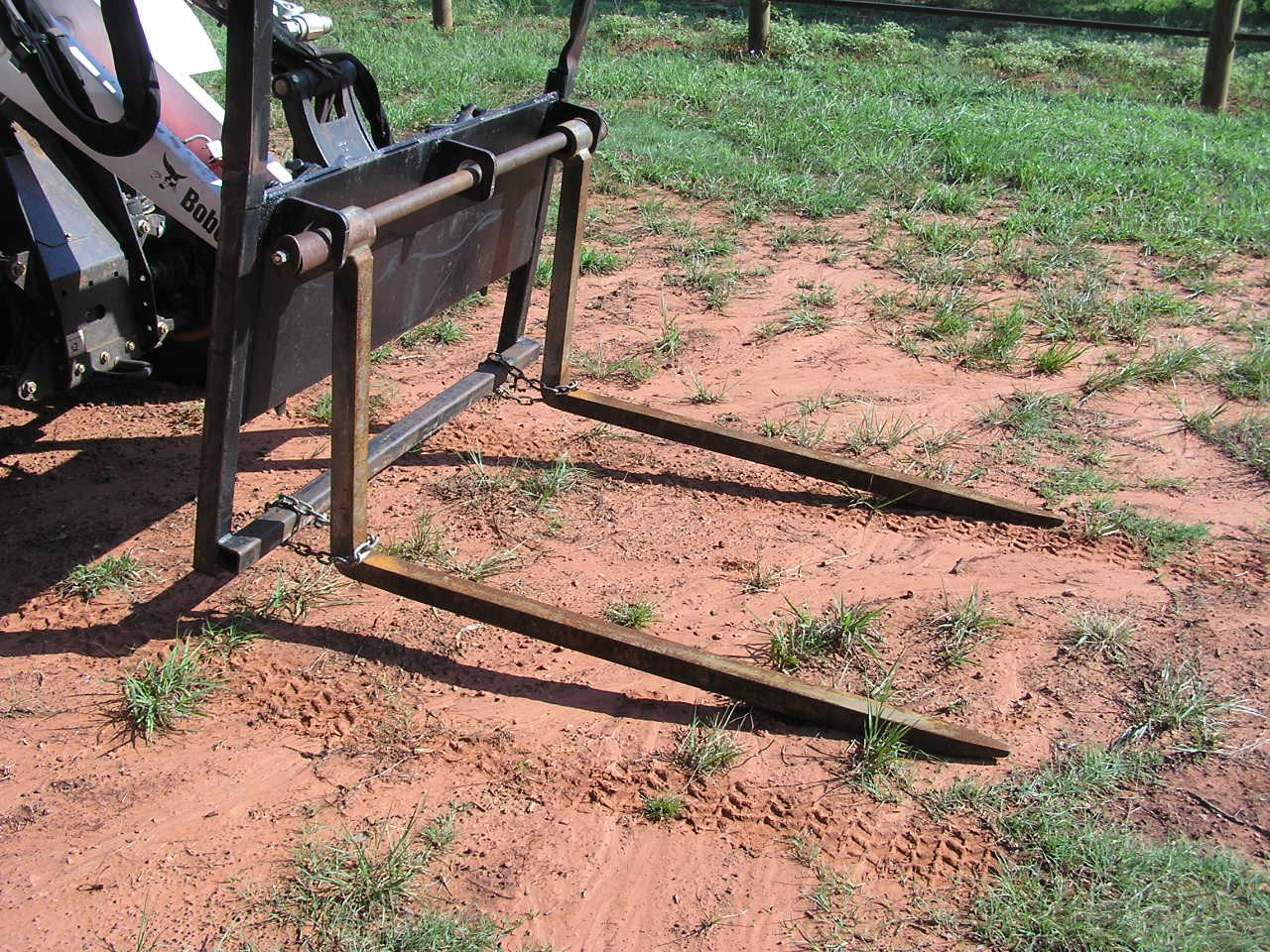

Is this the type that you are looking for?
Found them on eBay, 48" pin mount block forks. I already had the frame, it was made by a local company.

No, I don't think the lifting capacity will come unfastened.
And if you meant LOSE capacity, part of the reason I wanted the Bxpanded style was that they were only 45 lbs/pair. I presently have a pair of 48" Titan's clamped on and they work, but weigh about 100 lbs.

I had an old set of Wifo forks of that type. I'm sure that the OP has his reason for wanting that style, but they weren't cutting it for my use. If I wanted to tip a pallet or otherwise tip the load to have it slide off onto the ground or into the truck, it wasn't happening. Same thing if you need to approach something at an angle, with the fork tips lower than the carriage. If you needed to pick a large rock out of the ground, for instance.
Take a look at this picture, notice the chains that allow flexibility on uneven ground and dump angle.
It looks like the Bxpanded forks are rigid on the bucket.
