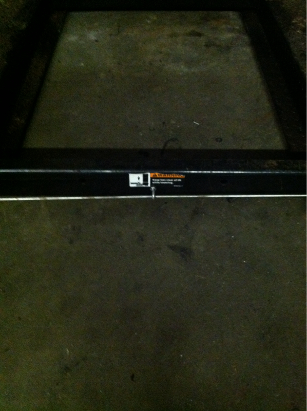

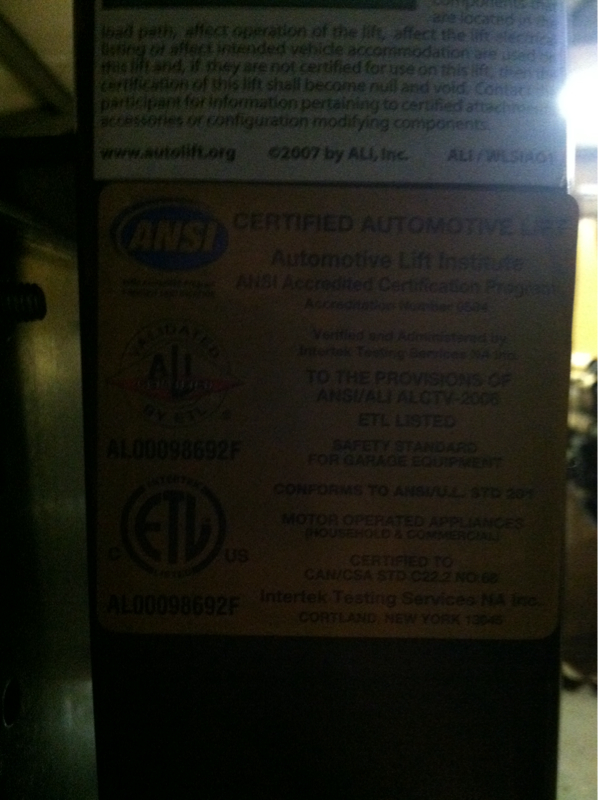

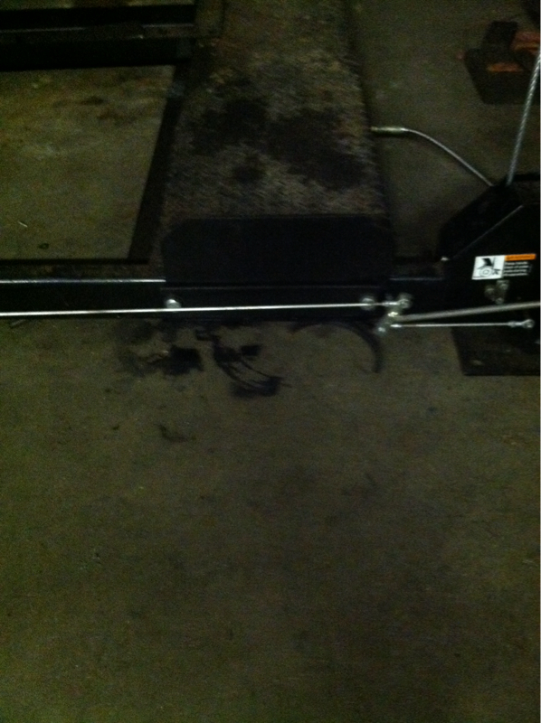

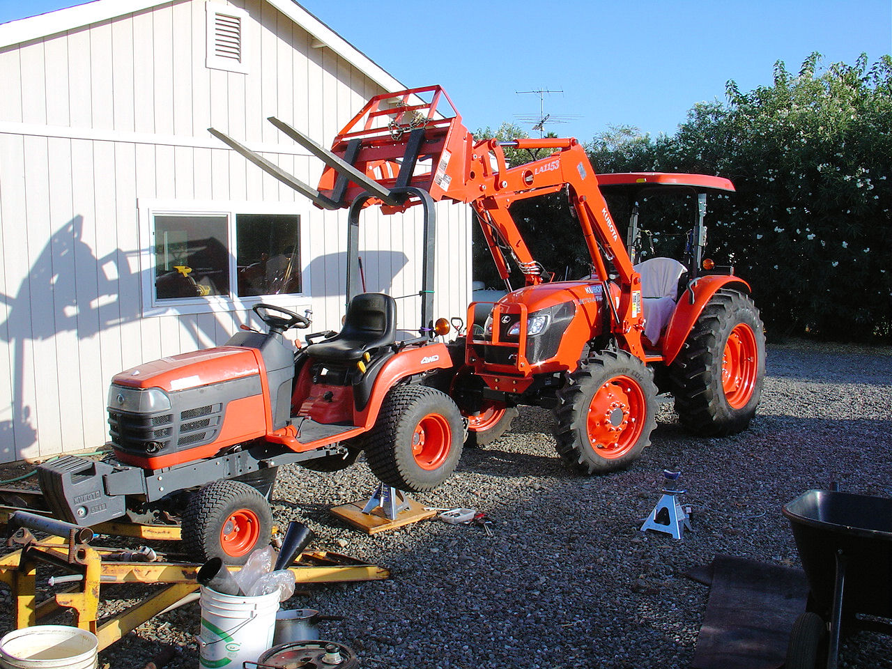

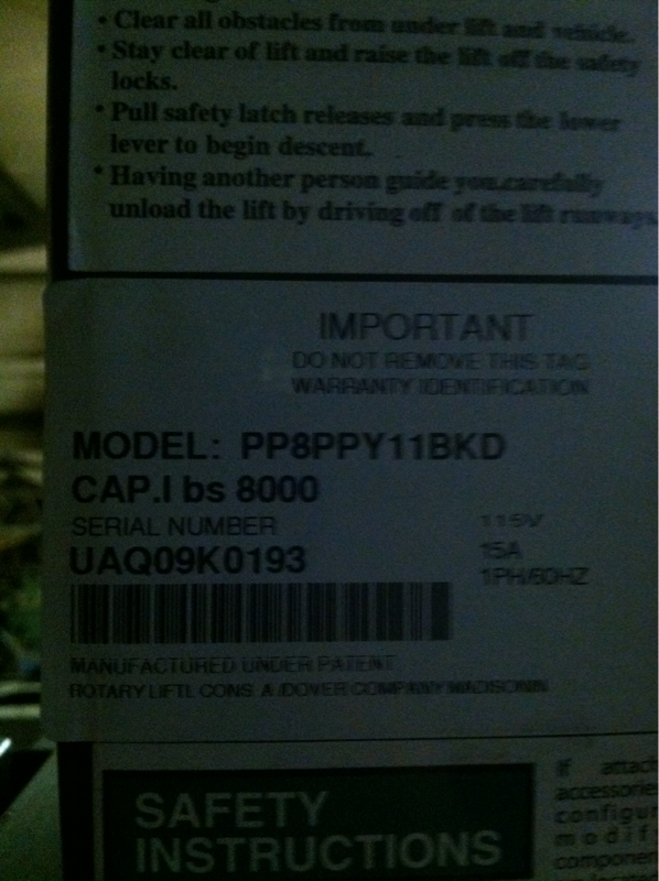

My lift can slide within about 18 inches of together. Plenty close enough for a BX. I'm sure it is stronger farther apart, but heavier vehicles tend to have wider wheel bases. You have to unbolt the ramps and slide them over to the next set of holes. I wouldn't worry too much about weight distribution. It is rated to hold 4,000 pounds per half. Lifting a 5,000 pond tractor with 70/30 weight distribution shouldn't hurt anything. image-706509802.jpg image-706509802.jpg image-629809612.jpg image-2771581115.jpg image-3443962315.jpg
