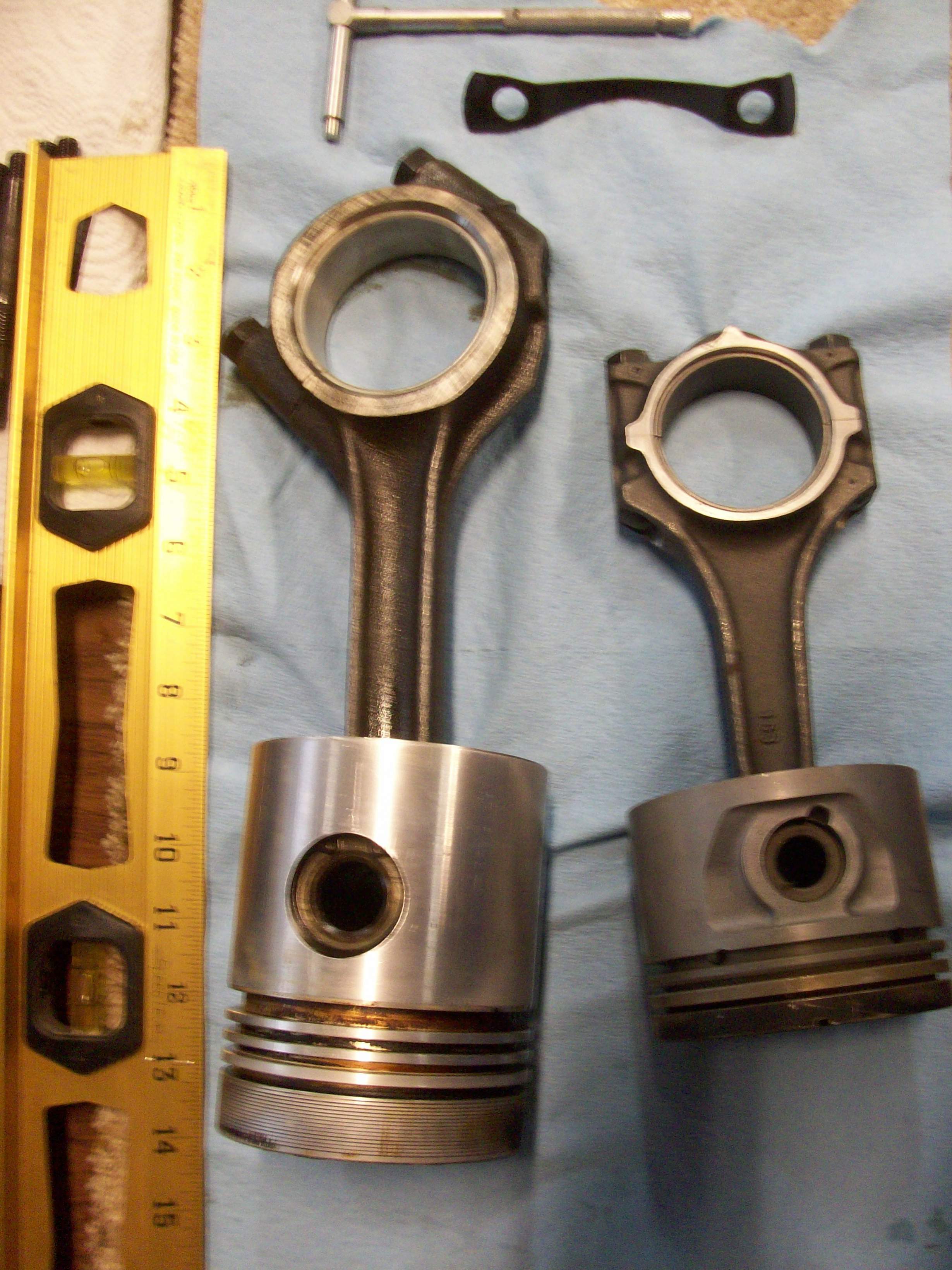

:D my 554 diesel tractors piston/rod vs. my boats Volvo OHC gas piston/rod compare this way...
Both will run at rated power for a very long time- one at @ 5000rpm @ 9:1 130 hp 130 cu inch
the other @ 2000rpm @16:1 and (only) 55 hp 203 cu inch guess which one is the 55 hp diesel :laughing:
I like the HD low rpm diesel design for tractor work. the gas version works well for a boat engine that needs a much wider RPM operating range
