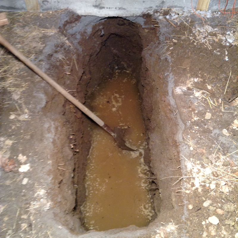

The frost line is pretty shallow here. Most water lines are about 18" deep and as shallow as 12".
Lucky you. This is hole is to access the hydrant valve for the pipe that pops up about 1ft inside a slab. It's 4ft deep and still froze last winter. About three evening sessions of digging for about 1/2hr each.
Do you have heat in the building or will you need an underground hydrant valve, heat box, etc.?
