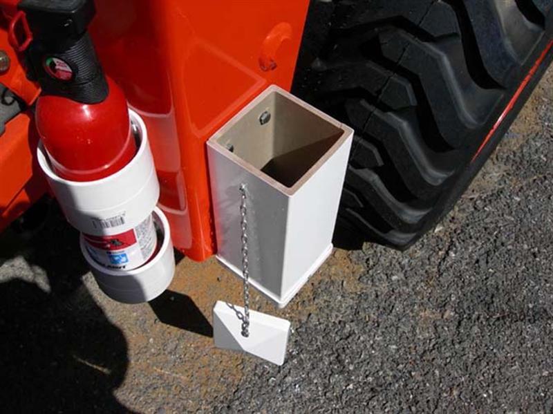

My Kubota L5030 has a long, thin toolbox behind the seat. But I bolted a piece of square PVC fence post to one of the FEL uprights and use that for holding a chain. That leaves more room in the toolbox for other goodies.

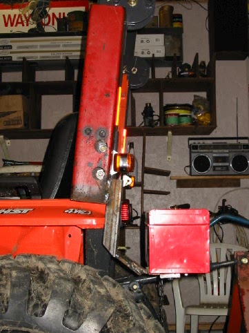

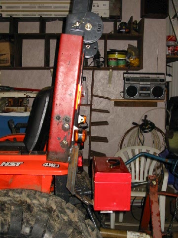

These pics are of mine. The actual bok was $15 at Lowes. The frame is old bed rail.

INTERESTING.At work during our annual forklift training we are taught not to mount and dismount on the side where the controls are so you dont hit them ,catch your clothes etc.That being said I automatically apply the same safety rule at home ,i only get off on the left side.SHVL73 has placed his box where I never thought of...Where i dont get on and off anyway.I think i just found a new local for my chainsaw holder,and chain holder.I dont need a tool box because i own a KUBOTA:D :D :D

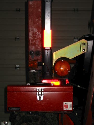

Here's what I did on my B7800.The 4 x 4 x 1/8" square tube bolts on using the ROPS mounting bolts and the top 16" or so is a chain box. The bracket to hold the tool box is welded onto the square tube. The ROPS can still be folded down and I can still reach the chute rotator on my snowblower.

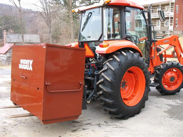

I added several tool boxes to my L5030. First, inside the cab on the right side there is a window with tapped fitting that I used to install a Rubermaid plastic container, with top, using bolts. Also, have hung two small plastic buckets from the rear side window hinges to put things in. Finally, I have a carryall on the 3 point hitch which holds a truck tool box and can carry larger stuff.

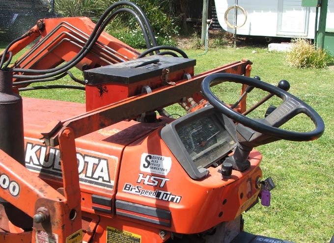

Don't put it too far out of the way. Mine is right in front of me. It doesn't obstruct the view and its really handy for the things I have to put on or take off just about every time I use the little beast.... sunnies, gloves, drink bottle, tin can (off the exhaust), sunblock, WD40, bandaids, etc. And a few tools too of course. Its like having one of those old sedans that had a nice big useful dashboard where you could sit everything in easy reach. :) I see you have a cab, so something like mine might not be suitable, but can you build a handy tray across the bottom of the windshield?

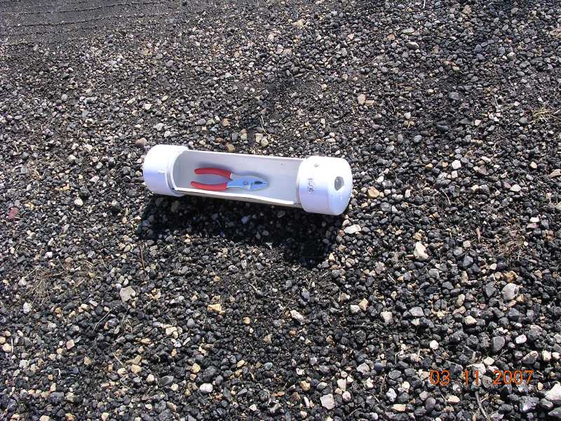

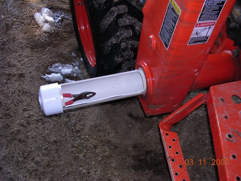

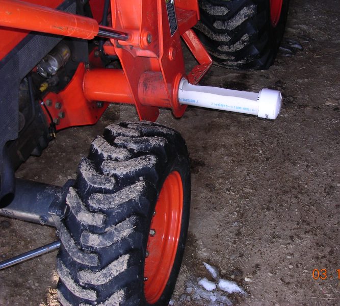

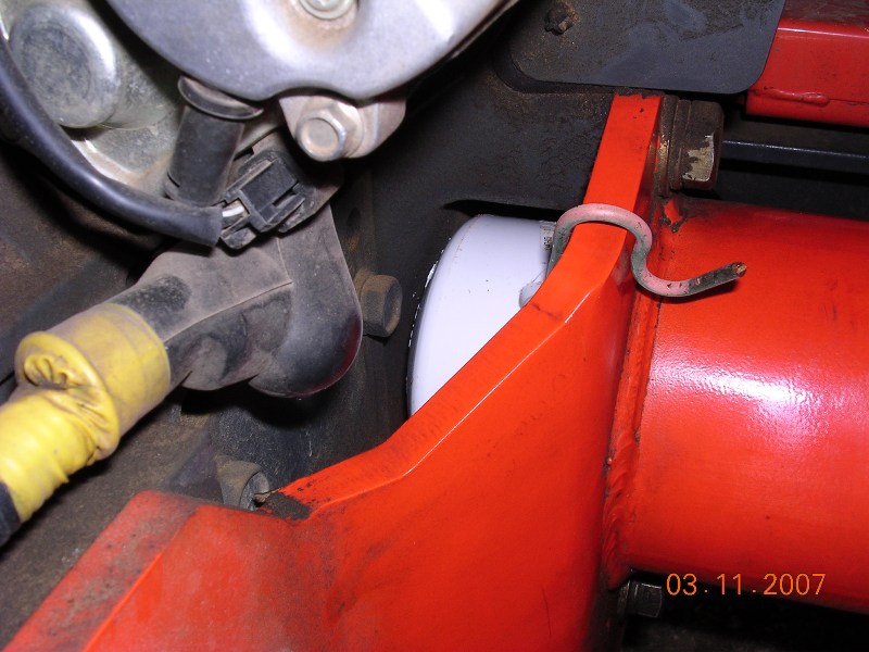

Like someone said “you don’t need much of a toolbox if you own a Kubota” so I made a small one.
Three inch PVC with end caps just fit in the FEL frame on my L3400.
I made a cutout for tools, put finger holes in the ends, and a hole for pin to keep it from falling out.
Hopefully I have figured out how to include pictures.

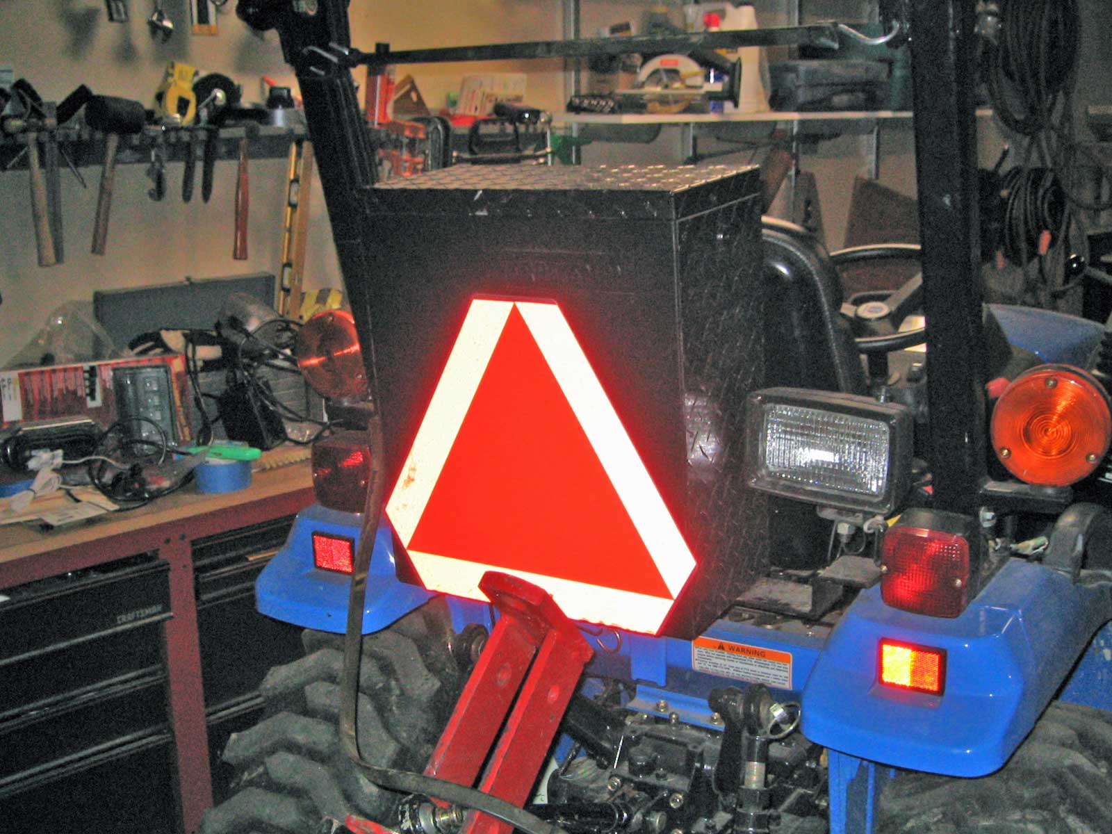

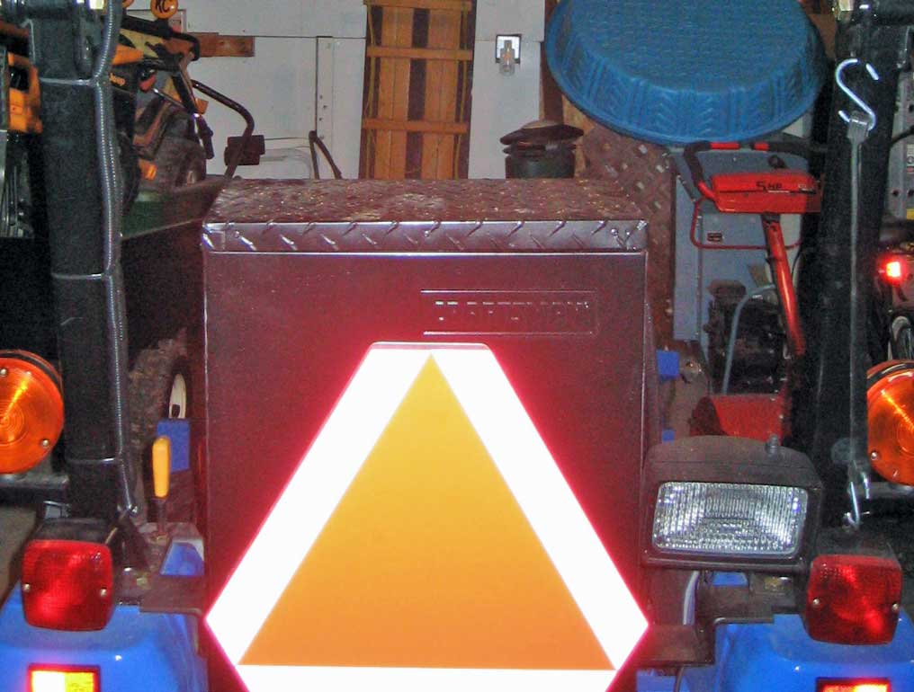

I used a Craftsman Pick Up Truck box. Made a custom mount that used the ROPS based bolts to hold it in place.

Shvl73,
Can you advise the Logo Name on the front of the Lowe's Tool box mounted on your tractor. Thanks.

I'll get it when I get home Friday, if I don't get to a Lowes this week.
