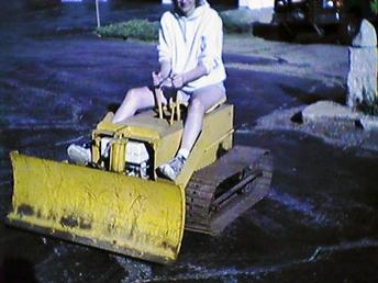

These are not home made, but started off as a kit from Struck corp.
I have a model in between these two. M1800 They are geared so low, that in low gear, you can get off ,eat lunch and and come back and they only went about 20 yards.
Mine is gas and transmission, the newer ones are hydraulic, and they cost as much as some tractors.

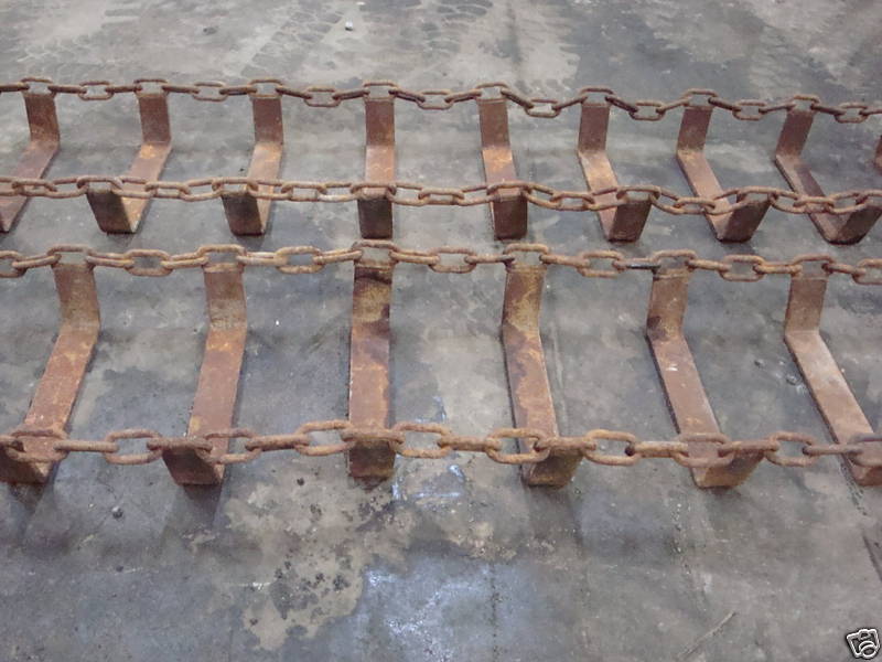

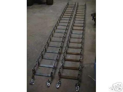

Why not make your own tracks. Looks pretty straight forward. Build them using dimension of half air in tires. When built, slide them on and inflate tires to tighten up tracks. You would have to lock your steering if putting on a garden tractor. I have a set for my skidsteer, but have not put them on yet. You can order a complete rubber or steel set of tracks for different skidsteers.
Any skidsteer tracks I've found are $1000 per pair used. That's out of the price range. The tires idea is my first choice. My plan is for an 8 foot long vehicle. The track would have to be over 18 feet long. That's a tire with a 6 foot diameter. Any tires I've found that big are so wide that they would overwhelm the rest of the plan. I may need to use a few tires per side and connect them with piano hinges or something. I'd still like to have something with a more positive engagement than rubber on rubber, though.
