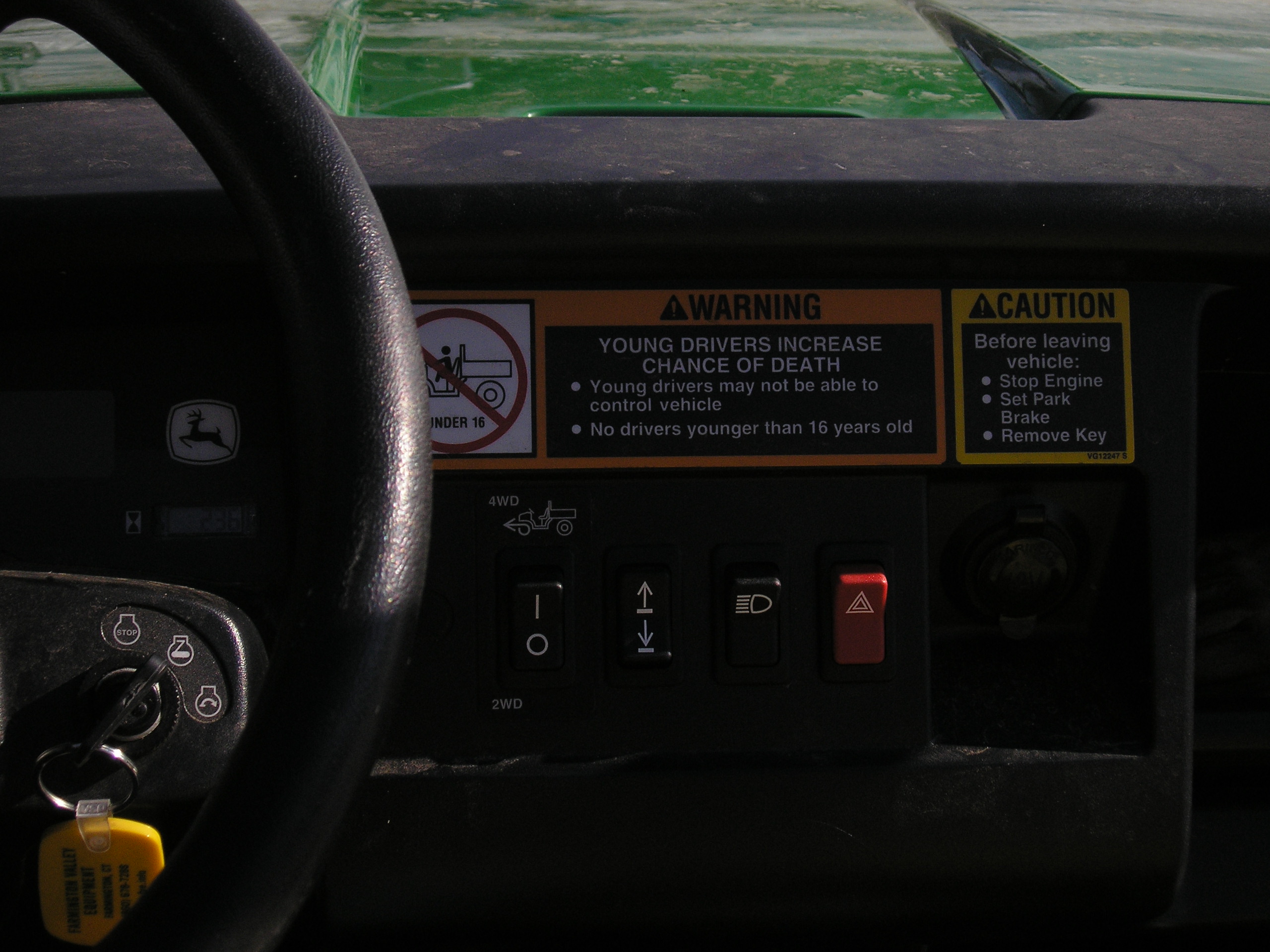

Last week was my first opportunity to plow snow after dark with the HPX. (This machine is awesome for plowing-just right for our property. I plan to post a separate report, but it will be better if accompanied by photos, which I don't have yet.)
When the dealer installed the plow, they put the plow up/down switch in the dash, between the 4wd switch and the headlights. I can't find it in the dark, and need to put some kind of light on the dash so I can tell the switches apart when I'm wearing gloves. Any suggestions for lighting the switch panel? I've thought of a cigarette lighter map light, but haven't gone looking for one yet, and don't want anything to bright. I plan to install a cab, so maybe a light shining down from the roof would work.
I have considered just a small LED above the switch like Donegal (apologies if I've mispelled your username) used on his XUV, but I'm not ready to drill a hole until I resolve the cab thing.

It is an awkward location. Not so bad after using it a while when you can see it. Deere conveniently provides a spot right at the base of the park brake lever for it, so your hand can easily find it in the dark by following the lever. It seems to make sense, but with warm gloves on, didn't seem like it was worth the trouble to move the switch. I also thought about finding a lighted switch, but that won't me find the hazard light switch, etc. unless I change those out.
Thanks for the paddle switch suggestion, Iron Horse. Ultimately, I need (actually, badly want) to add power angle to the v-blade, so for that I'm planning a control with 3 lighted switches for left angle, up/down, right angle. That isn't going to happen this winter, though, and maybe not before next winter. Too many other projects.
Prosum, it might be as simple as a small light of appropriate brightness that clamps to the OPS. I used to fly an airplane where the instrument lighting came fom the rear bulkhead, and thought of rigging something to the rear cross member of the OPS.

Thank you both (Piloon and 737pilot) for those suggestions. I'll definitely check out the battery light for the few times I'll likely need (pretty much Dec-early Feb. I expect).
I have been reluctant to add holes to the dash for this, but, after consideration, Deere hasn't produced a very attractive dash anyway. It's uglified by the safety warnings!

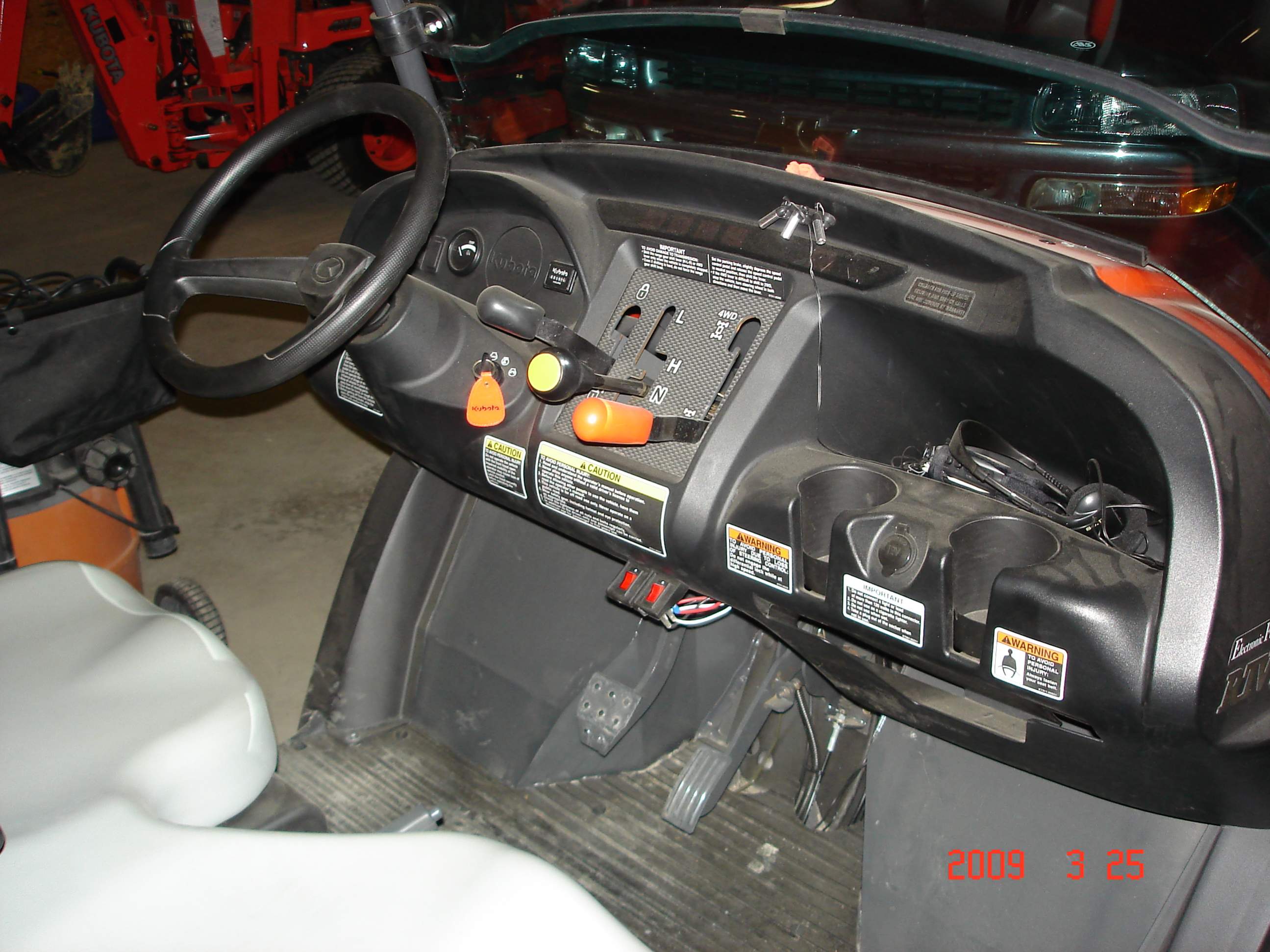

We own a briesters chuckwagon and it is a bare bones UTV. no lights on the very sparse dash. Here is what I used to light switches and levers.
FastCycleParts.com - Kuryakyn L.E.D License Plate Bolt Lights I used one each side of the steering wheel. They are not that bright as to destroy night vision but gently illuminate the dash
Jeff

I had the same issue with my RTV, couldn't see any controls when plowing...Here's what I found in the "coffee can car" section of the parts store..The lights aim, so you can light up whatever you want..not too bright either..LED
You're right, the dashes on these things should have some kind of back lighting.
