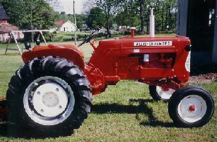

Here is a picture after I painted her in 1996. She has been in numerous parades and tractor caravans, the longest one was 232 miles. I have also used the D14 to plow snow, disc, bush hog, pull hay rides, pull back at tractor pulls, grade driveway, dig post holes and skid logs.

Gene,
Isn't that the wrong color for a 14?
Although I like Persian #2 better myself.
