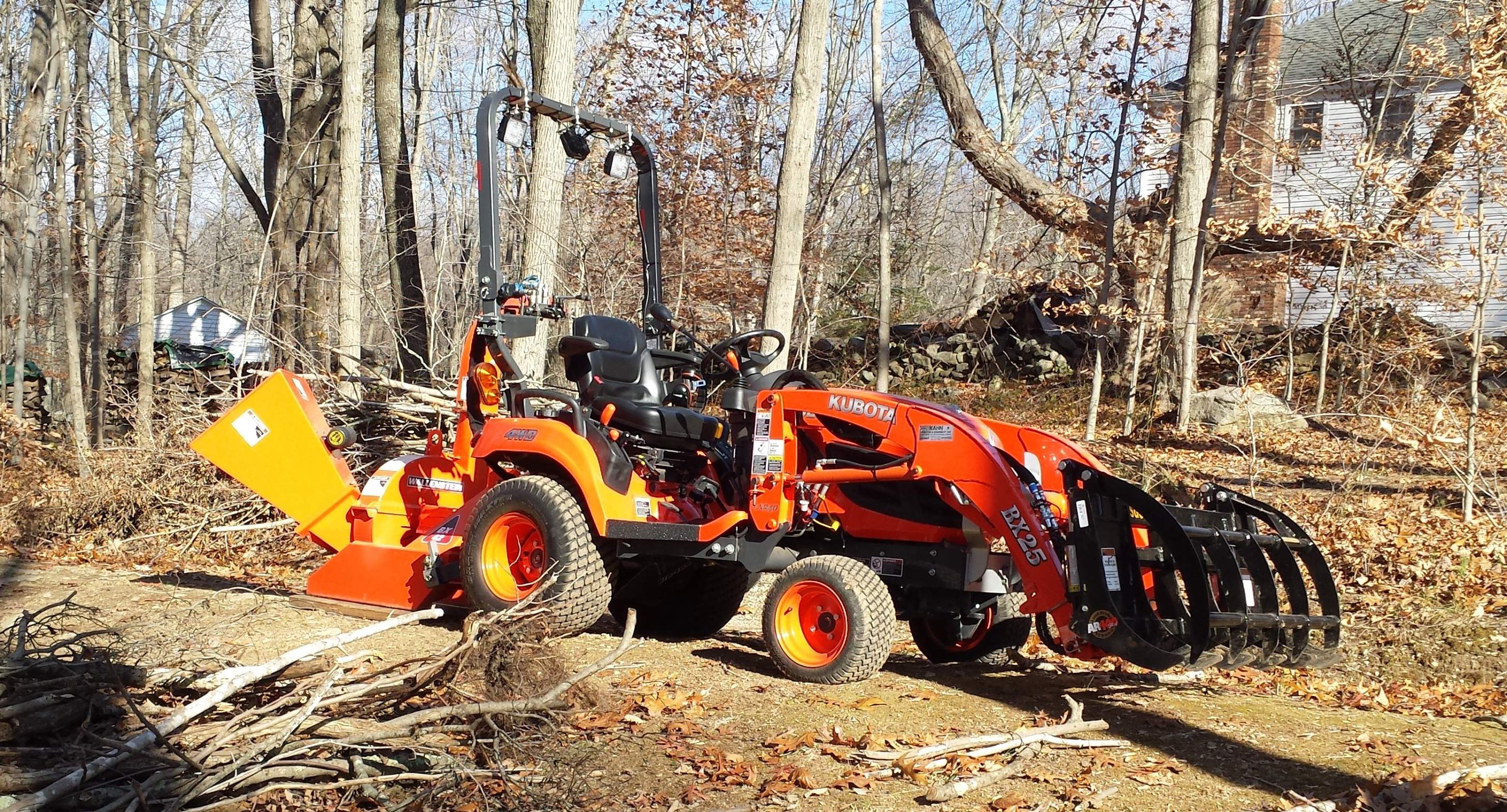

I bought one about this time last year. There's a whole long thread or two on here about the new LP grapple for the Kubota BX FEL quick hitch. That price is very good if it includes the grapple, quick hitch (you'll need to be able to switch from FEL to grapple and back quickly), and the third function hydraulics to operate it. And if that includes installation, it's an even better price. I love mine for moving loose brush and logs. I believe it's considered a root grapple but I don't know if I'd be comfortable working it hard in the dirt to remove small roots. Too many large rocks and roots around me to do that with this grapple, but otherwise, it adds a lot of utility to an already flexible small machine.

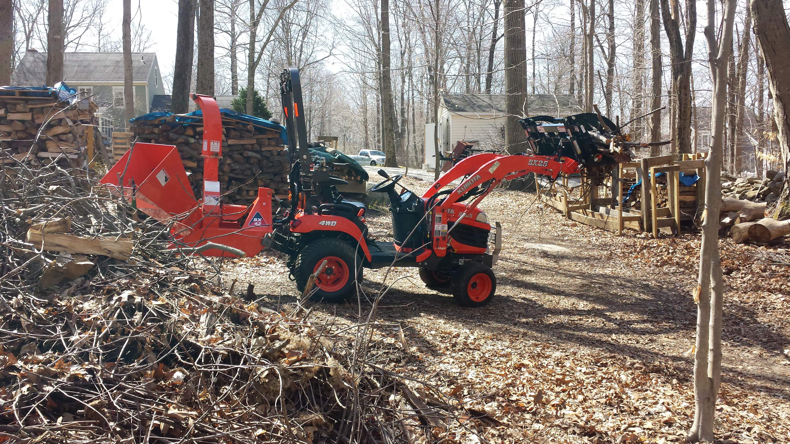

When I was shopping for a grapple, I considered the Land Pride. I saw one at my dealer when I picked up my quick attached they ordered for me. I ended up with a WR Long OBG2-48 for my B3200. Mine was almost a grand more for the hydraulics, hoses and grapple. I don't know how I did without it.

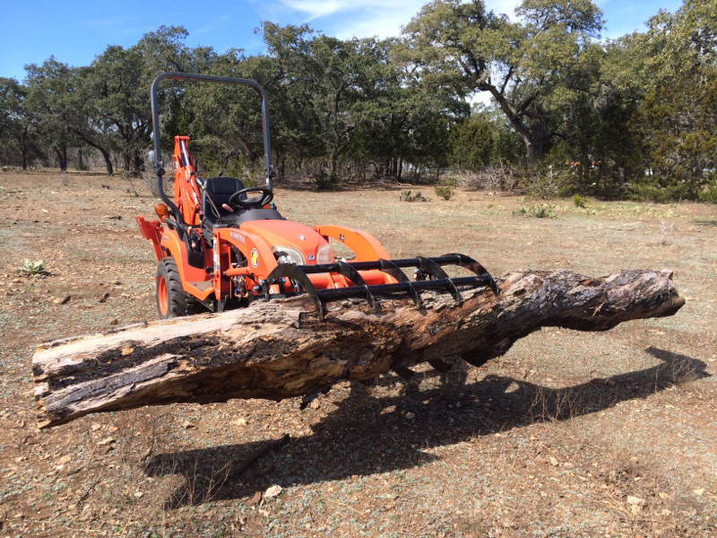

I'll second everything CHDinCT said plus you can move big thing around. It's best to have the QA as using the "pin on" attachment gets cumbersome.
