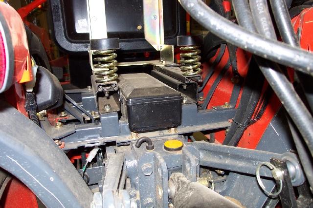

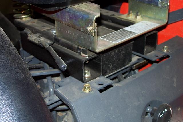

Big Guy,
I'm 6'2", and about 200#, so I'm not as wide, but a little taller than you. I had a problem bumping my knees into the dash on my B7500, and occasionally switching the headlights on/off (depending on which way my knees shifted). I added a 2x2 square tube under the seat rail to raise the seat about 2". Made all the difference in the world.
Here's a view from the rear of my little "seat extension".

   / Any Big Guys Out There with a BX #23
That's cool (aka Kewl depending on your age and coolness). Wouldn't have thought of that.
   / Any Big Guys Out There with a BX #24
Sometime the simplest things make a big difference. I am 6'2" & 240 lbs. My one beef with my tractor was that I needed another inch back on the seat, easily noticed when using the tractor 8-10 hours steady. I just applied your fix to the seat frame and am noticably more comfortable.
I was going to re enginner the seat bottom to move the whole assembly rearward. Now I am glad that I didn't have the time to do that yet.
5 seconds with the crescent wrench, problem solved.
Thanks for your post:
WALT
