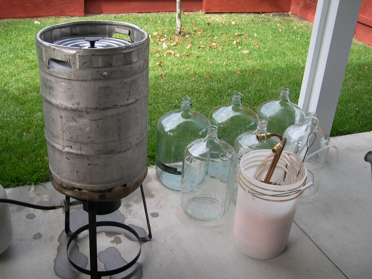

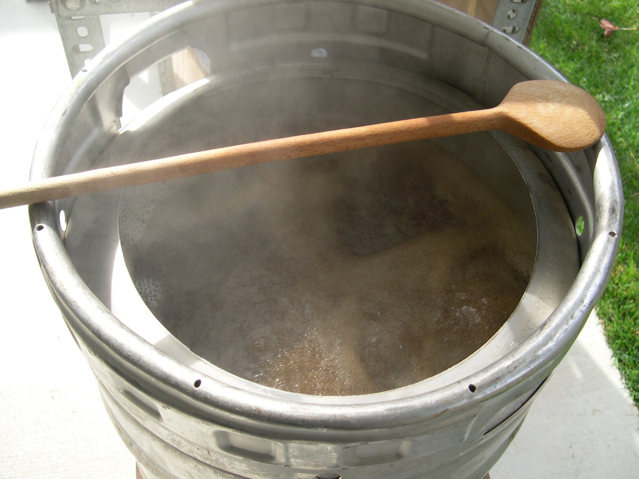

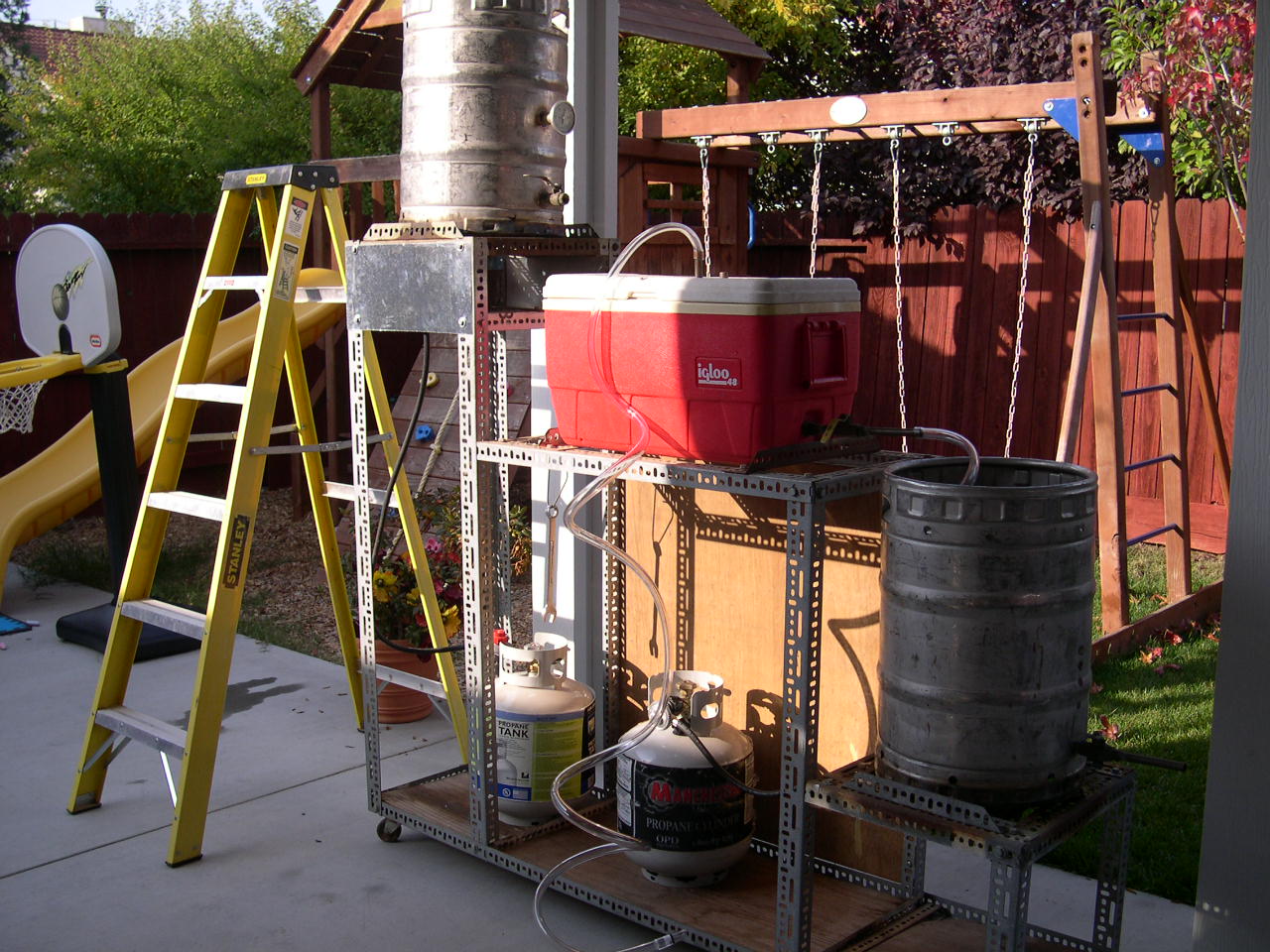

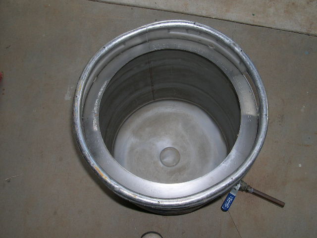

Here are a couple pictures of my boiler, and a friends copycat. Works great.
I have used a chiller for years, especially with 10gal batches; they'd take a week to cool otherwise. I found the trick was to start with clean copper, and keep it clean. I was it down the second it comes out of the wort, and store it in a clean box. As far as sanitation, I worry more about keeping it generally clean. It is going in to boiling liquid... DSCN0001.JPGDSCN0003.JPGDSCN0004.JPGImg2003-11-08 154749.JPG
