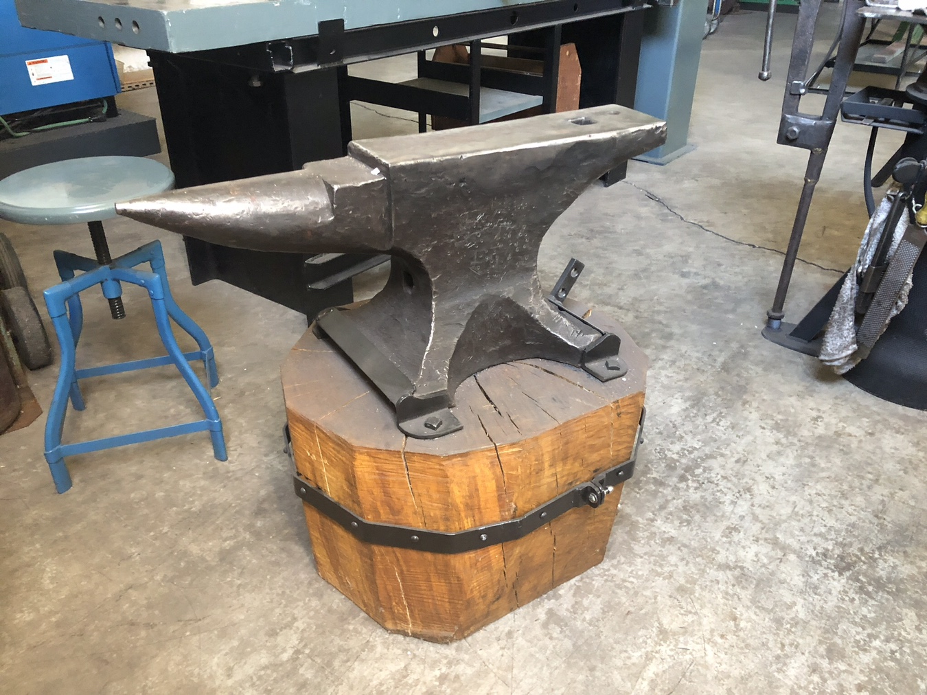

An anvil is a wonderful thing. But, it's not the tool, it's the operator.
You can use a piece of heavy I beam, or a piece of railroad track.
Just about any piece of heavy scrap metal can be used to forge, or shape metal.

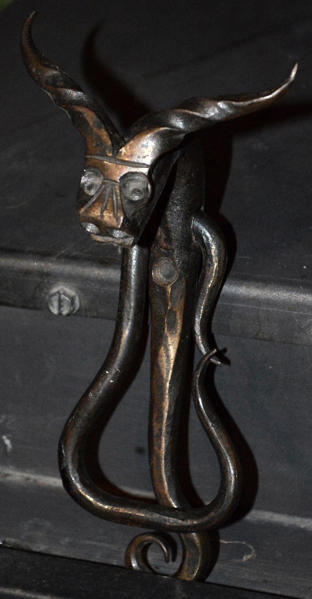

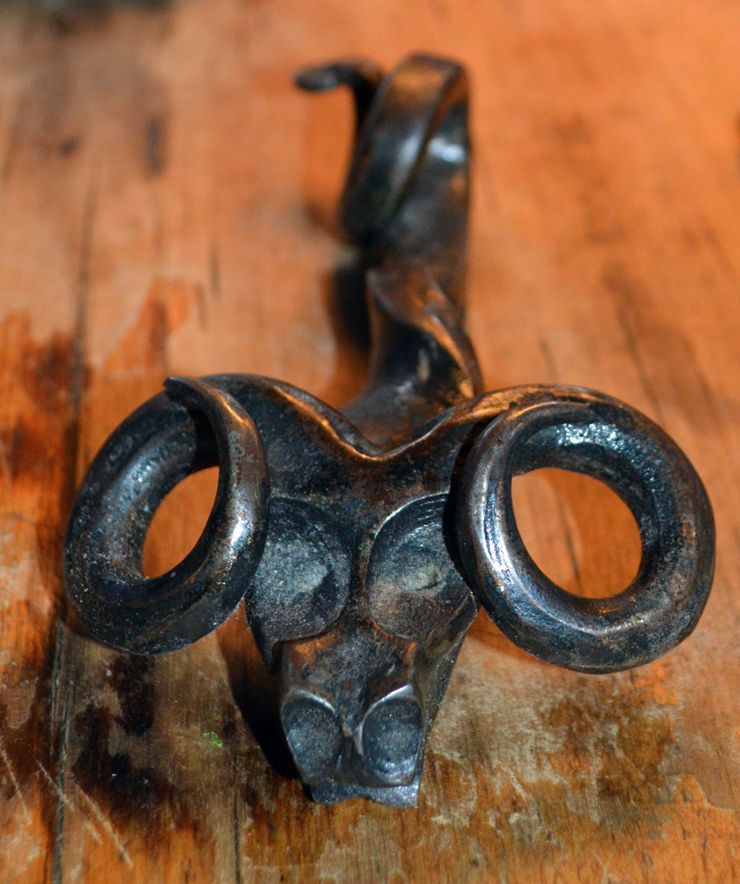

For a time I did demos and craft shows back in the 1980's. Here is my traveling setup - Everything was a 100lb or less so I could lit it into my pickup! - That is a brakedrum forge.

tcreeley: I really like that door knocker

My grandfather's blacksmith shop was still on the farm where I was born. I spent countless hours heating steel in the forge and beating it out on the anvil just for the **** of it. Sure wish I had paid better attention to what he told me about tempering. What I did learn was the weight and mounting of anvil has a tremendous effect on what happens when something on it is struck. The simplest way I know of to demonstrate how immovability effect's hammer blows is driving nails in a board. Lay a 2x4 across sawhorses and drive a large nail into it. Now do the same while holding another claw hammer against bottom of board,then repeat while holding a 5 pound sledge under board. The difference is quite similar to a small anvil sitting on the tailgate of your truck vs a Bois-D- Arc stump. Less pronounced but non the less true is a 250 Lb anvil on tail gate vs stump. Point is bigger is better(although 18"-24" rail track will surfice) and don't sit it on the workbench. If a rounded drain plug deserve's 800 posts :confused3:surly this thread deserve's a few additional posts regarding diy forges and anvils.
