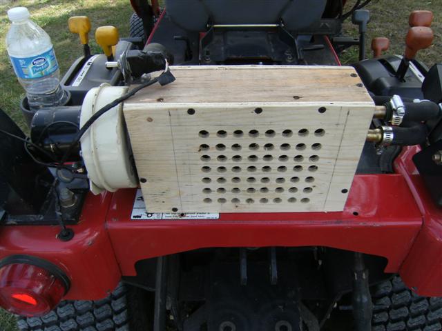

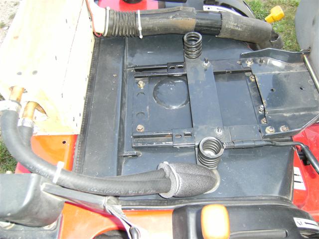

I've changed the anti freeze in mine twice now and the last time I just flushed it with water as well.There was no corosion or scale build up anywhere that I could see.I have a permanent mounted heater behind the seat for winter use.[ I just made it permanent this fall] it was getting to be a pain to drain and fill the system every spring and fall. .I do use the Diesel type long life Anti freeze as well. The tractor only has 1745 hrs and slowly climbing :laughing: Larry
