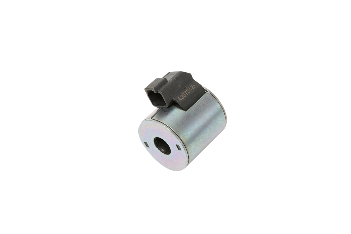

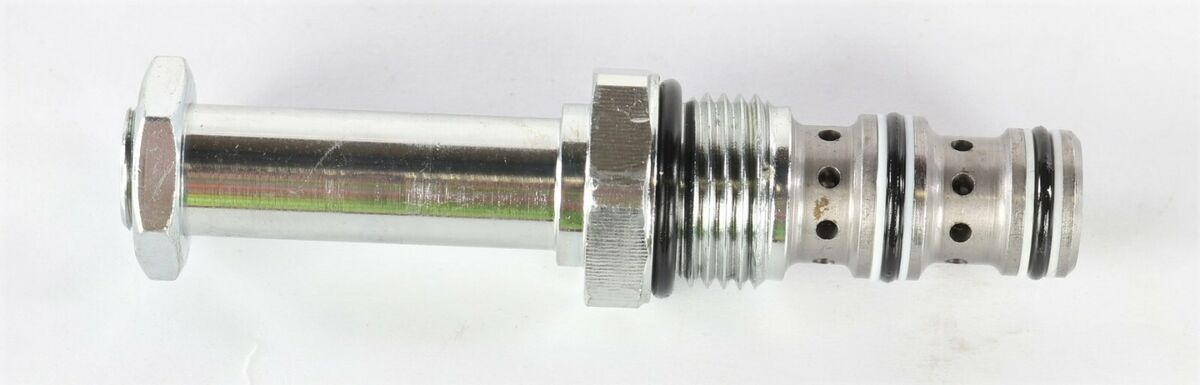

Can't quite tell from the picture but usually, you can remove the solenoid without pulling the cartridge valve out.
As an example, I pulled some random pictures on the internet. This is the cartridge valve:
This is the solenoid that slides over that shaft on the upper picture:
