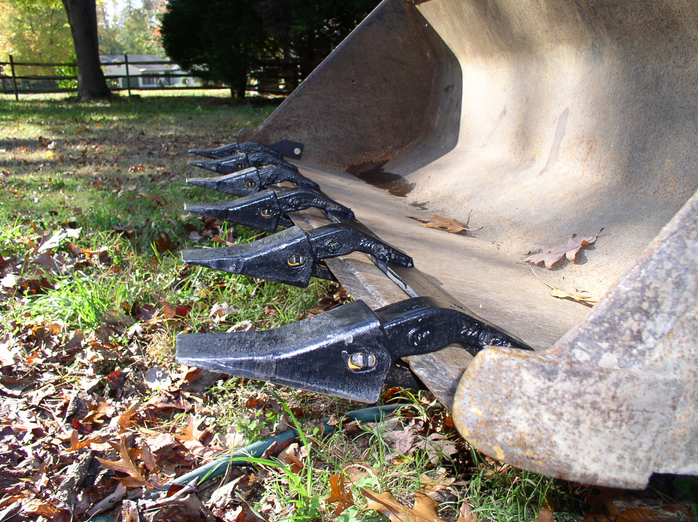

I thought I'd post some pics of my bolt on tooth bar you guys help me build.

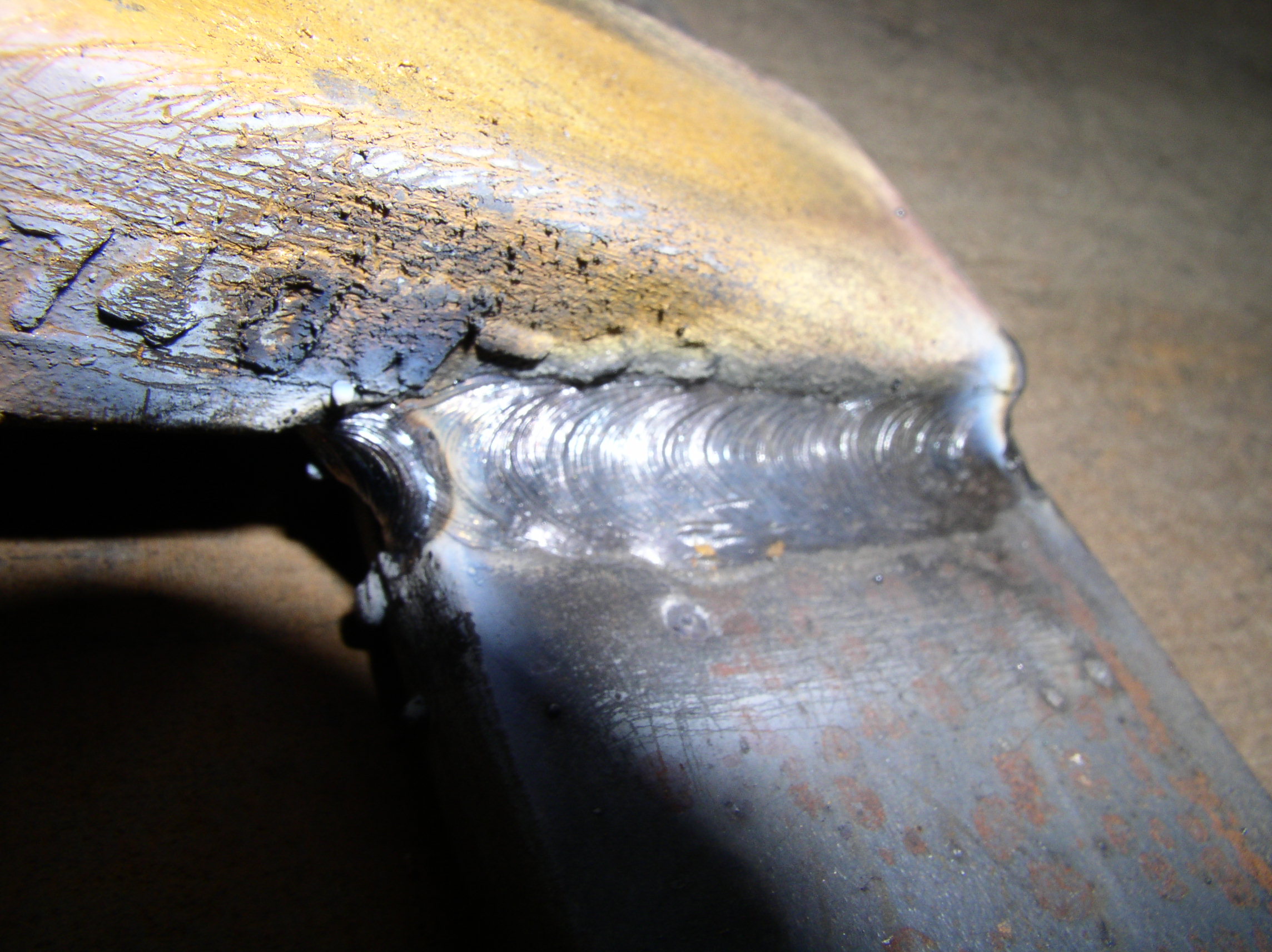

72" Woods FEL bucket 6 teeth. I thought based on my usage 6 teeth would work well for me. I've been using it for 3 wks now and works great. I can even get more firewood in the bucket; may never remove it. Bought the teeth on Ebay $5 each and the shanks as well from another Ebayer 6 for $58. Had a piece of 3/8 x 2" bar or I would have used 1/2 x 3" at least. Here are some pics. Welded with 1/8" E6013 DC+

Do a Ebay search for "Bucket teeth" and you will find both guys. The teeth and shanks are cast steel size 23 series.

I checked them out and was wondering. A tooth is 4.99. the mounts are 53.99 for six or about 9.00 each. The set of tooth mount and pin are 24.95. I emailed and asked what the difference between buying them seperatly and as the set is and they responded the set contains the pin.
Is the roll pin worth 11.00???????? I don't understand this.
   / Another toothbar
Koss, I purchased the teeth and pins from Ebayer "Piedmonttractor" for $4.99. Piedmont wants $15.50 for the shanks and $2.50 for the pins so I purchased the shanks from Ebayer "Constructon_parts" at 6 for $53. Shipping at that time was $8.10 and I now notice it is $15. Hopes this clears up the conusion.

Nice looking tooth bar. I'm jealous. Has anyone ever found these shanks that will fit over the bolt on edge of the HD bucket? I had looked a few months ago and was not able to find them.
   / Another toothbar
Fabco make shanks for a bolt on edge I think. Check their website. I believe these shanks pictured will work as well. That is why I spaced the holder bar so far rearward. My new bucket will have a bolt on edge so the V tip it will be lower by 1/2 " an forward by 1". Or see if the guy on Ebay will sell just one.
