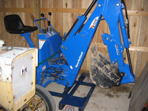

Here is a picture of the Bro-Tek installed on my NH757C. I didn't have the welding skills and I thought I might want to remove it. It is a very tight fit and I think will be strong enough for my uses. Now that I have it on, I can't think of why I might remove it. It hasn't been in the way.
Not sure you can go wrong with either style.

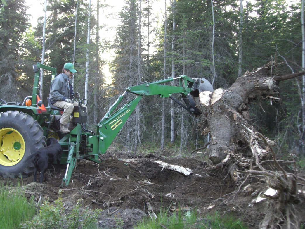

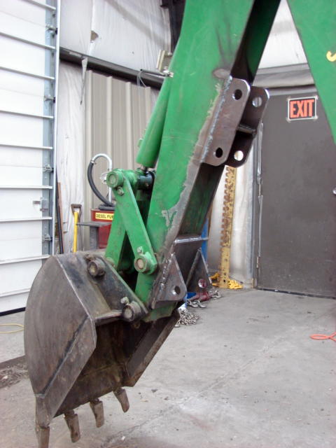

I welded mine. I use the hoe with the thumb either "parked" or completely removed. It's fairly large 9'x24" and when the bucket is closed and the thumb is parked on the hoe, the mound of dirt in the bucket will compress against the thumb.
So, if I know that I gonna be just diggin' dirt and not pullin', pickin' or rippin' stuff up; I leave the thumb completely off.
It has 2 working positions and even when it's parked on really big stumps, etc. it still will grab and hold things with the bucket curled.
IMO, I don't think I'd seriously consider a bolted on attachment with the working forces that the 8A hoe generates --- curl function --- "excess 6,000 lbs" from JD owner's manual.
I don't know what the Wood's will crank out but it's likely not that far off the 8A.
