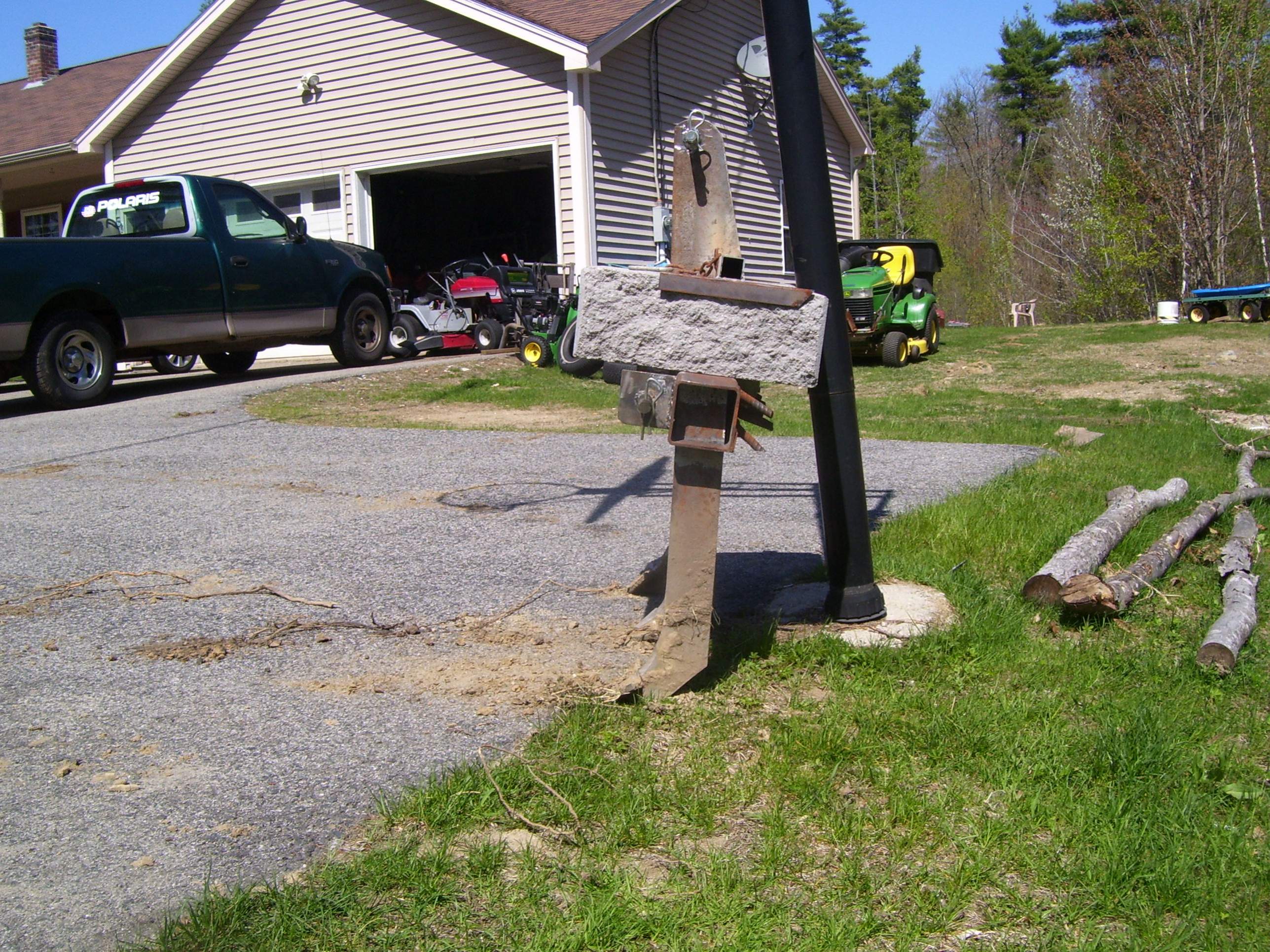

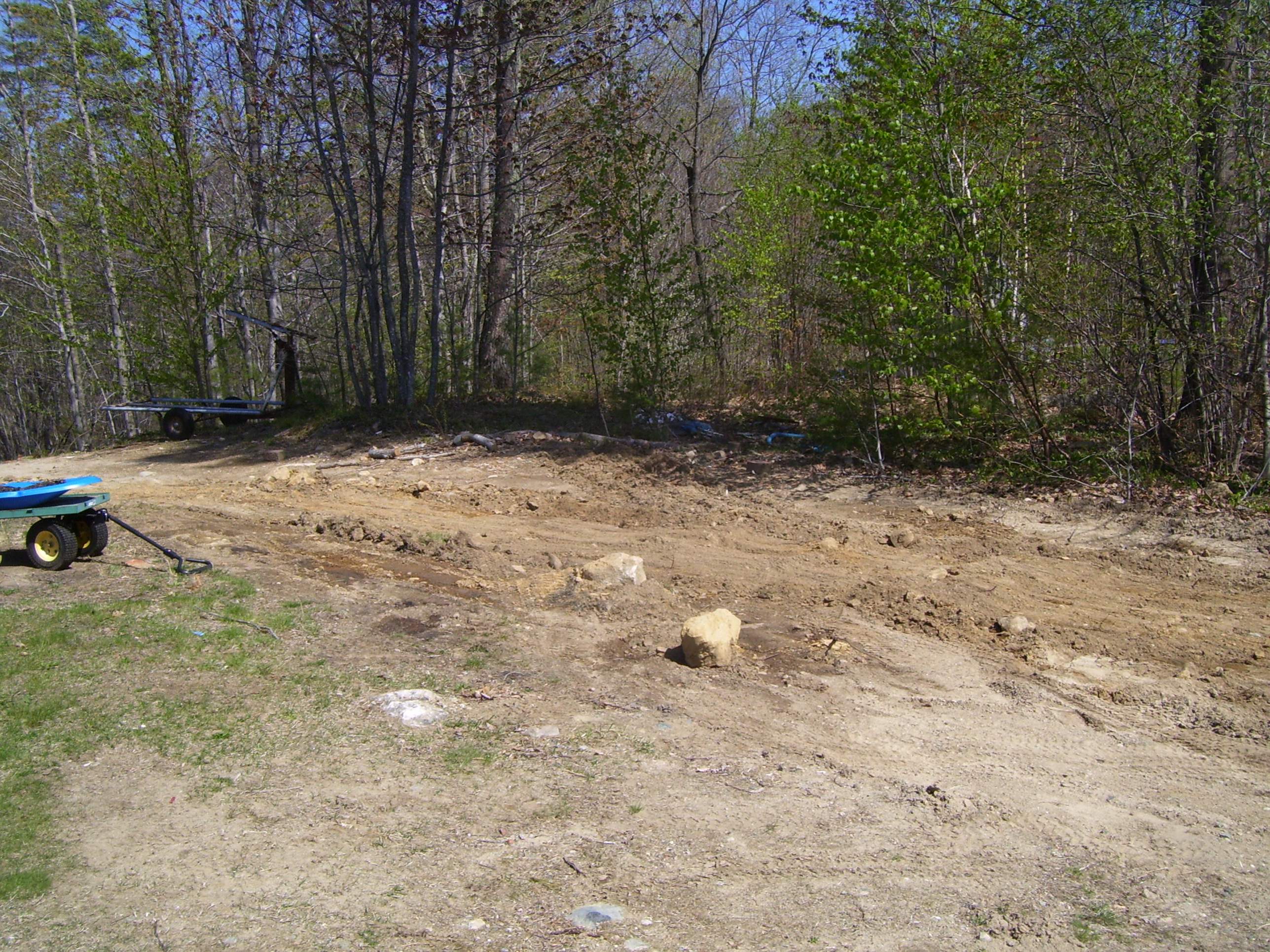

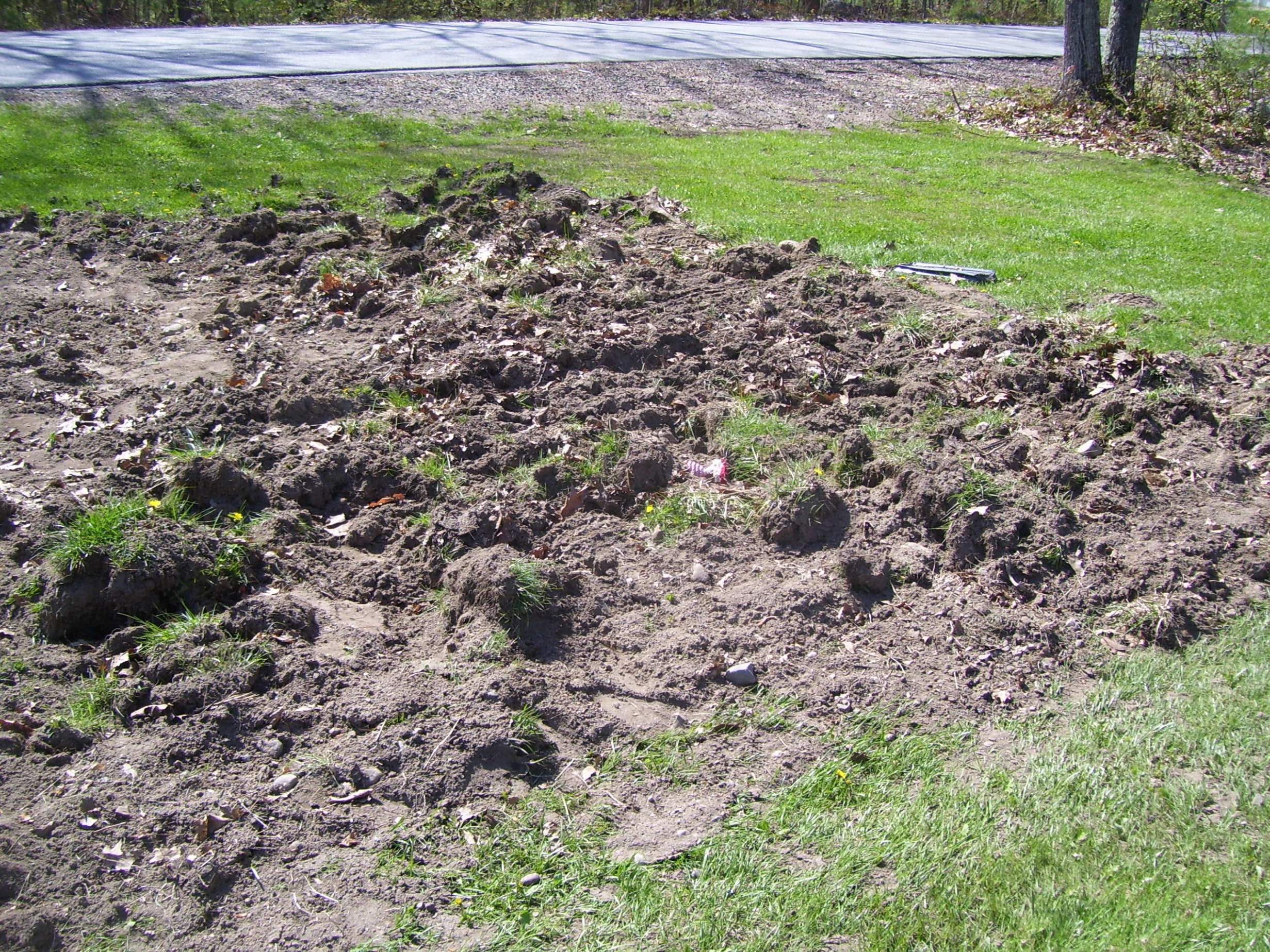

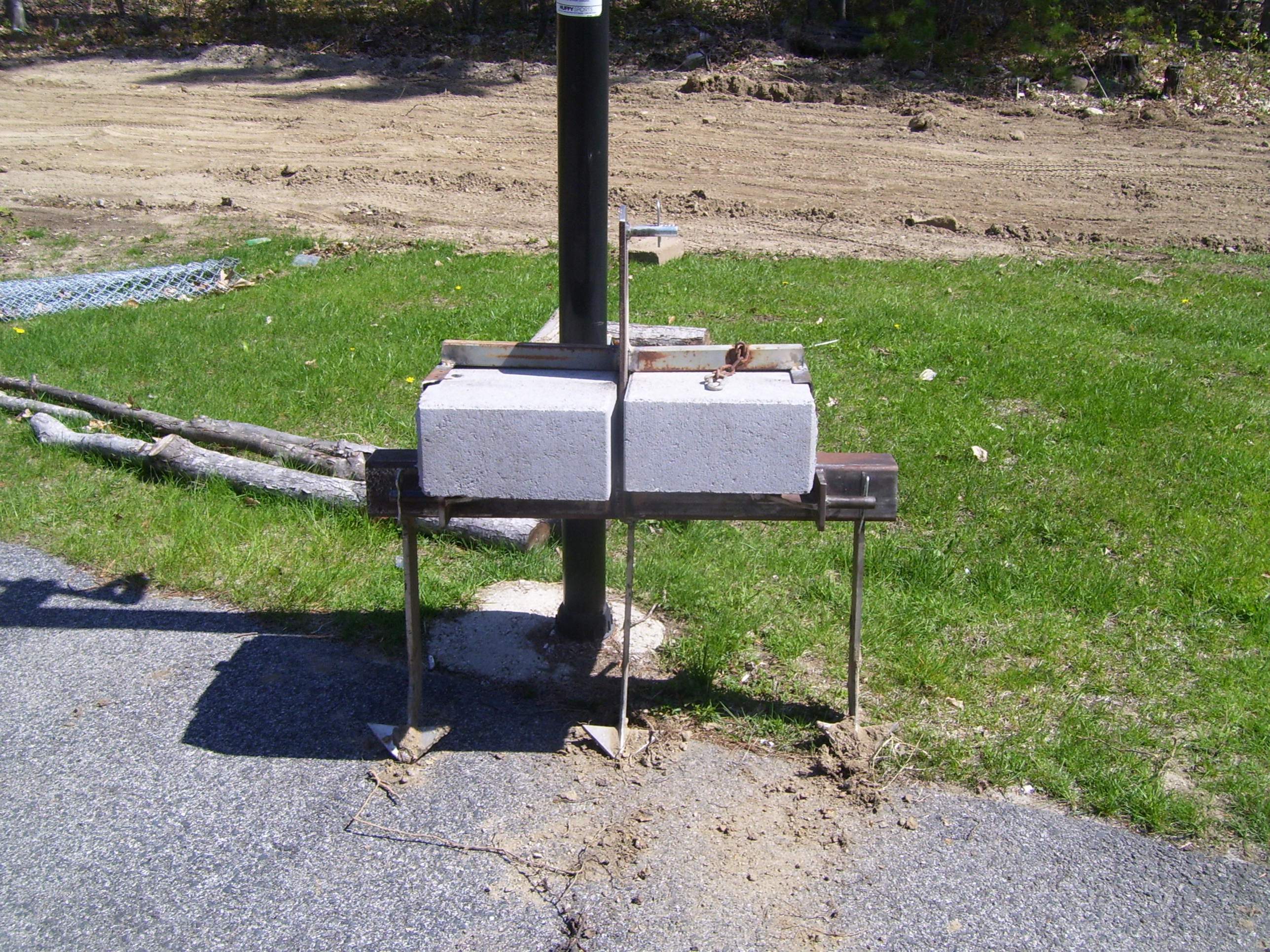

Up here in Maine this is what I use. I built this one myself out of 1/2 inch plate and 4x4 piece of steel. I can haul out a rock that is 3x3 or break up clay/rubble mix in a pass or two. I do all of this with a 2wd 35hp Kubota with turf tires.
