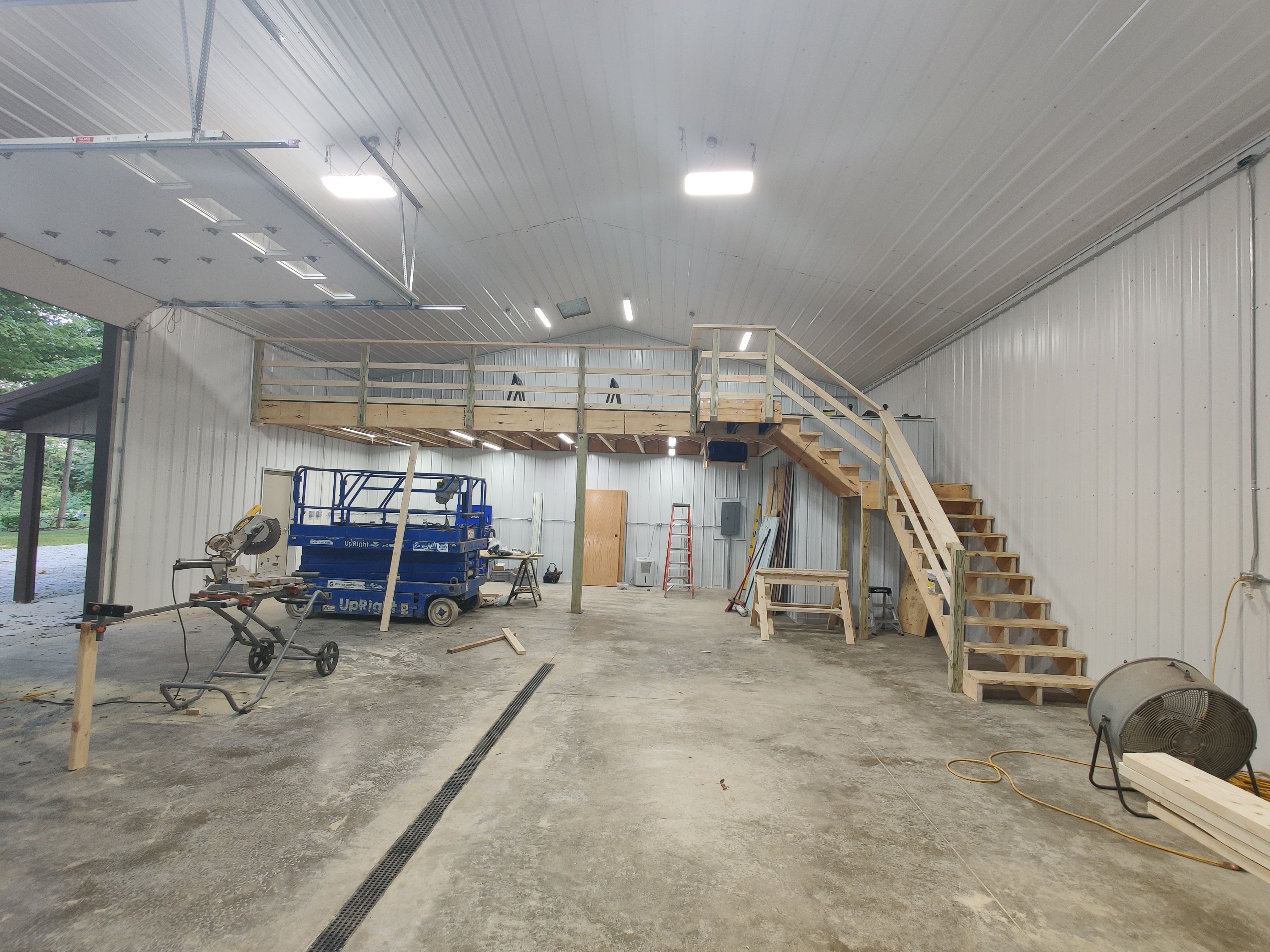

I have a few questions in regards to switching over my shop lights to LED and being able to see lol. My shop is 40x70 with 12' to the trusses with pre existing lights 16 total. They are situated in two rows, every 4th truss. I'm assuming the height of the lights/fixture makes a difference on what style. Everything is already wired so it won't be hard at all and I'm trying to decide or figure out my lighting options. I'm not wanting to put up gold fixtures but I also don't want the cheapest either. I just don't have any idea when it comes to this besides the fact that I want plenty of light. I will also put in a couple extra around the main bench/work area. For those that have did went to LED, please share your experience with different light set ups and what you would do differently if you started over. Also I'm just starting to figure this out so any links or pictures would greatly help. Thanks
1. High loft vs rectangular vs strips---would rather go high loft or rectangular
2. Is a high loft what is called a UFO style
2. Best to hang or fix to the truss
3. When it comes to lumens or watts, what should I be looking at or for
Any other suggestions are welcomed.

Friend of mine has a shop about the size of yours, maybe 5' shorter in length. He has (12) LED rectangular fixtures (24-30" in length). Trusses are about same height as yours as well. Lights the interior WAY better than incandescents/flourescents. And no heat generated either.
He hung his from the trusses. They are high enough where you won't bump them, unless you're trying to...
Don't have the specs on lumens or equivalent wattage, but they were significant. He bought them on line.

Here in Australia in my 23 x 40 foot shed I put up four of these from Philips, and they do me well. I hang them from the trusses, but they can be mounted in different ways. I don't recall what beam width I chose, our four covers almost all of the floor. You'd obviously need more.
I've linked to the US website, where you can see they come in a range of lumens, colour temperatures and beam widths.

I have a 40x40 section of my shop lit with the UFO style 150w 19,500k versions from Adiding. I used 8 lights in a grid pattern (didn't put a light above the garage door).
Even with a 16.5" ceiling it is fantastic and very bright, i could have probably gotten by with less but I wanted it like working outside.

I simply converted my 8 existing 8 foot fixtures into non ballast tandem led fixtures with a retrofit kit. The kit contained the tombstones and center plate. Than i swapped out the High Output 110 watt lamps for 5,000k led lamps. Super bright in my 30x40 shop with 12 foot height.
