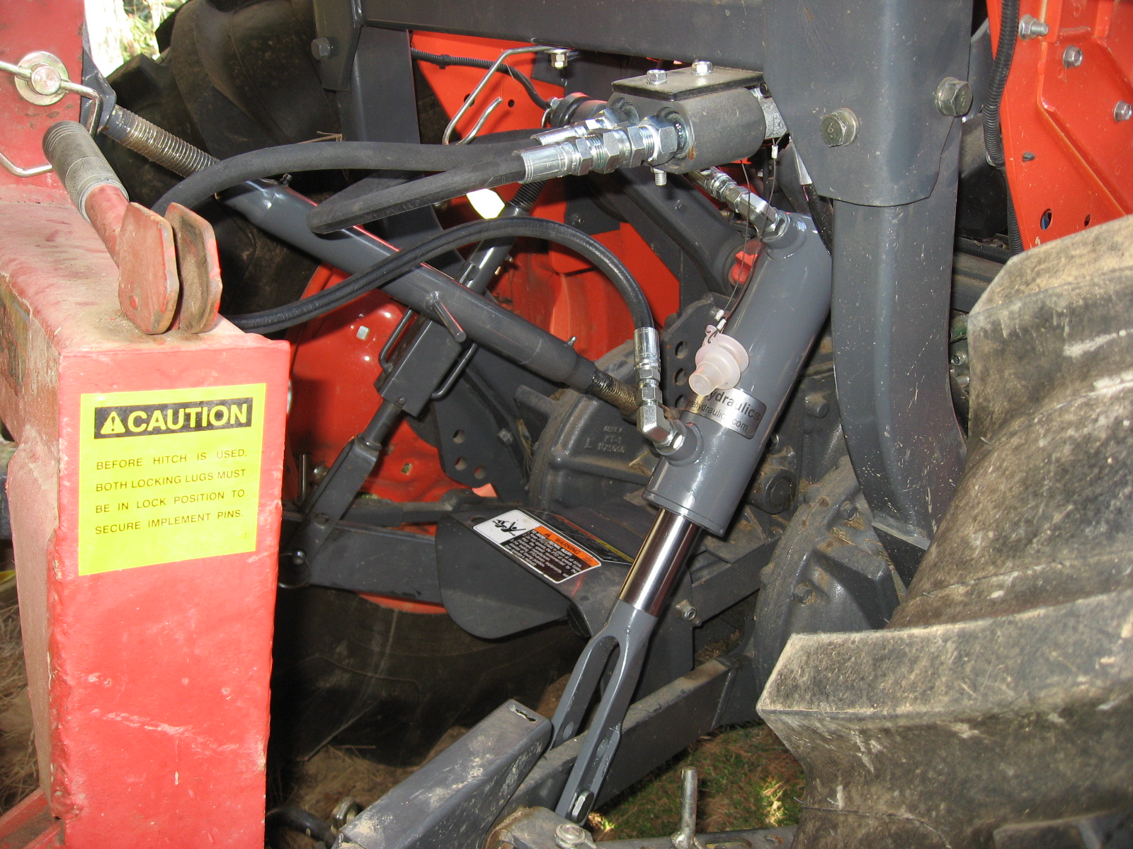

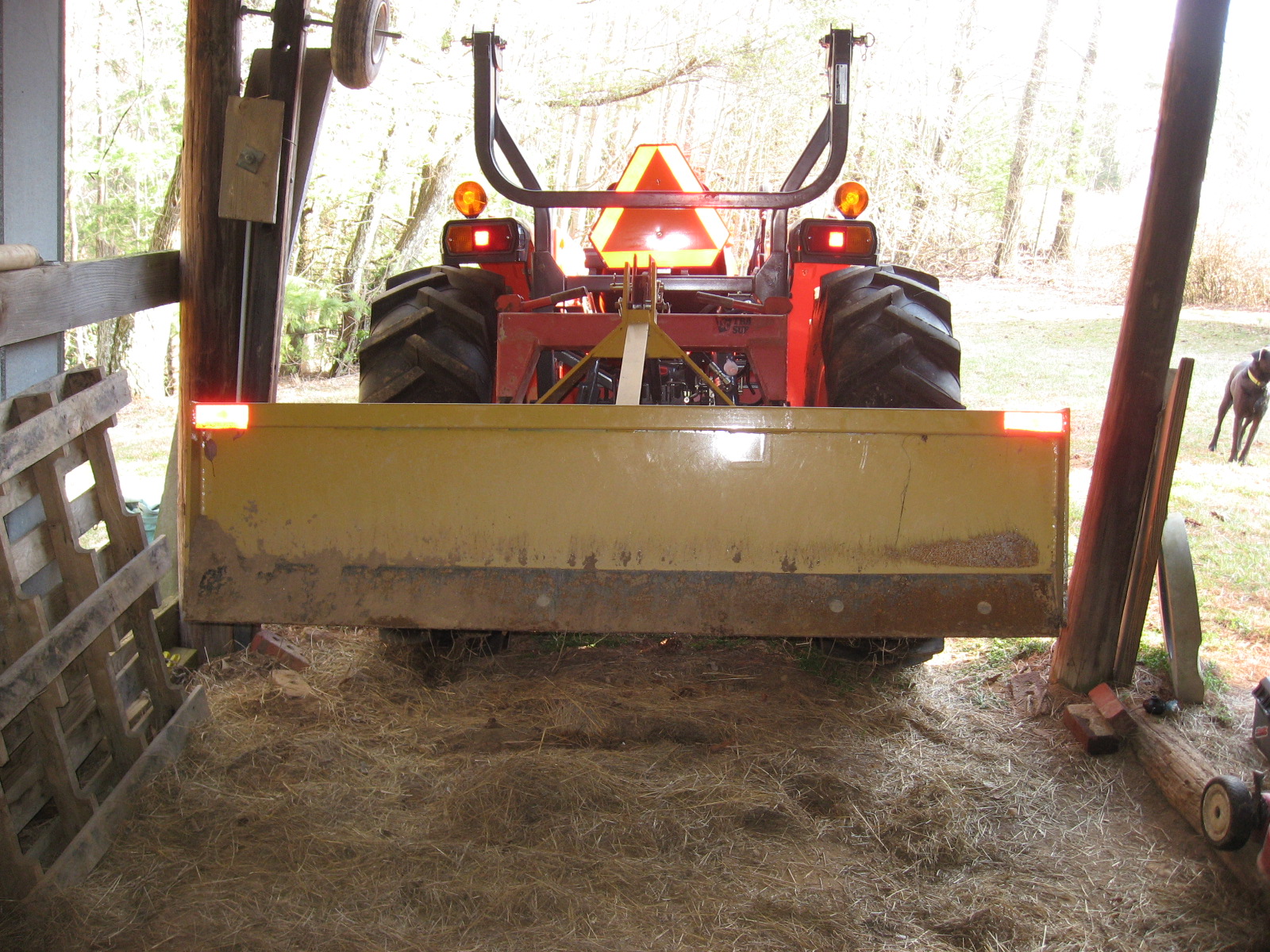

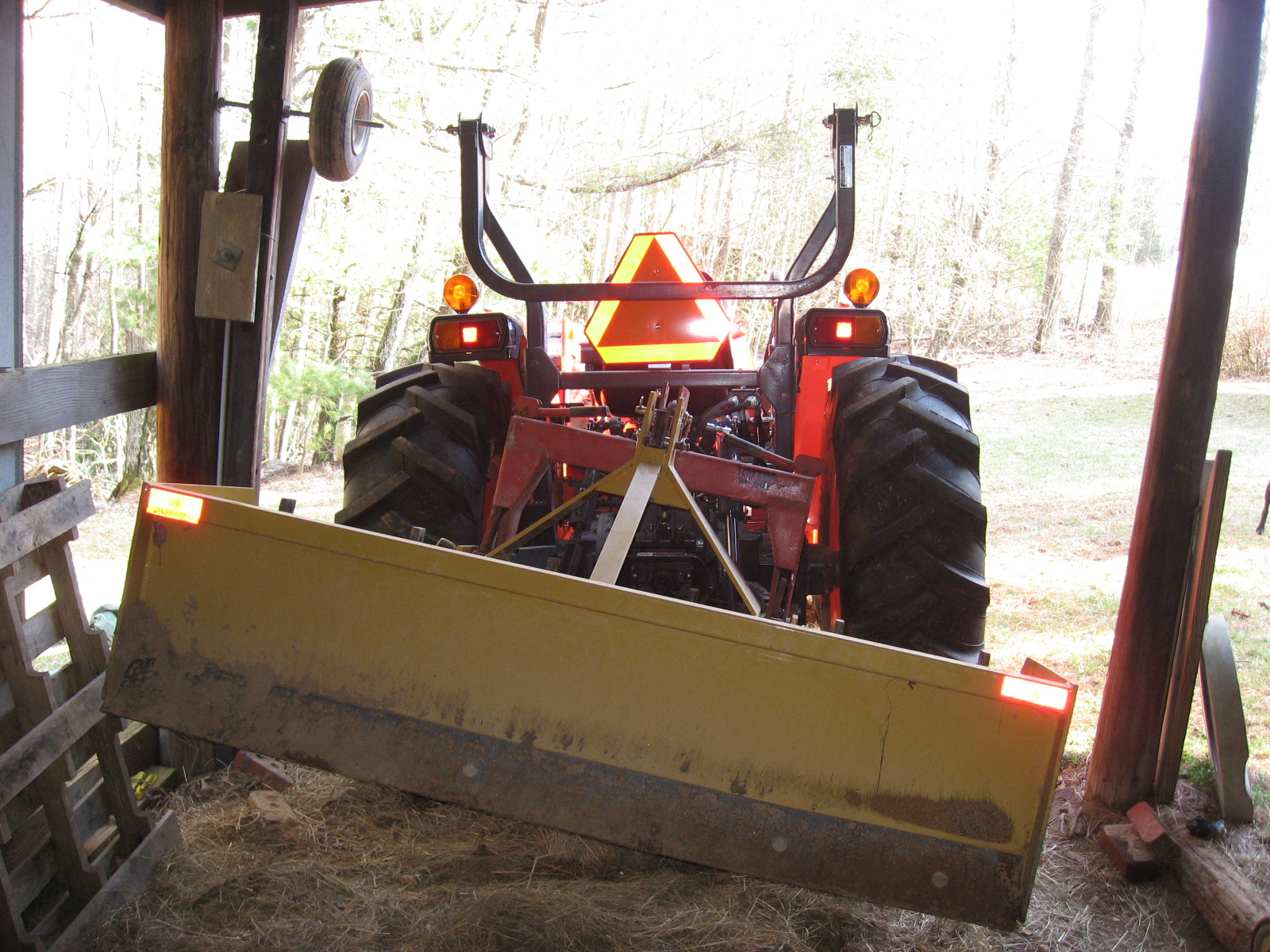

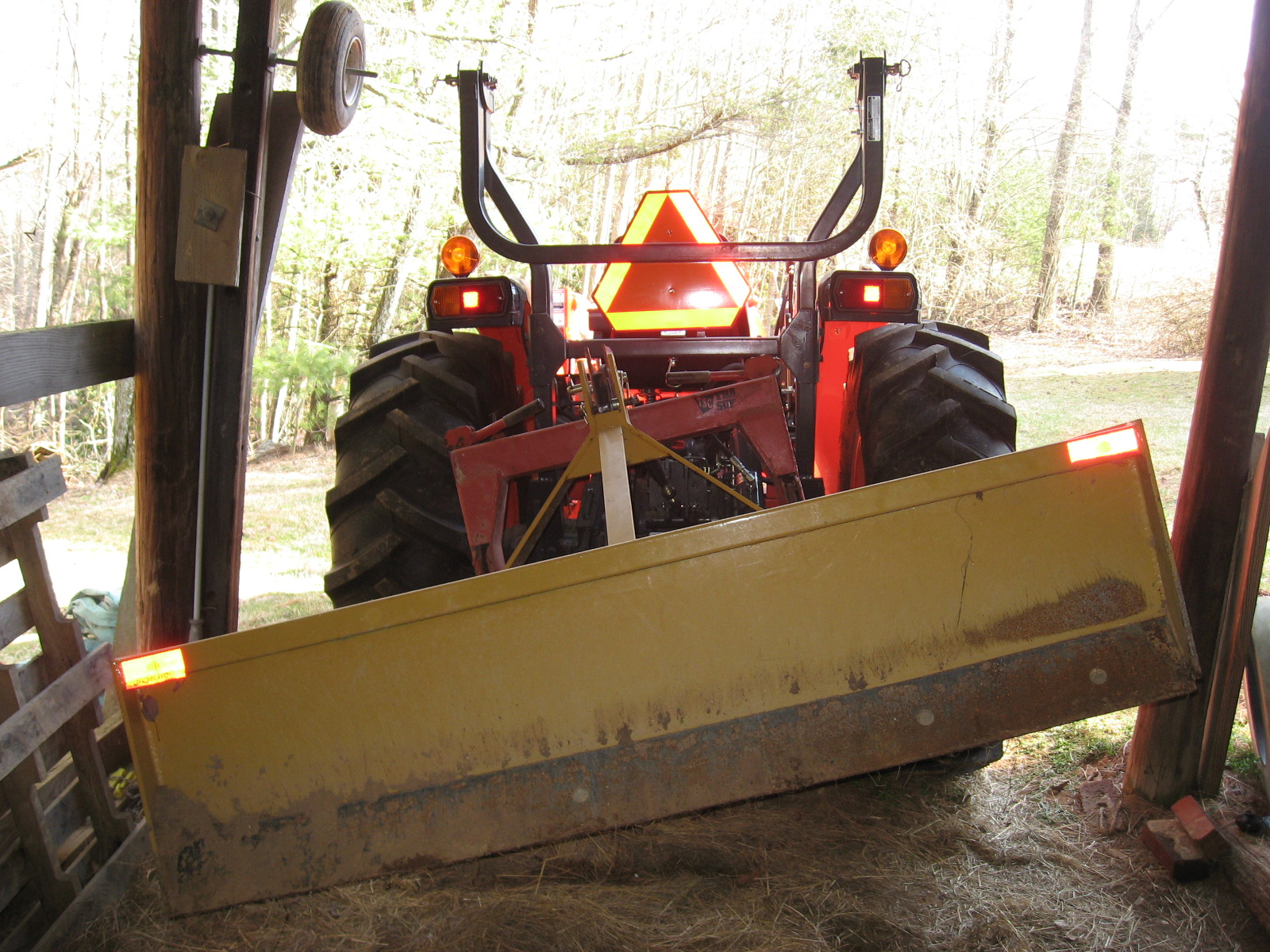

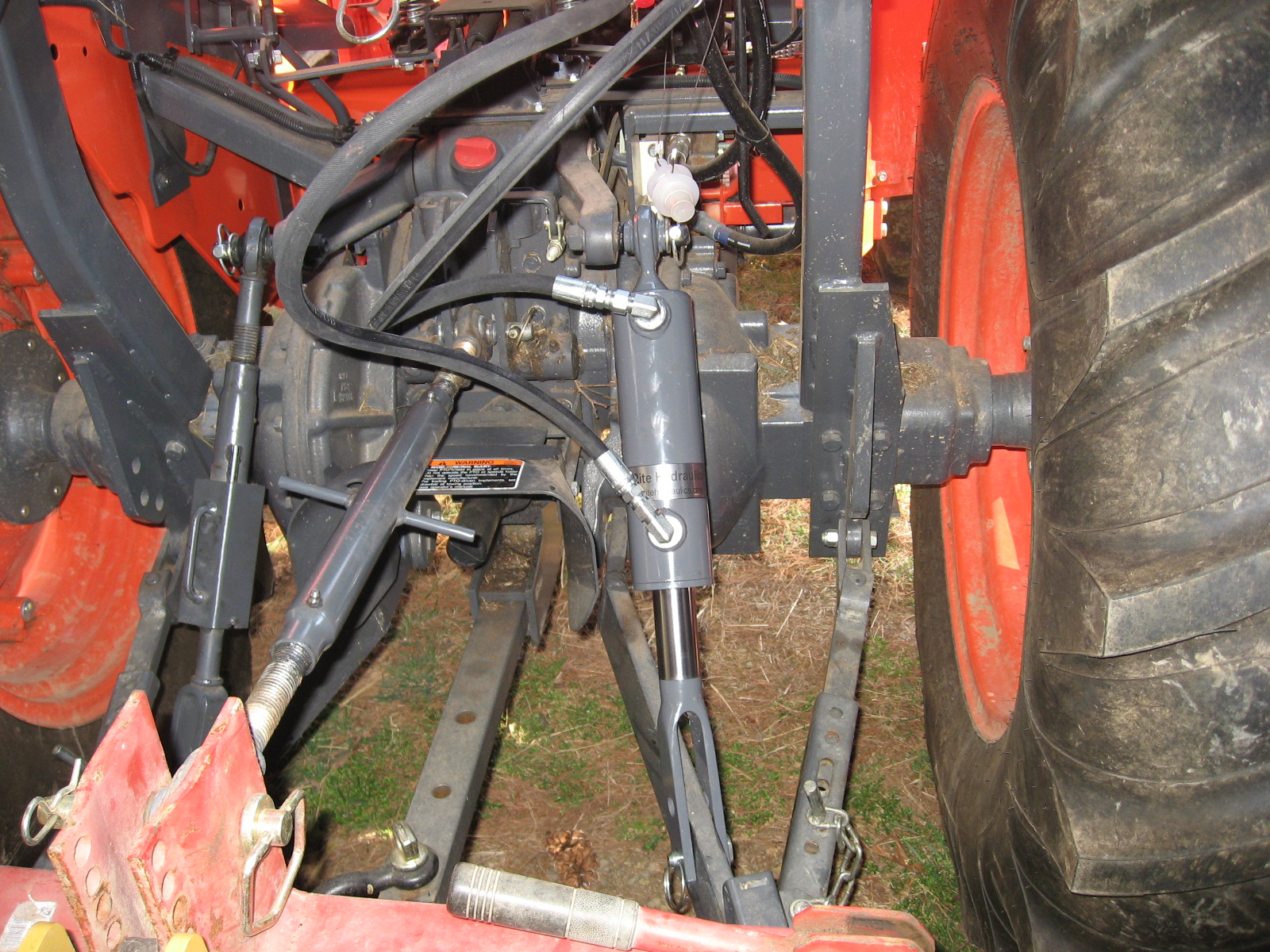

I use my box blade for a good bit of dirt work and I always thought it was a hassle to have to adjust the side link on the 3pt to get the angle I wanted so I've been looking at a hydraulic side link to make chore a bit easier. I have a single rear remote already. After reading posts on this site about Top & Tilt, I Contacted Brian by e-mail at Fitrite and told him the model tractor I have and what I wanted. He didn't need any measurements as he was familiar with my tractor model. The hydraulic cylinder was well packed in Styrofoam sheeting and had very good fit and finish.
I took about 15 minutes to install, including moving the adjustable link over to the left side and cleaning things up a bit. It works great.:thumbsup:

Off topic but I've got to ask, what's up with the wheel/tire on the post ?

"Off topic but I've got to ask, what's up with the wheel/tire on the post ?"
That's an old wheel off a yard cart. I put it on that long bolt sticking out of the post just to make it more visible to me backing my tractor into the shed stall until I remember to cut it off with my saws-all.:rolleyes:
